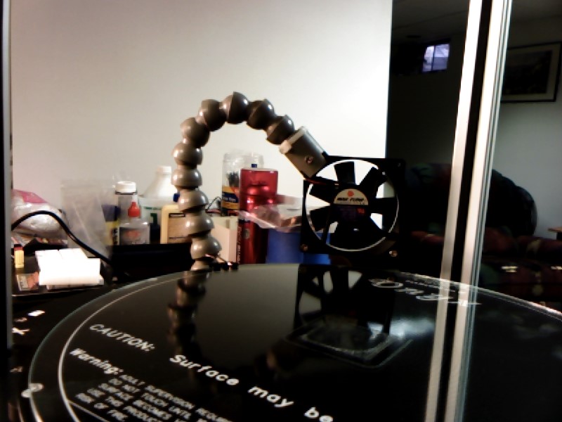

I like the idea of having the fan off the effector for a couple reasons. 1.)I don't want the extra weight etc. on the effector. 2.) I like having the air pointed at the part all the time.
The effector moves around so much it takes the air off areas that need cooling. (tall slim pillars on a fly reel ) I use a fan attached to the platform, only I'm directing it with loc-line. http://forum.seemecnc.com/download/file ... &mode=view" onclick="window.open(this.href);return false; This allows me to set it at whatever level I need, blowing on whatever area I choose. Right now it's a fan out of an old PSU. I'm going to change it though. It cools the bed too much. I'm wiring up a smaller version on a pot. (I'm keeping software control for other purposes) I'm also thinking of piping air off a compressor, like a machine tool set-up. This would allow me to print up custom tips for different applications.

Exactly! Those thin pillars need lots of air to cool them and once an effector mounted fan moves off, it would get nothing.
Loc line is a great idea! I have lots of that in my shop waiting for applications, looks like I found one! I have also used 2 fans with opposing blasts to handle larger parts.
