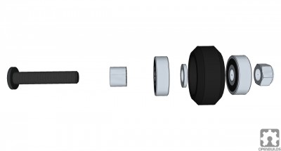

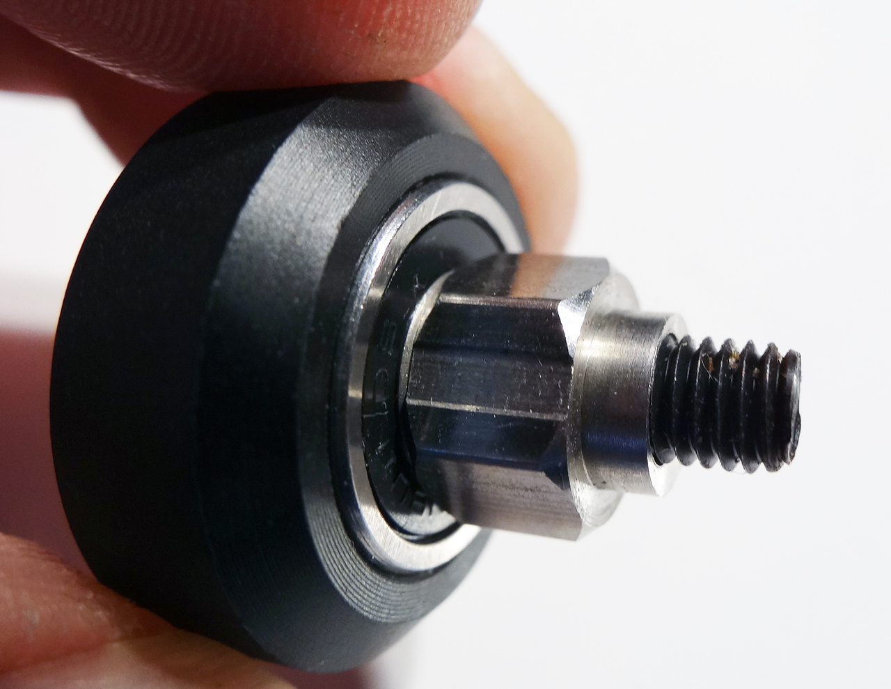

RegB wrote:Anyone else get their OpenBuilds parts and try fitting them together yet ?
I may be having a blonde/senior moment, but I had EXPECTED the eccentrics to fit inside the bearings.
Either they fit inside the truck plates or I have the wrong eccentrics.
My order SAYS 1/4 inch eccentrics, which is what Brian has spec'd in a few places.
6mm is the only alternative on their site.
I got mine and put the bearing in the wheels (had one wheel oversized and slip fit), but haven't played with the eccentrics yet. One thing to note...the 1/4" and 6mm is referring to the length of the eccentric so that you match the correct length spacer.
About the eccentric mounting though...it fits into the trick trucks plate. Check out the 3rd picture on this page and you see one of the holes is larger than the other two for the eccentric to fit into.

Thanks,
Yes, it is clear from the picture - and it is the hole that is for the side that takes only ONE roller.
I know I shouldn't obsess over this, but that cam looks to be awful short to be going into the plate.
Maybe the screw takes all the relevant force(s) and it doesn't matter.

That is correct, the 7mm dia. part of the eccentrics go into the Trick Truck Plate.
Make sure you put 1 of the precision shim washers inside wheel between each bearing.
Note: images from openbuilds web site.
Plus 2 more shim washers on each axle bolt, between standoffs and bearing, to get correct spacing of truck plate.
(The 1/4" standoffs are not tall enough for truck to clear extrusion)

I had been thinking that squeezing the inner races of the bearings together with the same force as required to mount the axle to the plate would be a BAD idea.

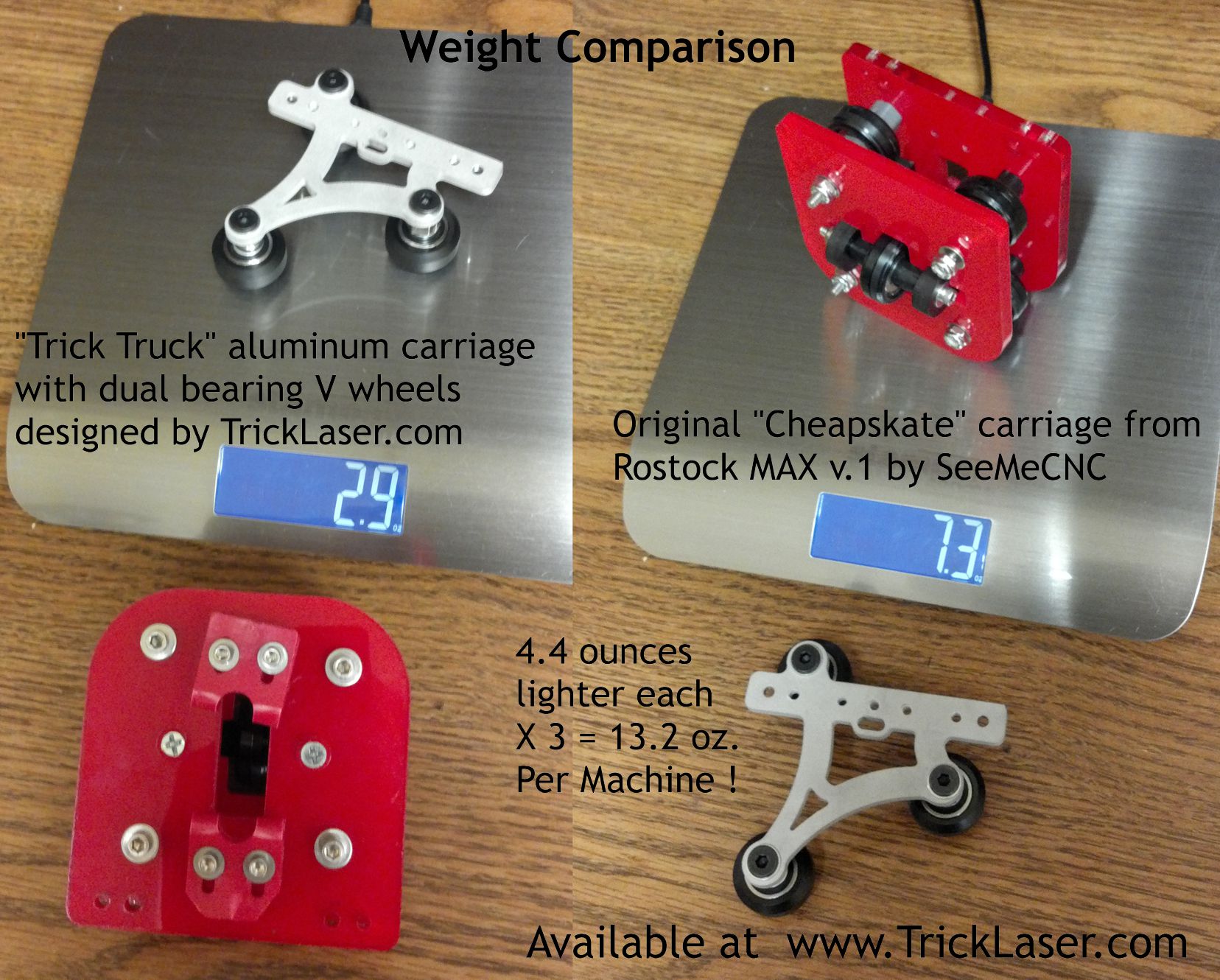

I was wondering how they compare weight wise with a R MAX v1 carriage so I weighed them today, check it out !
(Jim already did a compare to his v2 carriage, even though v2 has 4 wheels vs. 5 the Trick Trucks are still 1/2 the weight.)
