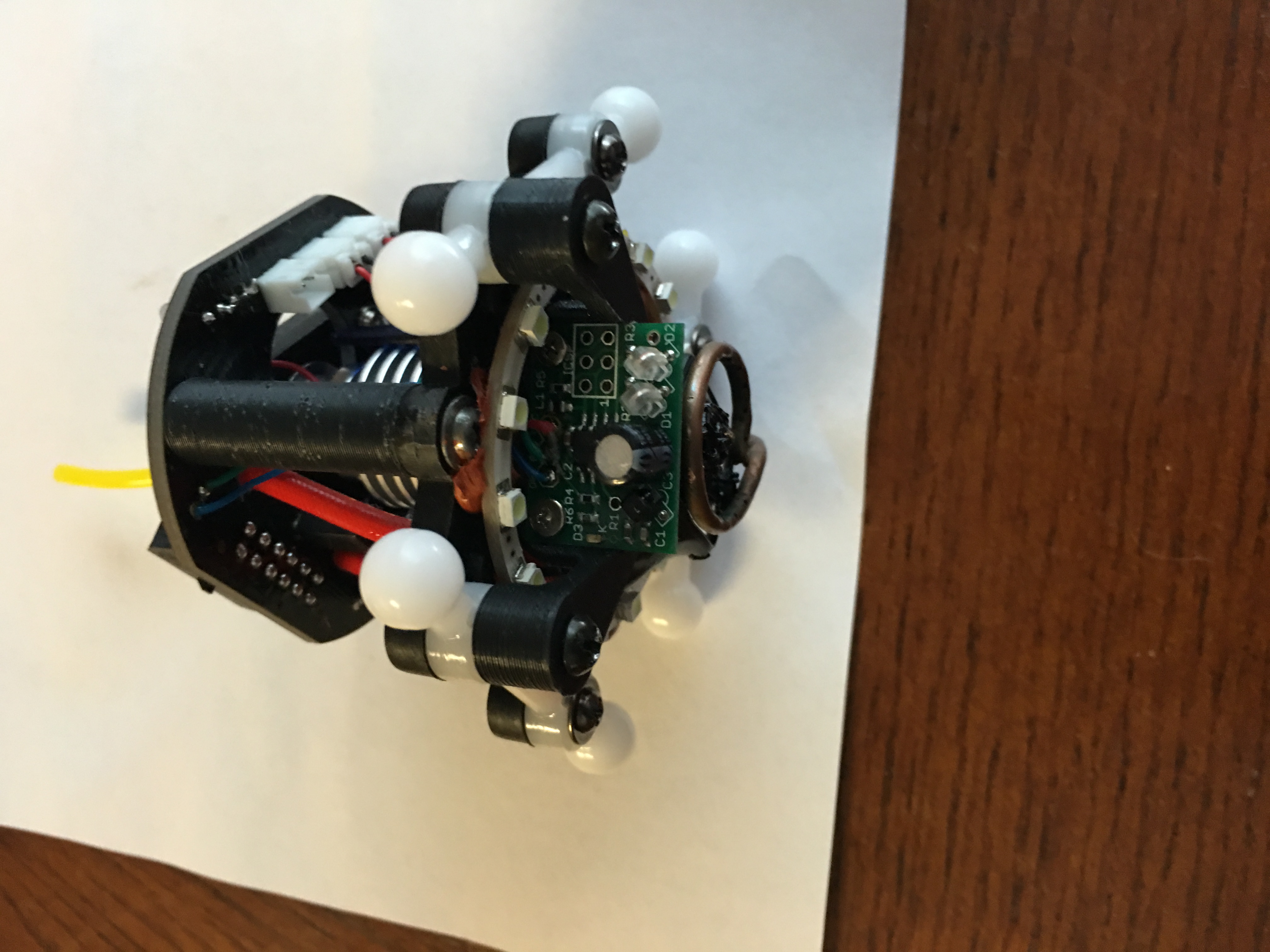

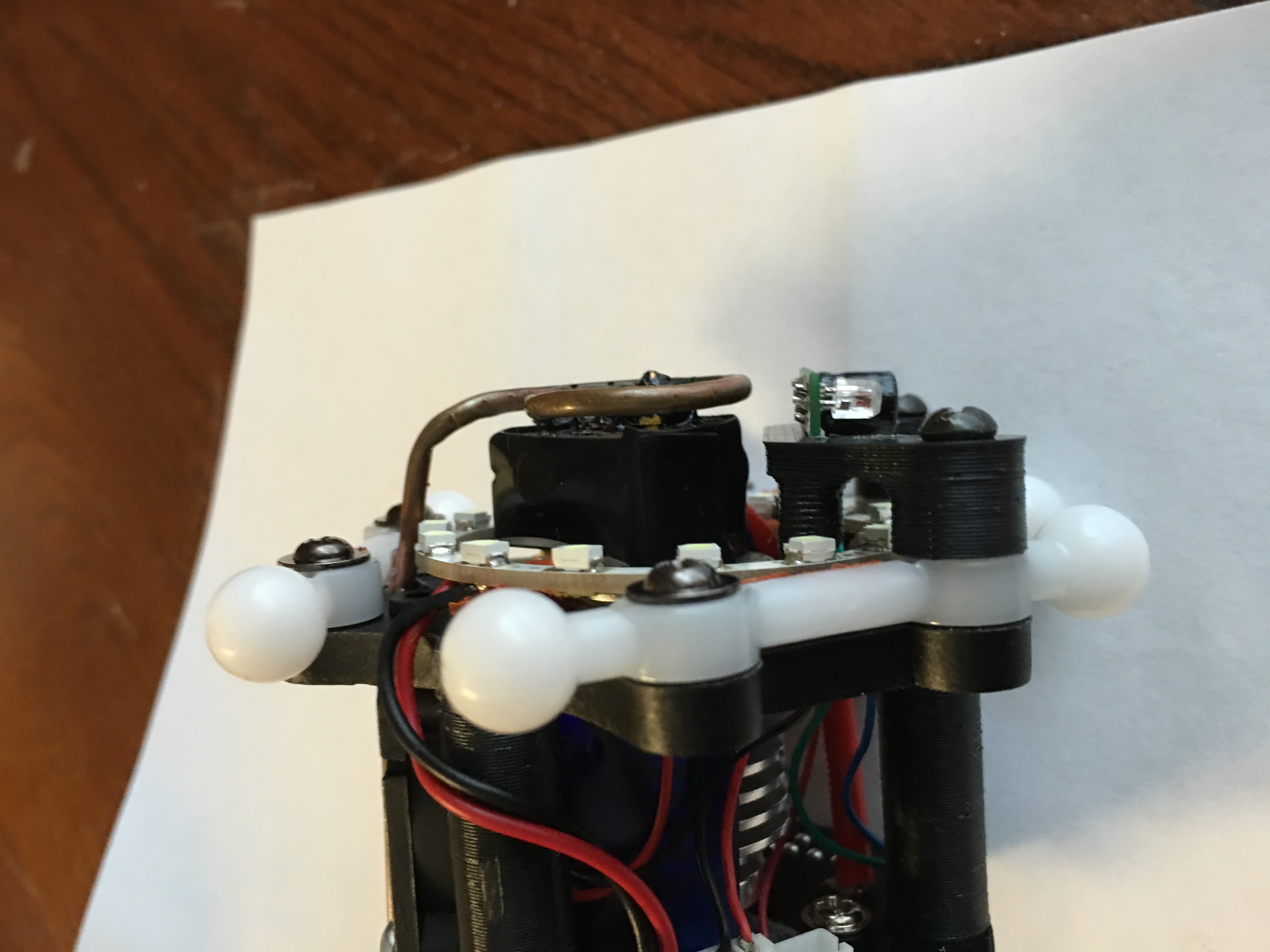

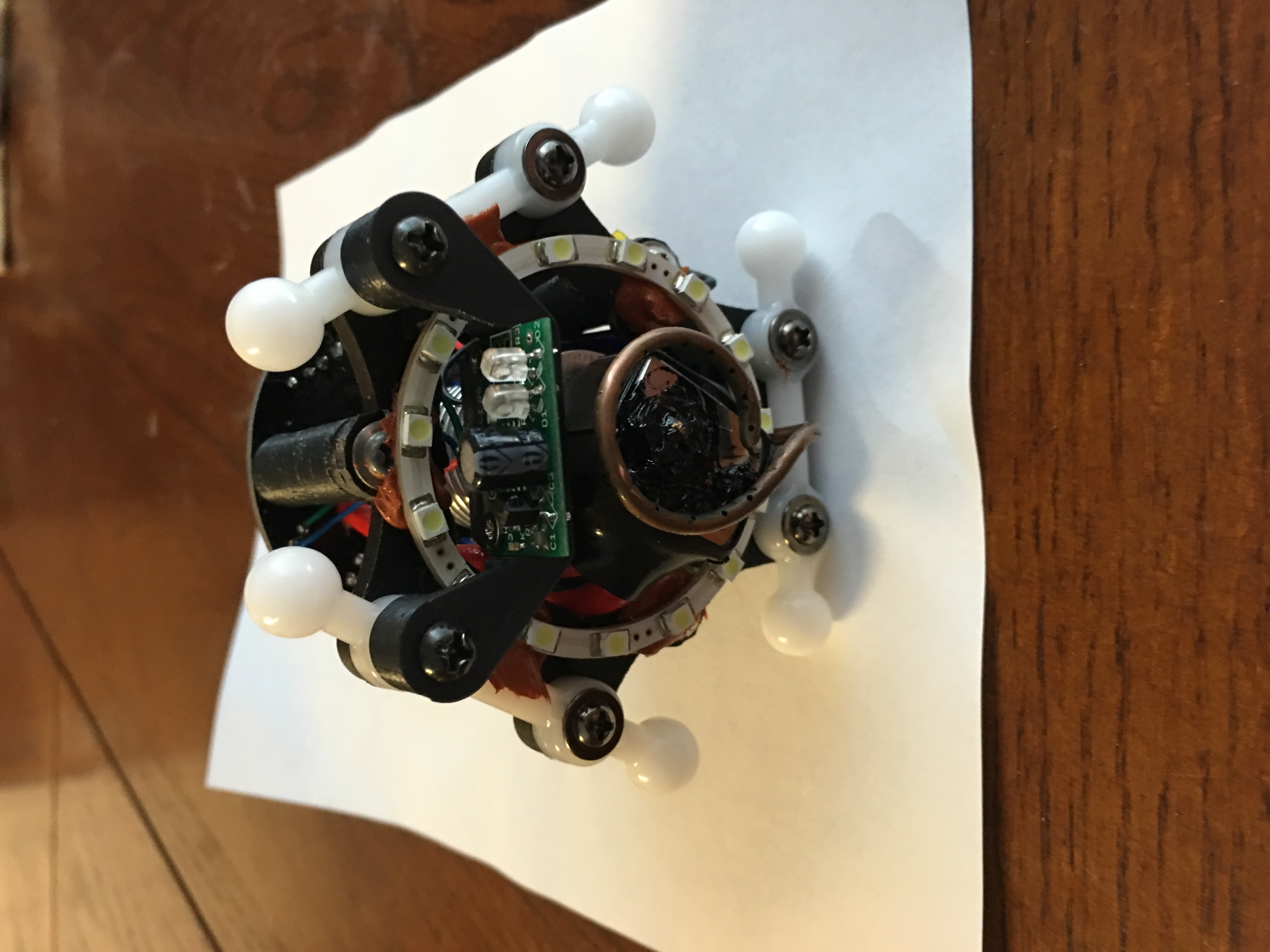

I decided to give DC42s IR probe a try and needed a mount that would work with the stock Rostock effector.
If anyone is interested here is the mount: http://repables.com/r/762/

Thanks for a link to the mount and the picture you have posted. I wonder if the IR Probe would have difficulty with PEI attached to the glass?
