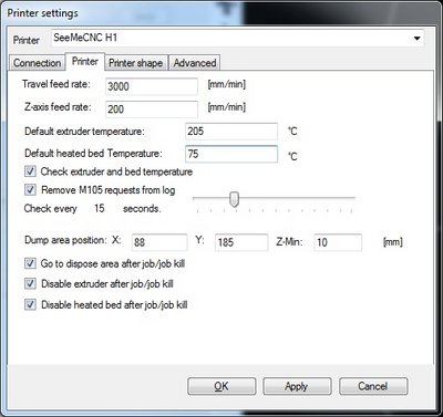

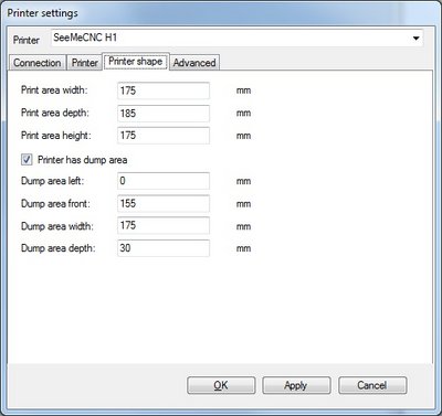

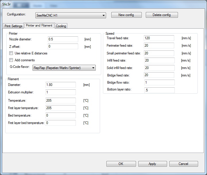

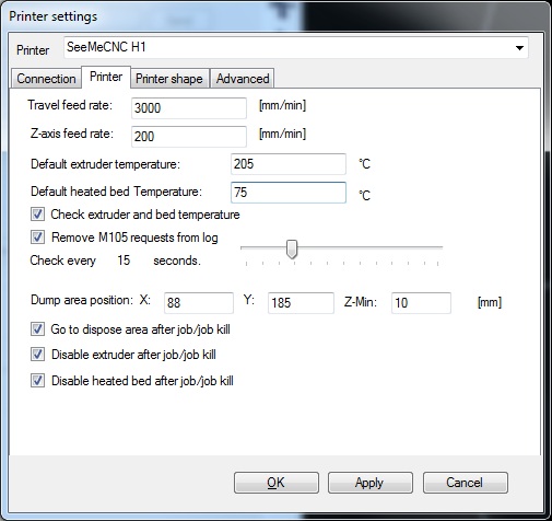

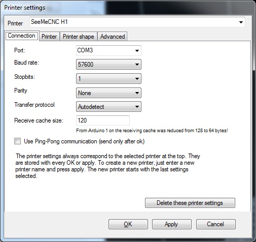

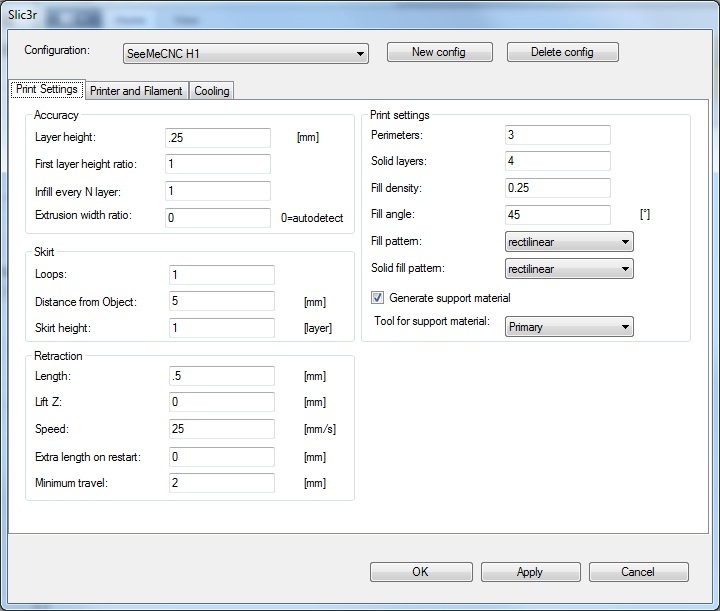

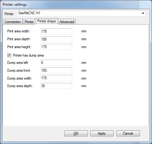

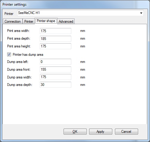

Hey all,
Here are screen caps of my slic3r and Repetier host (printer) settings. Below is a link to the Repetier fimware Configuration.h file that I use.
So far the print quality is getting near perfect, still have to work out some tweaks to slic3r and the heated bed temperature.
http://www.reprap.org/wiki/SeeMeCNC/Rep ... guration.h
Mike Latif

What slic3r version are you using.

Hey Dave,
The version that comes with Repetier Host 0.40 is slic3r 0.7.1.
