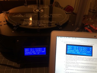

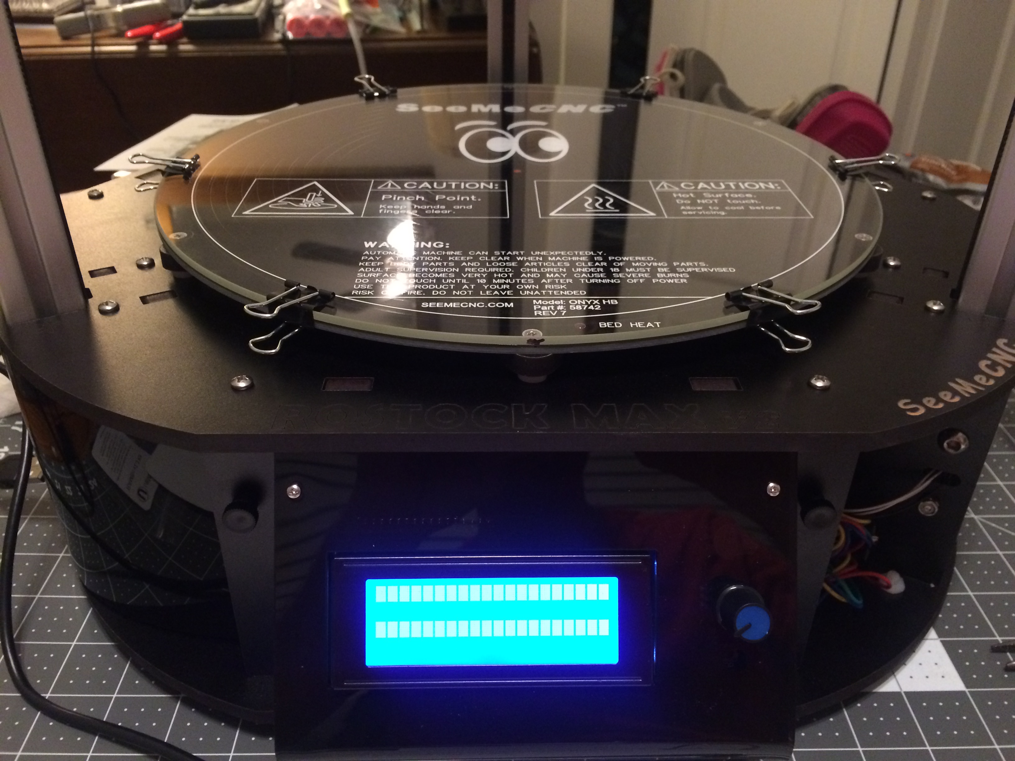

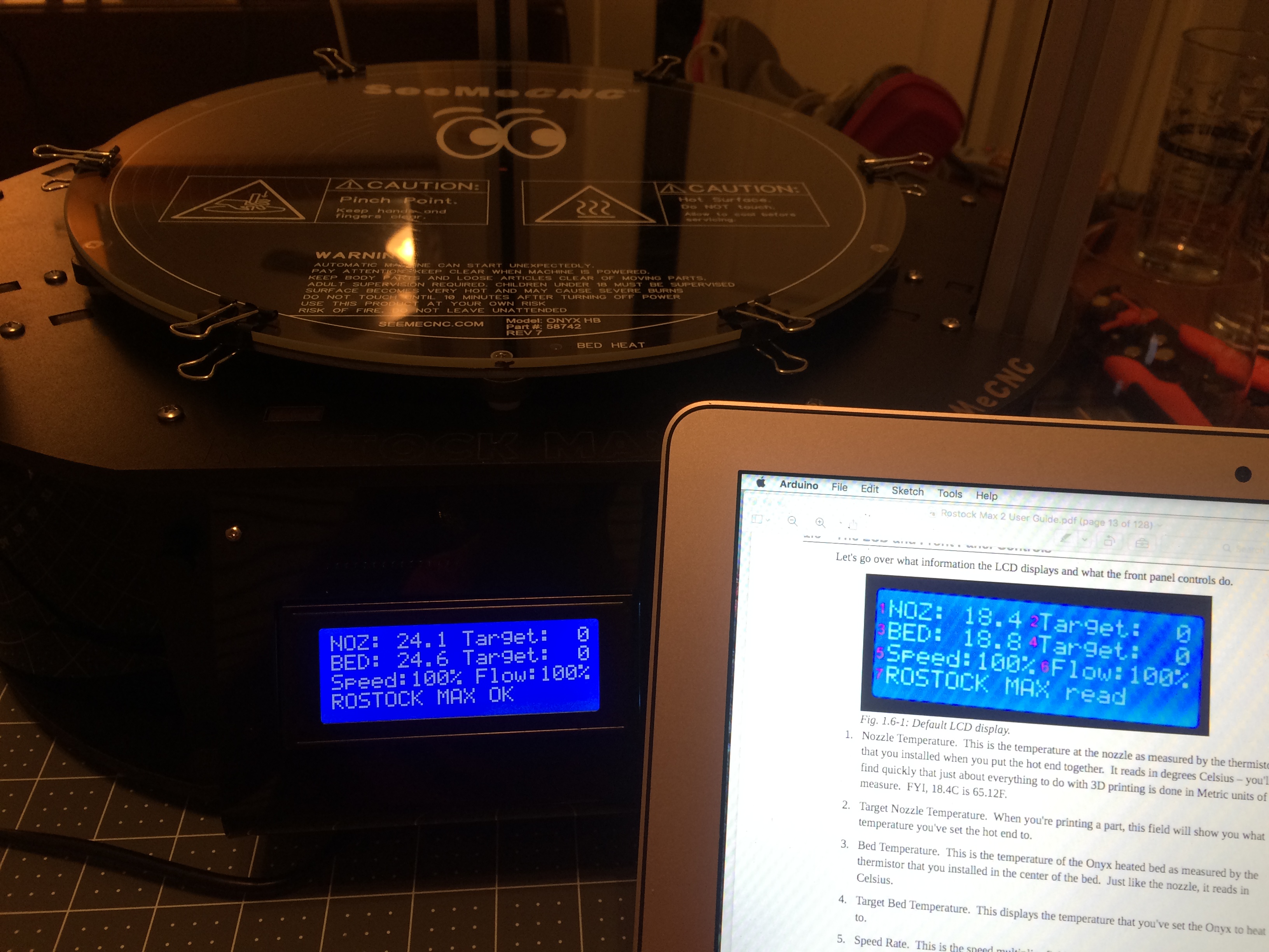

Thanks all! I actually remembered that I had a small marble game that needed some soldering so I used that as practice. Wasn't too difficult once I got the hang of it. Glad I had it as it gave me some confidence before launching into soldering for the Rostock. Good news is that everything is now built!!! And it was working great...was starting on the calibration last night when it shut down on me. Described that issue in another post and seems like I may have blown a fuse. Hopefully I can get that sorted out soon so I can start printing!
