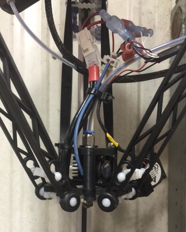

At first I was completely happy with my Max as it was, but I've caught the upgrade bug and I just put on a dyzEnd hot end that I'm looking forward to having up and running (I'm having trouble with the firmware and I'd appreciate any advice). http://shop.dyzedesign.com/product/dyze ... 26983.html This little guy is a great fit on the Max (if i can get it printing) and despite it's small size it manages to get up to a whopping 500C. I managed to get it to heat up for a while before receiving an error message and it wasn't on for about 10 seconds and it was already hot as hell.

Could you have over driven the Rambo getting that DYZE hot end up to 500? if you plug your original SeeMeCNC hot end back in does it still print? perhaps contact DYZE about it? this is the first I have seen about your DYZE hot end but perhaps others hear are using it.

Bit of a stupid late reply but I haven’t tried ramping up the hotend on the original to 500. I think the issue may come down to the heating element. I wouldn’t doubt that the stock one could withstand 500c for some period of time, but the Dyzend gets up to 500 fast as can be. After over a year of use I wouldn’t recommend the Dyzend unless you really love messing with your PID tuning. I have done some massive prints though with it and it can fly though material. It has no problem going high on the heat to increase the extrusion multiplier for high speed printing. I did have issues though with small nozzles and trying to dial in a really specific temp for precision printing. My next upgrade is going to be a dual extruder setup with the stock nozzle for lower temps and finer, slower prints.Windshadow wrote:Welcome to the list that provides the Best Delta printer support in the world.

I would not do a dual extruder setup if you only plan to use one at a time. The ball cup arms make swapping a tool-head fast, and a with a pluggable connector, it means you don't have to deal with offsets, extrusion, leveling, and effector tilt. Just swap and go (I've swapped everything but firmware in less than 5 minutes, and that's layer fans, main power, sensor (and sensor type), peak fan, and Berd Air connector). All you really need to do is define a separate tool and activate it when you want it (and otherwise either leave the temp sensor plugged in, or have a dummy plug for it, to avoid the dreaded DEF errors), or use the same sensor and heater pins (which I can't do as my E3Ds use PT100 sensors, and my stock hotend has an M3 thermistor, which need different processing to give useful signals)mrt1069 wrote:Bit of a stupid late reply but I haven’t tried ramping up the hotend on the original to 500. I think the issue may come down to the heating element. I wouldn’t doubt that the stock one could withstand 500c for some period of time, but the Dyzend gets up to 500 fast as can be. After over a year of use I wouldn’t recommend the Dyzend unless you really love messing with your PID tuning. I have done some massive prints though with it and it can fly though material. It has no problem going high on the heat to increase the extrusion multiplier for high speed printing. I did have issues though with small nozzles and trying to dial in a really specific temp for precision printing. My next upgrade is going to be a dual extruder setup with the stock nozzle for lower temps and finer, slower prints.Windshadow wrote:Welcome to the list that provides the Best Delta printer support in the world.
