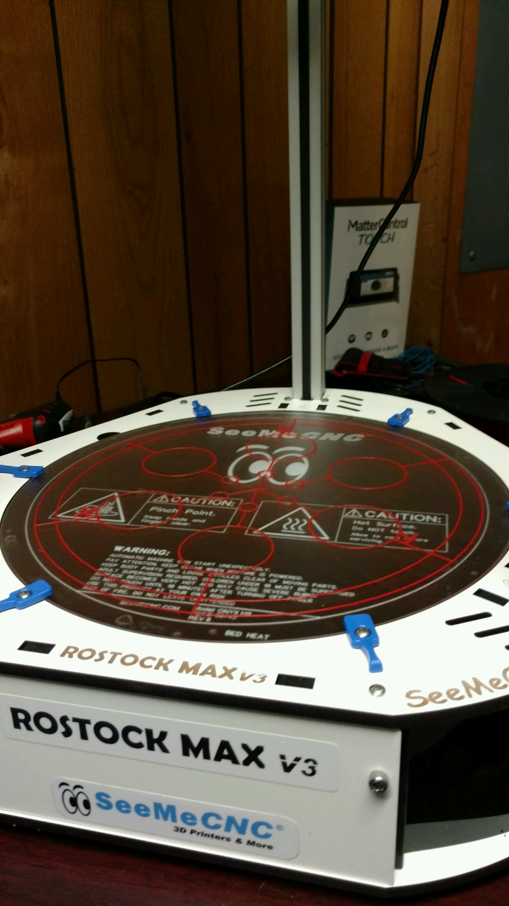

Remember, this wizard is a first time tool. After using it, you only need to use G29 or the LCD screen to auto calibrate your printer (such as when you clean the glass build plate).
I'm printing on FaBlam in the photo. The HE280 auto calibration makes it way more fun to print on this stuff. It can last 100's of PLA prints. Just use way less bed heat or no bed heat at all. Then careful when removing your print not to cut the FaBlam.
Here's my calibration print:
A couple calibration prints. Note that a skirt loop with a 275mm diameter calibration print is reaching even farther outside of the 10.5" (267mm) diameter working envelope.
http://repables.com/r/800/
