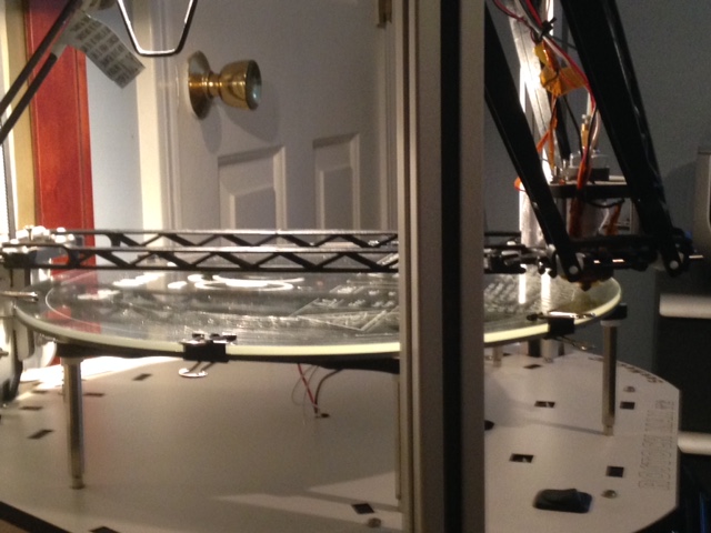

Context: I bought/built the Rostock Max v2 for one purpose: to print a prototype around the edges (a circle 10.7" diameter x ~4" high) that was in April, about 4 months ago. It feels like 4 years.
I have come to realize that, either due to a glaring error or willful deception, it is physically impossible for the out-of-the-box Rostock Max V2 to print an 11" circle as the specs claim. The real spec is perhaps 10.6"
This is due to two limiting factors/design flaws, of which photographic proof shall follow.
1) With the nozzle opposite its tower, no Cheapskate can proceed low enough relative to the print bed to position its Delta Arms horizontally to maximize their reach.
2) Even if they could, the DAs are simply not long enough to extend the nozzle all the way out to the 11" circle line.
I imagine this all could be solved with longer Delta Arms. The Cheapskates don't like taking the DAs horizontal anyway, so this would be the best option, and I for one don't need so much Z room. Anyone know a source for those out of the box?
Meantime, of necessity, I have found a way to address issue #1 by raising the Build Plate
onto 2" circuitboard spacers. That gets the nozzle at least far enough out for my purposes.
Check it out:
Note the horizontal Delta Arm. If you try this with your on-base bed, you will see it cannot be done (I'm not going to paste a pic of that after all, cause they're in my other computer.)

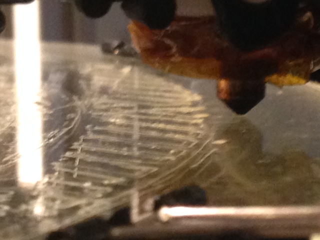

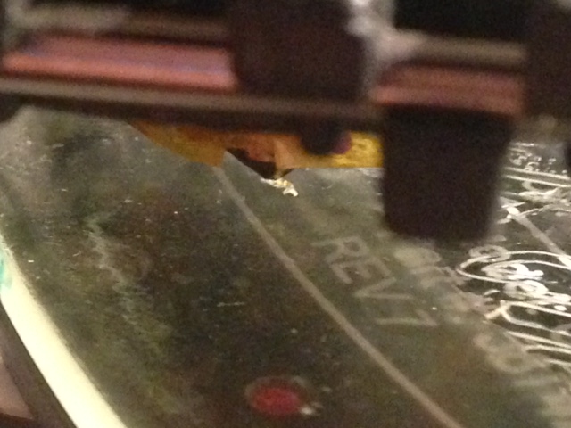

Now see here how the nozzle is still significantly within the 11" line?
No, because it's a shitty picture?
Ok here's a closeup with the line visible - better?
http://forum.seemecnc.com/download/file.php?mode=view&id=10081
It's not all the way to 11", but significantly closer - enough for my purposes at least.
Also, I removed the Layer Fan to avoid interference with the towers/belts, and brought in my skirt from 3mm to 1mm from the object.

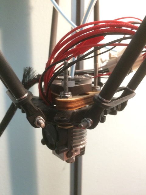

It might be much easier for most people to mount their hot end beneath the effector plate. That's where I currently have mine mounted, and it will reach the outer most parts of my build plate.

How do you mount under the effector?

I'm mounted under the effector as well. It's what all the cool kids are doing, we like to drop it low. You lose a little z-height but as 626pilot says, it's nice to see the hot end.
Simply removing the stand-offs will allow it to slide down. You could get shorter bolts or just let them be long on top if you are lazy.

To the gentleman wondering about how to mount your hot end under the effector, here is a photo. You just remove the standoffs and slide it on down.
