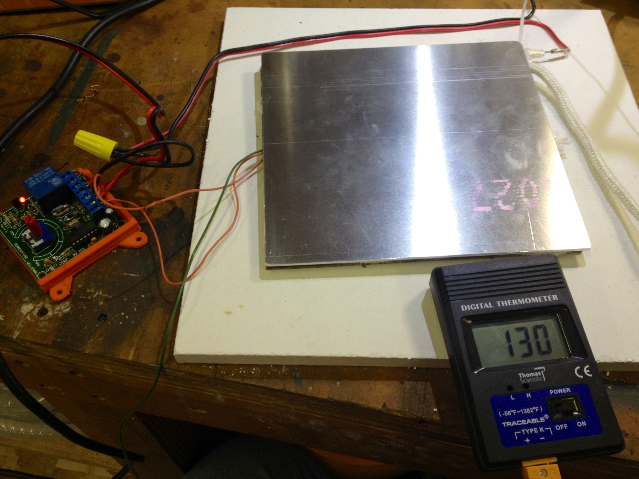

Homebrew Hot Bed
Ok, here it is up and running.
[img]http://mhackney.zenfolio.com/img/s1/v20 ... 9133-3.jpg[/img]
The Velleman is stock so the temp won't go over about 90°F. I need to calculate the resistor to swap with R5. The aluminum plate is just some old tooling I had. I wanted to make sure the heater worked before cutting my good stuff! I'm ready to go now.

Re: My H-1 Build and Mods
Chris, for some reason PMs stopped working. I get a user not found error for you! Anyway, my nichrome resistance according to the calculations, 10' of 16 gauge is 2.595 ohms.
cheers,
Michael

Homebrew Hot Bed
Chris, you were right, a diode was blown. In fact it was D2 and I blew it twice. It seems to be very sensitive to any jiggling of the power wires in the terminal blocks.
Anyway, I was able to try again. I still only get to about 90°F. So I swapped R5 with a resistor around 24K and was able to get to 140°F but don't know what the top end is. Here's a photo:
This has the 1/8" phenolic under and .1" aluminum plate on top (7" x 7 1/2" to fit the H-1 table). The nichrome gets very hot but the warm-up time was long. I need to do some calculations, I suspect I was shooting for a top end of 225°F in my calculations and with convection cooling I am probably going to wait all day to get there.
I'll report back.

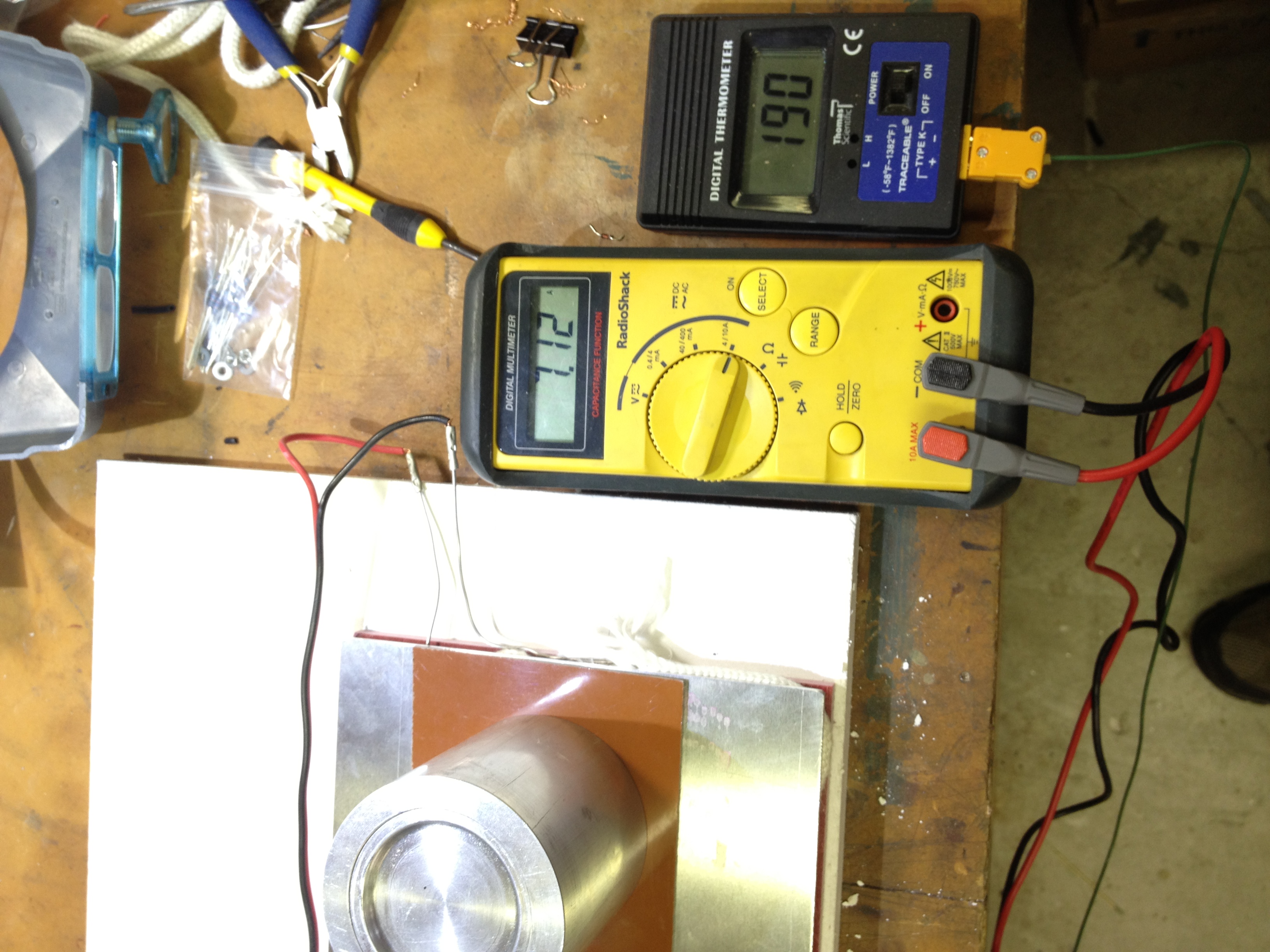

Homebrew Hot Bed update
Ok, now I am making progress.
I cut the nichrome down to 77.5" and changed R5 on the Velleman bored to a 15KΩ resistor. Now, with the pot pegged on max I can reach almost 200°F with the stock Velleman thermistor (the blue "bug" that comes with the kit).
As you can see, I am drawing 7.12 Amps and the temp is 190°F. I was able to get to 198° before the thermostat starts cycling. The aluminum sheet is very evenly heated out to the edges. Once this is sealed up and insulated it should be a pretty nice hot bed.
I am curious for those of you that have the MakerBot hot bed, how hot does the bottom of it get? Is it hot enough to warp or melt the H-1 table?
