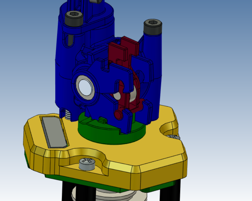

Post by mhackney » Fri Nov 04, 2016 2:35 pm
I've been exchanging emails with Lykle at Zesty about mounting on the V3 since it has the new HE280. A couple of back and forths and he has come up with a nice solution he calls the Mad Hatter! It's still a draft and I hope to get the STLs to print and test fit on my V3. I had test fitted an earlier design for the V2 Rostock and it, of course, won't work on the V3. This design is printed in 2 parts. The gold part is the cap (or Mad Hat!) and the green part is the Zesty Adapter.
Once the design is finalized, it should be very easy to mount the Nimble on a V3.

Great, while I was writing the above Lykle sent me the STLs to print and test. I'll do that as soon as a printer frees up.

The overall shape is good, I think I will want to see if there are tweaks needed in the support structure inside the Mad Hat, to support the Nimble.

Interesting... that was one of my worries was about figuring out an adapter... so it's good to know I can go for it straight away. I donated the money for two in case I decide to go for dual extrusion with a cyclops, but I'm probably going to I've it a go with one first.
Zesty_Lykle
Posts: 60
Joined: Thu Oct 27, 2016 2:45 pm
Location: Cyrpus
Re: Zesty Nimble extruder technical thread
Post by Zesty_Lykle » Sat Nov 05, 2016 7:21 am
HI Qdeathstar, thanks.
You know we have an adapter plate ready for the Cyclops/Chimera hot end, right?
It is in the Shapeways shop. We will also be making a DXF file available, so you can download it and have it waterjet cut if you prefer.
We will be publicizing the list of adapters we have available and/or working on soon. In fact, on Tuesday.
