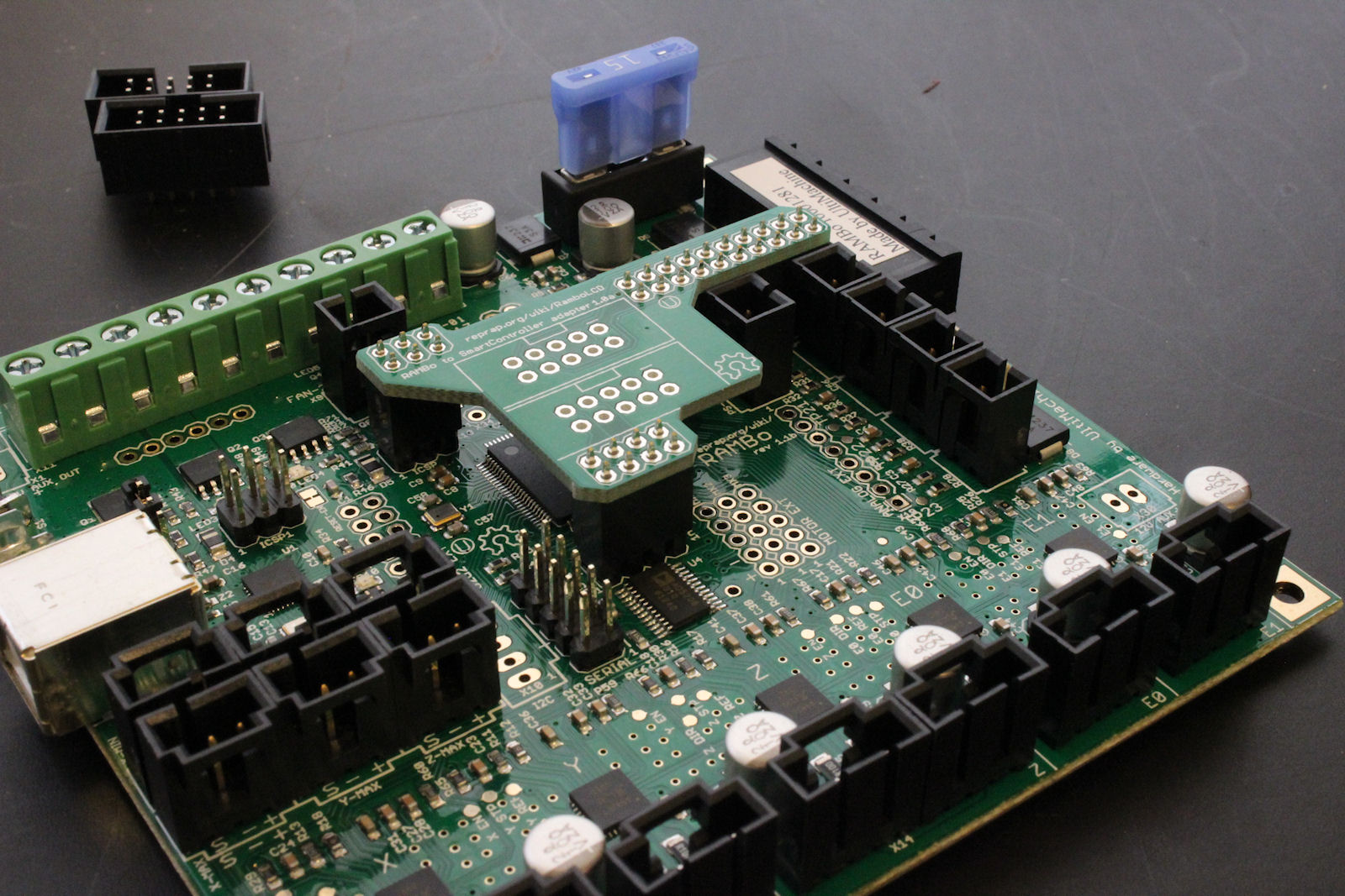

Here is a quick photo of the new RAMBo to LCD SmartController adapter (version 1.0a):
The two 5 pins X 2 rows shrouded headers mount to the silkscreen side of the board (you can see their outlines on the silkscreen). All of the other connectors (the ones I have "standing on their faces") attach to the bottom of the board.
I'll have complete build instructions available later today.

Here is how I constructed the board. I used a Weller WES51 soldering iron fitted with a long reach conical tip (a needle-looking tip). I set the temperature to appx. 720 degrees F. I used .022" diameter solder.
I slipped the 3 X 2 connector onto the ICSP header on the RAMBo. I then slipped the 4 X 2 connector onto the SPI header and the two 1 X 10 connectors onto the EXT-2 header. Here's a photo at this stage of construction:
I then slipped the adapter PCB over the pins of the four connectors to ensure that the pins were centered:
Once I was satisfied that the "fit" was good I soldered each of the pins to the PCB. Fitting and soldering these parts this way ensured that each of the connectors was precisely aligned to the headers on the RAMBo. Once I had all of the pins soldered I gently removed the pcb/connectors assembly from the RAMBo and soldered the two 5 X 2 shrouded headers to the silkscreen side of the board. I then inspected the solder joints under magnification to ensure they were all good. I then trimmed the excess from the connector pins close to the surface of the board. Here's a photo of the completed assembly as it fits over the MCU on the RAMBo board.
Hope this helps!
Bill

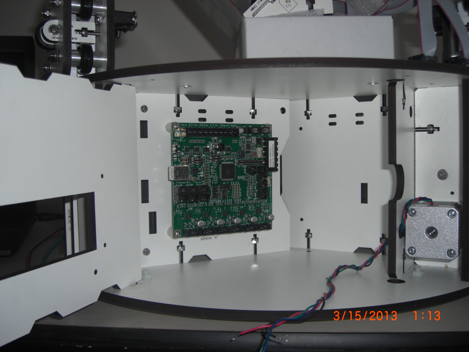

Where did you mount the control board? The cables seem too short
cambo3d
ULTIMATE 3D JEDDI
Posts: 1058
Location: Florida
Re: RAMBo to SmartController Adapter 1.0a
Postby cambo3d » Sat Mar 23, 2013 5:39 pm
cassetti wrote:Where did you mount the control board? The cables seem too short
I mounted mine here, this is the only place you can mount it, and still have the lcd cables long enough to open the door.
cassetti
Posts: 249
Location: Wilmington, DE
Postby cassetti » Sat Mar 23, 2013 8:58 pm
Exactly where I ended up mounted mine. I'm in the process of final assembly, should be installing firmware tonight!
