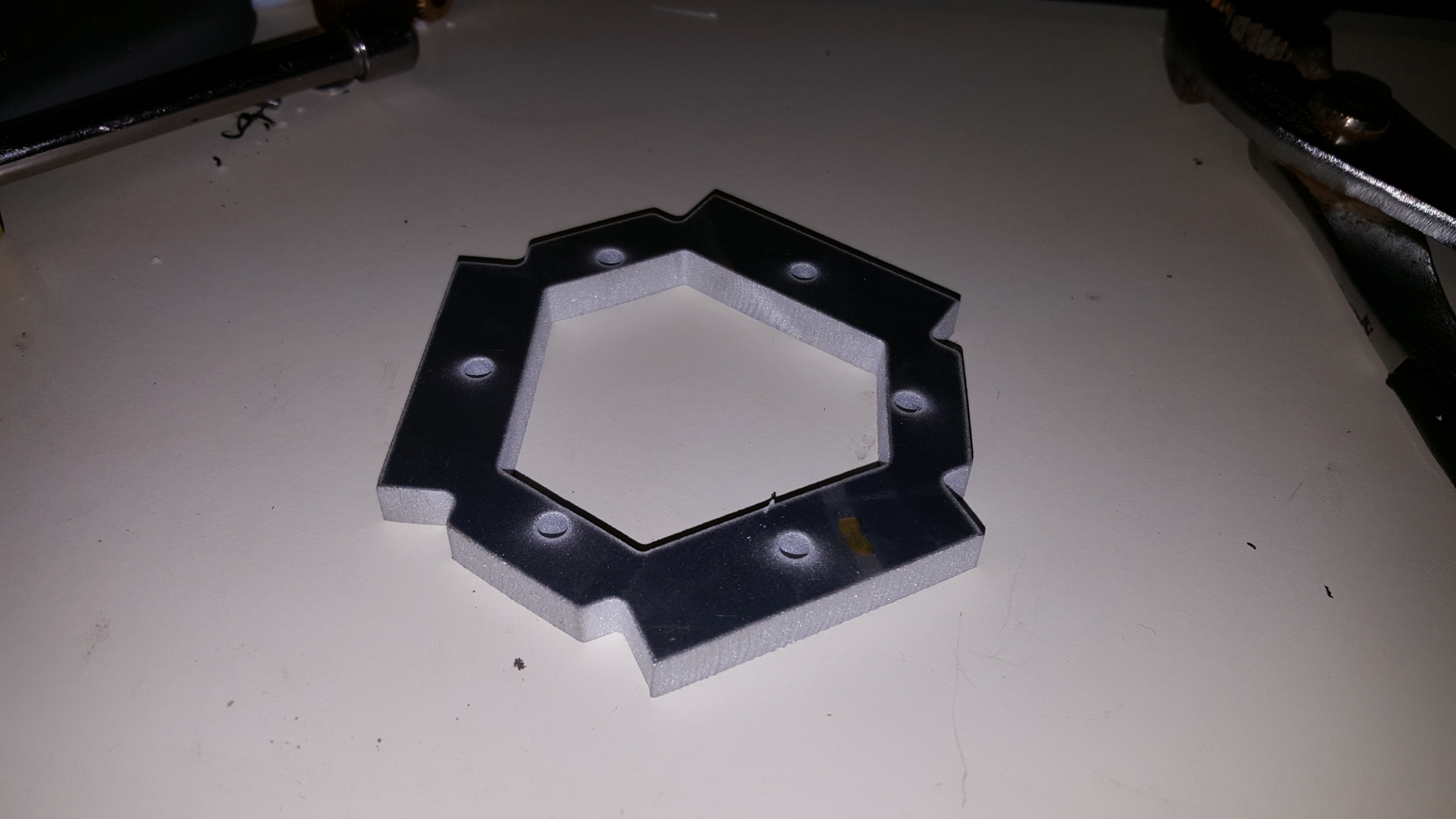

Hello again,
Well i have my new platforms in hand, just need to get the cross holes popped in, and I wired up the hot end to the rambo board, following the manual and other posts regarding heat 0 heat 1 t0 t1 etc etc.
printed platform assembled (just for testing)
I'm to the point where I need to make the firmware changes, and I'm not sure if i am just out of it or what but I am simply chasing my tail.. well.. if i had one ya'know...
I have scoured the forums and found various threads with what appears to be a table of the lines that need to be modified, but where exactly do i find/edit/upload/flash or whatever the firmware file?
viewtopic.php?f=36&t=7532
viewtopic.php?f=77&t=7447
http://www.repetier.com/firmware/v091/
I'm usually stubborn and proud enough to attempt to figure stuff out myself before ever asking for help but I am just to worn out to care right now haha. (from remodeling my house all weekend)
oooh, also, got my 24v power supply, solid state relay, world of difference, 2 min heatup instead of half an hour, got the trick trucks and 325mm CF arms installed, and the heat spreader. prints have never been better. life is good. but now I have the aluminum platform and the stock hot end got plugged today because the filament had a knot in it (kinda) on the spool and it broke the filament and cooked it in the nozzle for 4-8 hours on high. so i figured why not swap to the new hot end if i have to take it apart anyways.
aluminum platform without cross holes yet.
If anyone can help me out with this I will be ever so grateful. Heck, i'll have 2 extra aluminum platforms if they all turn out good once machined ;)
Thanks,
Pete

Okay, here's a little bit back on the original topic!
The dual extruder holders are printed and installed. The big effort here was a substantial teardown to add t-slot trim and run all the extra wires to support dual extrusion. So far, so good! Here's the current revision of the holder, design view, and printed and installed:
I'm not sure I'll stick with them in this location in the long term, but I think those extruder holders definitely achieve the goals set out for them! After a couple more tweaks and some code cleanup, I'll be publishing those.
I need to either find a darker background or stop printing in black all the time. Also, they form a very solid frame; those suckers are some beefy rigid extruder holders!
Regression testing (making sure I didn't break anything) has started, and one test print turned out fine.
Next up will be installing the second hot end and working on firmware changes.
Here's the current design idea for the dual tool holder:
The immediate problem is fan placement. In the pictured position, they'll get in the way of the lash straps on the arms. It'll either have to change to a single fan, or else offset the hot ends some to make space, or both.
The pictured effector platform was been printed and seems to be working great after several prints. It differs from the test print above by adding some support material around the M3 threaded rods to keep them from being bent by the lock nuts when they're tightened down.
So, as far as printer modifications go, things are going pretty well. The wiring is in place and at least didn't break anything. The new extruder holders and effector platform look good to go.
