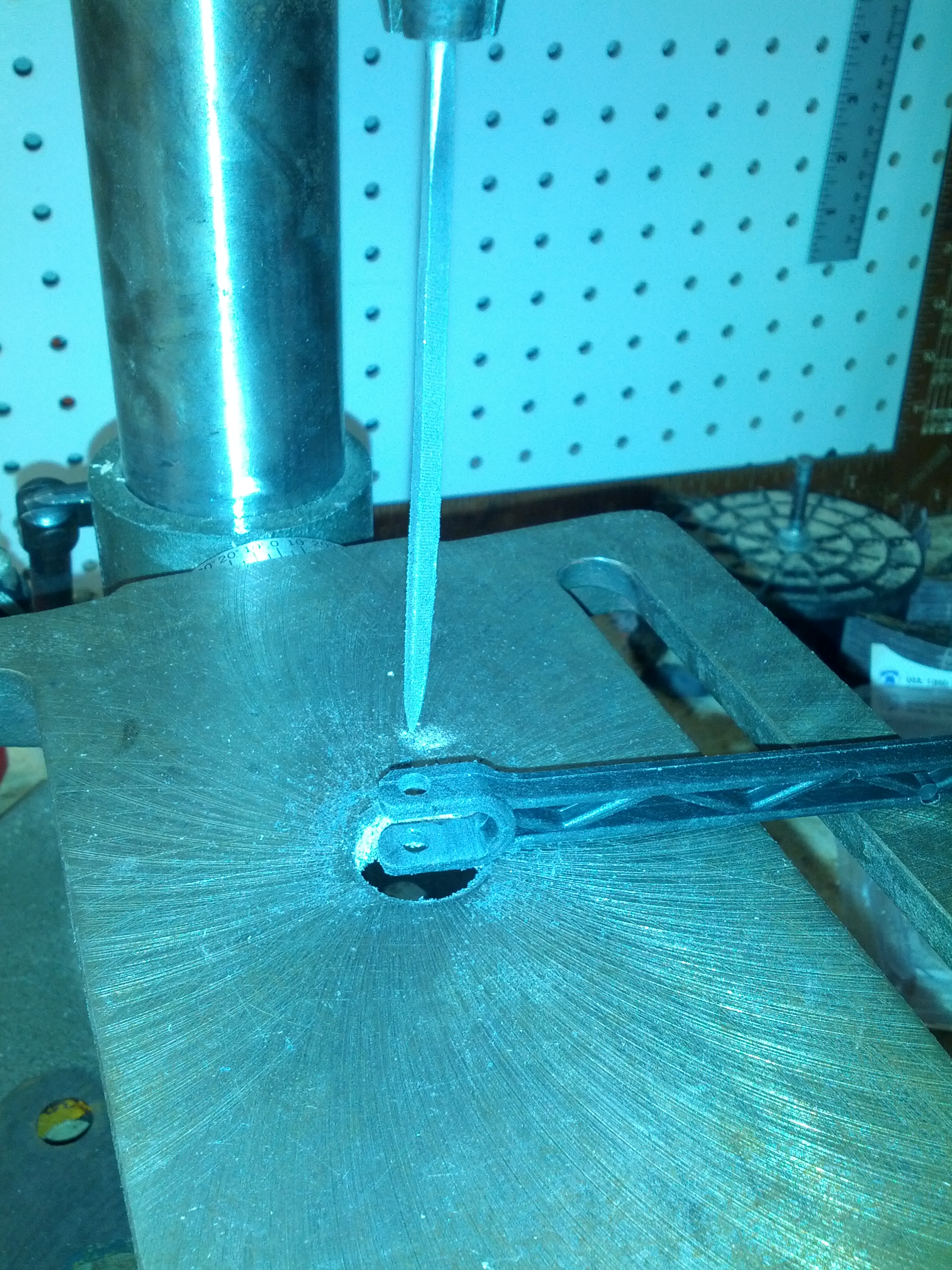

Actually, it worked pretty well. I did not over-enlarge any of the holes in the delta arms. I did not even put an eye out.
Delta file in a drill press. (Sorry about the white balance.)
This is a small delta file in a drill press. I used it to ream out the holes in the delta arms*. It removed a whole lot of material very quickly. I basically just touched the spinning file to the hole, then re-tested the fit. Most holes were big enough after a single touch; a couple needed a second go.
I did not have any real reaming tools, so I improvised.

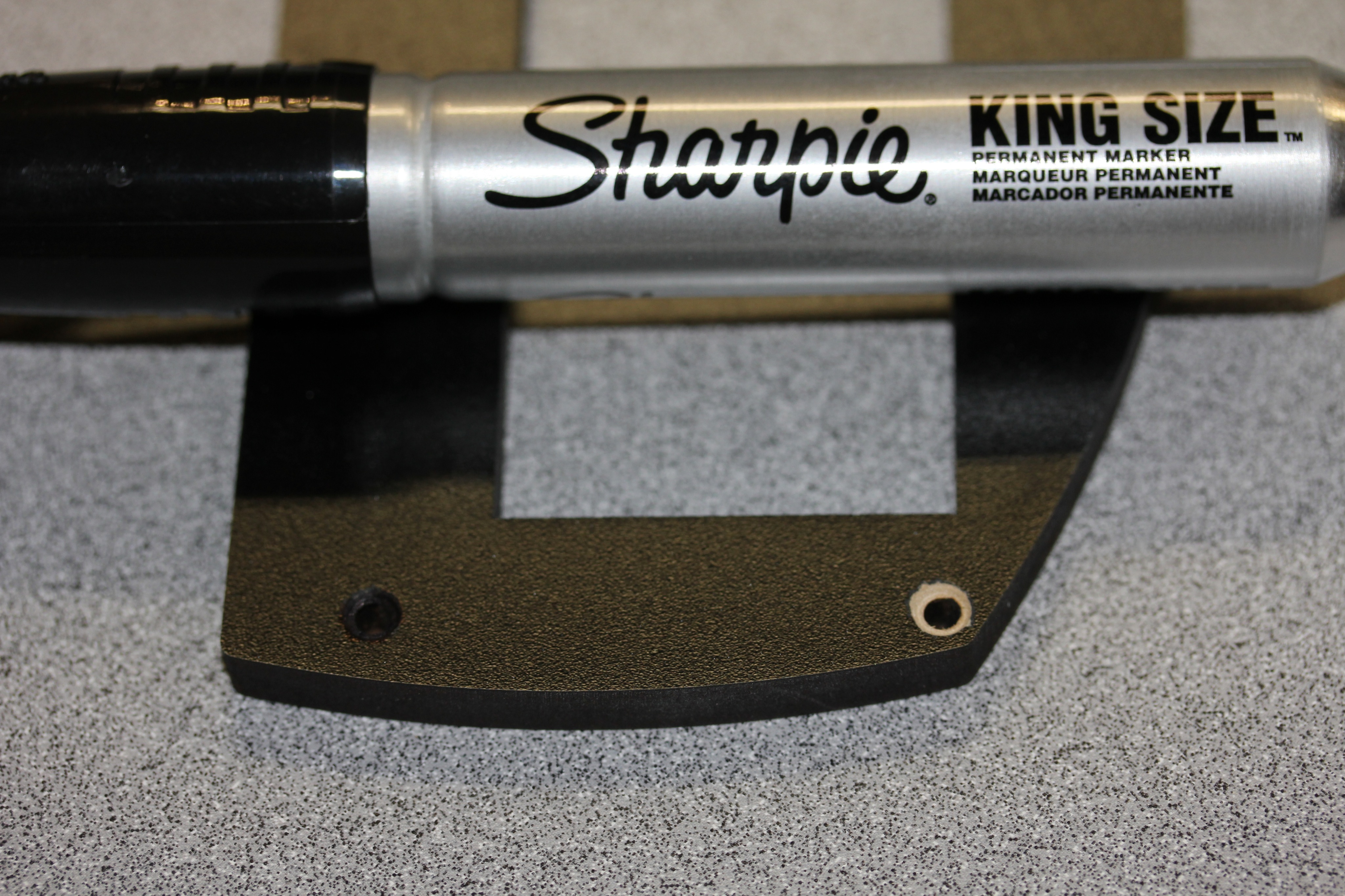

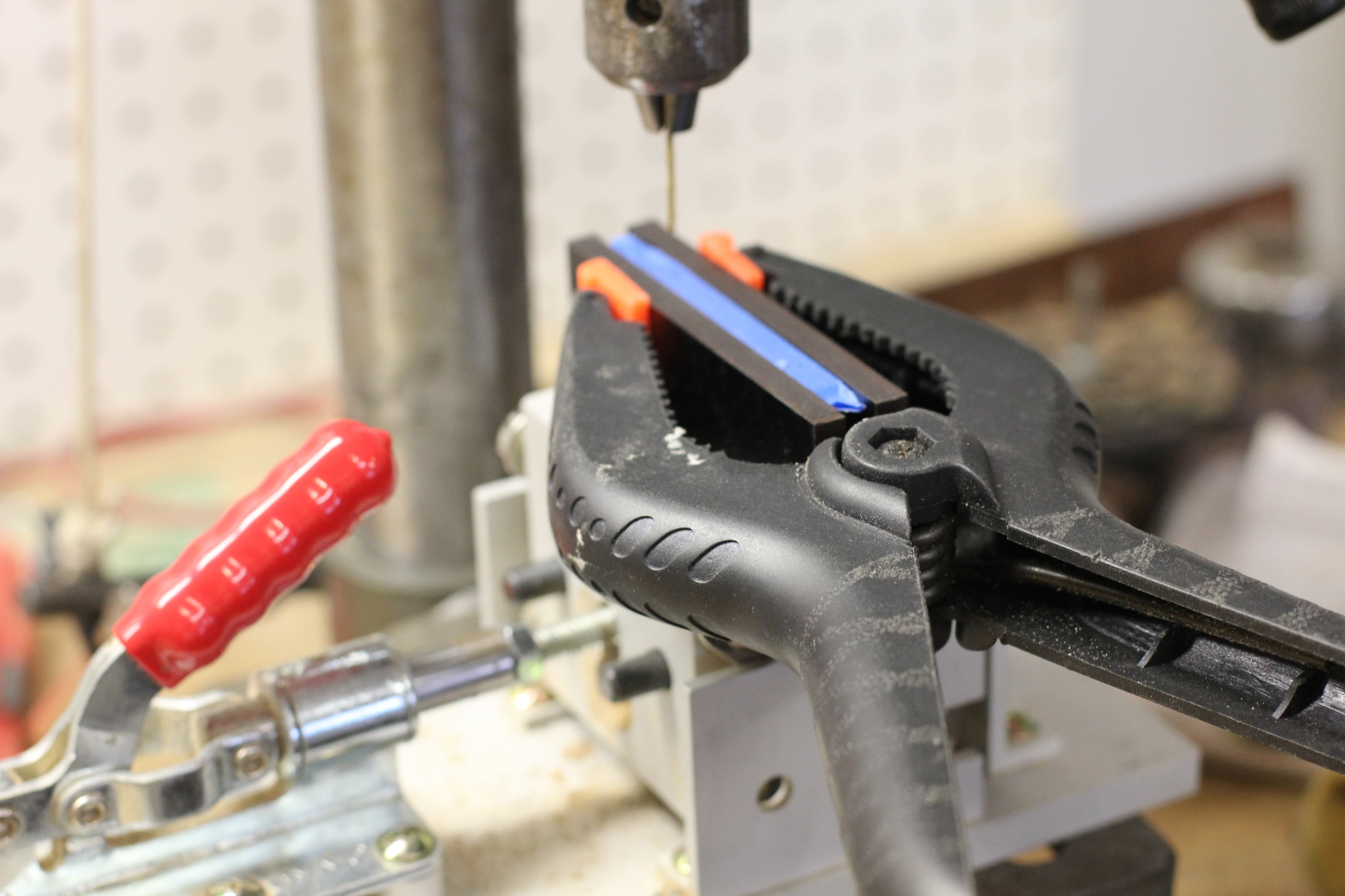

The photos of the split LCD panel ends in Gene's manual made me very very cautious about splitting mine. I pressed the pieces between two other pieces of melamine using both a vise and a clamp before i drilled the pilot holes. The blue tape is there so I could mark where to drill. Pencil on blackened fiberboard was not visible.
Vise plus clamp
I clamped it in a vise to put the screws in, too.
Just a vise
There was no splitting. I also carved out extra clearance around the SD slot with an X-Acto knife so the left end would slide all the way onto the board. The right end needed just a little carving to clear the rotary encoder's pins.
A black Sharpie dressed up the countersink holes. The fiberboard sucks up Sharpie ink like a sponge.
Countersink hole in sinkhole black

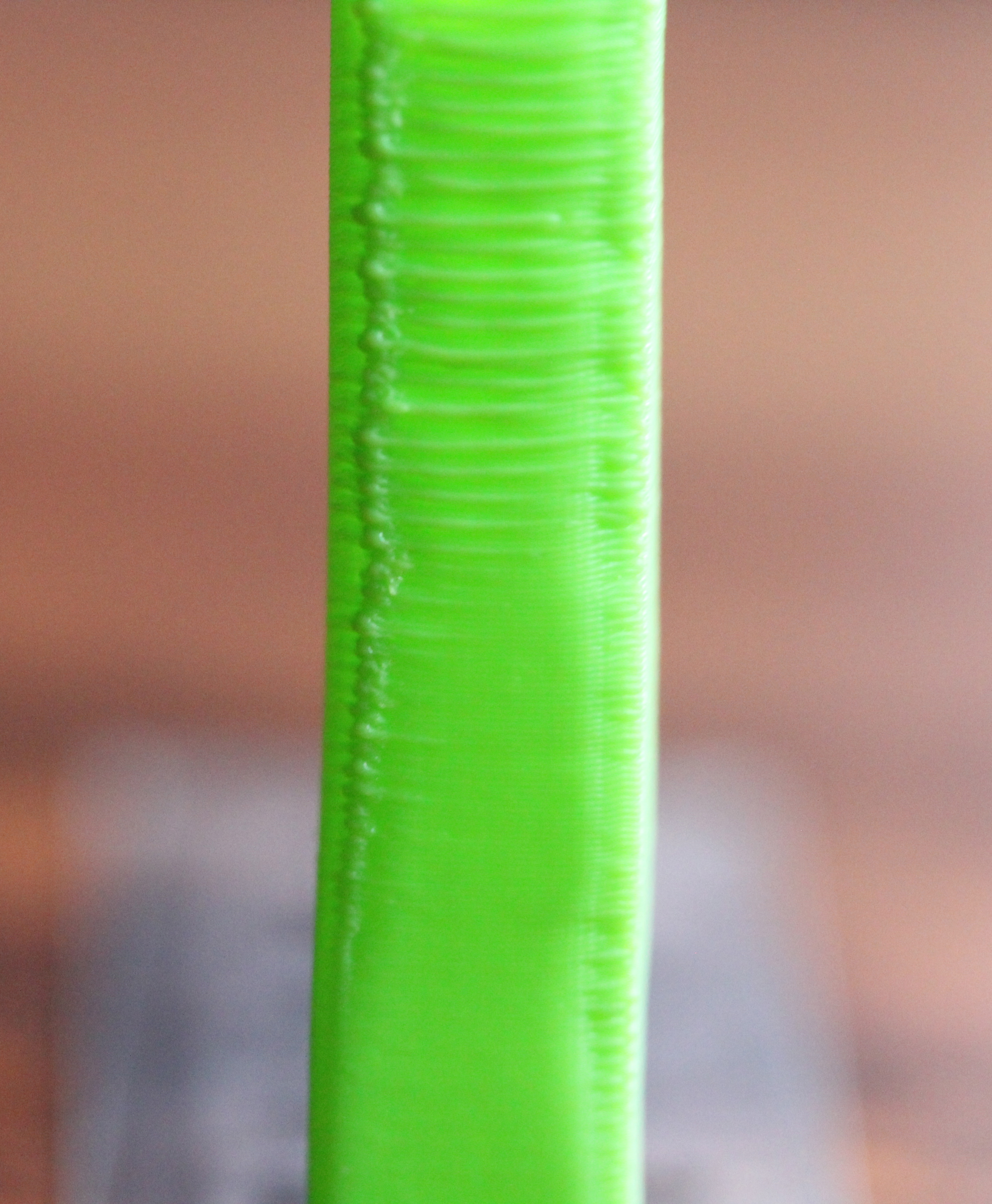

  • I printed the 50mm tower with a single layer perimeter and no infill. It came out crooked with a bead down its back. Should I be concerned? What is this object supposed to test?
    50mm tower. Crooked.
    Same tower, close up.
