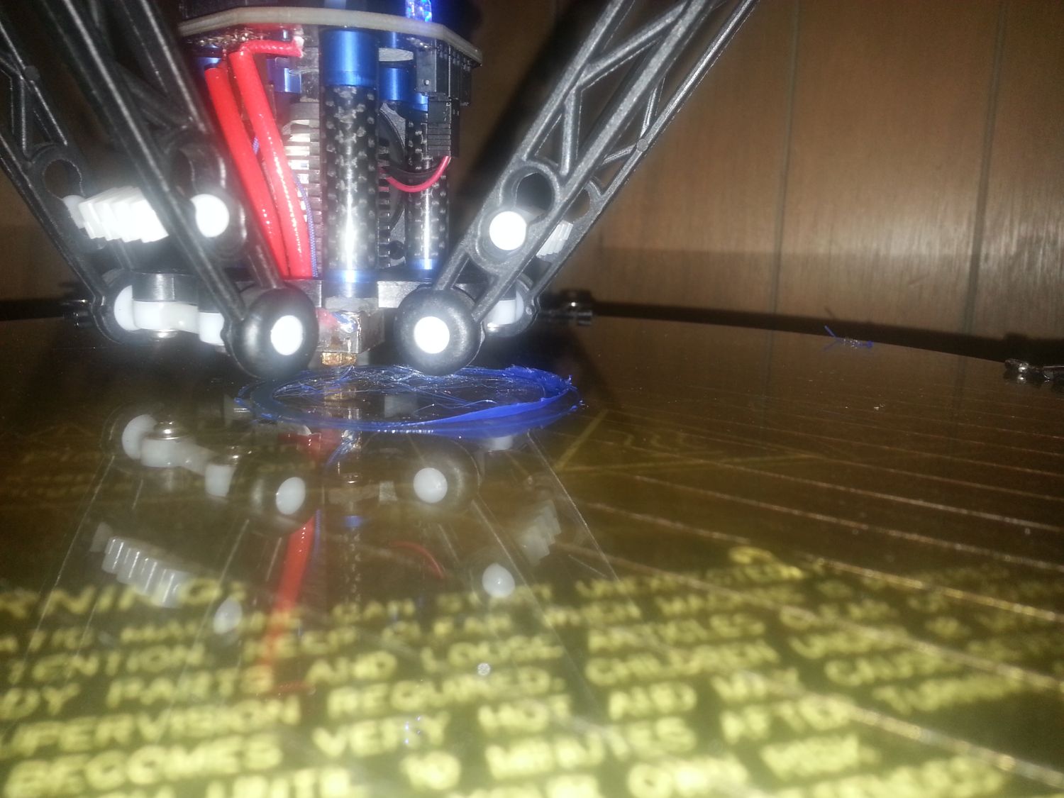

OK, so I had a long troubleshooting session last night and I think I'm getting somewhere.
This is what was happening every time. just a globby mess.
I re-leveled again, and started the print. It failed of course, so i added 50 microns to my z-max and tried again. I did this about a dozen times until something finally stuck. I'll list this attempt as the first attempt for simplicity. It was ugly and the skirt completely flopped, causing buildup and stringiness. I let it go anyway and it managed to finish the circle. The Y tower side was already detached by the end of the print so I just peeled it up from there.
I could tell it was obviously out of level, but the result surprised me because the Y tower was the tightest against the feeler gauge so I expected it to be the thinnest side. Instead it was the thick messy side, with the opposite end around 0.07mm thick. I measured the flattest part of the messy side at 0.21mm. I figured first step was to fix the level issue so I reduced my X and Z offset by 5 steps and added 5 to my Y offset. this is the next print.
This one was fairly messy as well but it was closer. The thin spot was still opposite the Y tower at 0.13mm with the Y side at 0.20mm. I figured I was on the right track so I repeated the process.
Even closer but still a mess on the Y side so I chose to only change the X and Z this time, as the thin side was now 0.18mm
The print never got started so I aborted and went back to adding 50 micron advances. It took three attempts to get another successful adhesion
That's where I am at the moment. I'm at work right now so I haven't had a chance to export my settings. BTW, dumb question, but how do I export slic3r settings? I know the eeprom part. I should note that for all these prints I was printing at 250c as apposed to the 245c from the other day. I may try 255c the next time I try. I also need to change my skirt settings. It's clearly needed to get the nozzle primed but I have to sit there and grab it with tweezers bit by bit so it doesn't sabotage the rest of the print.

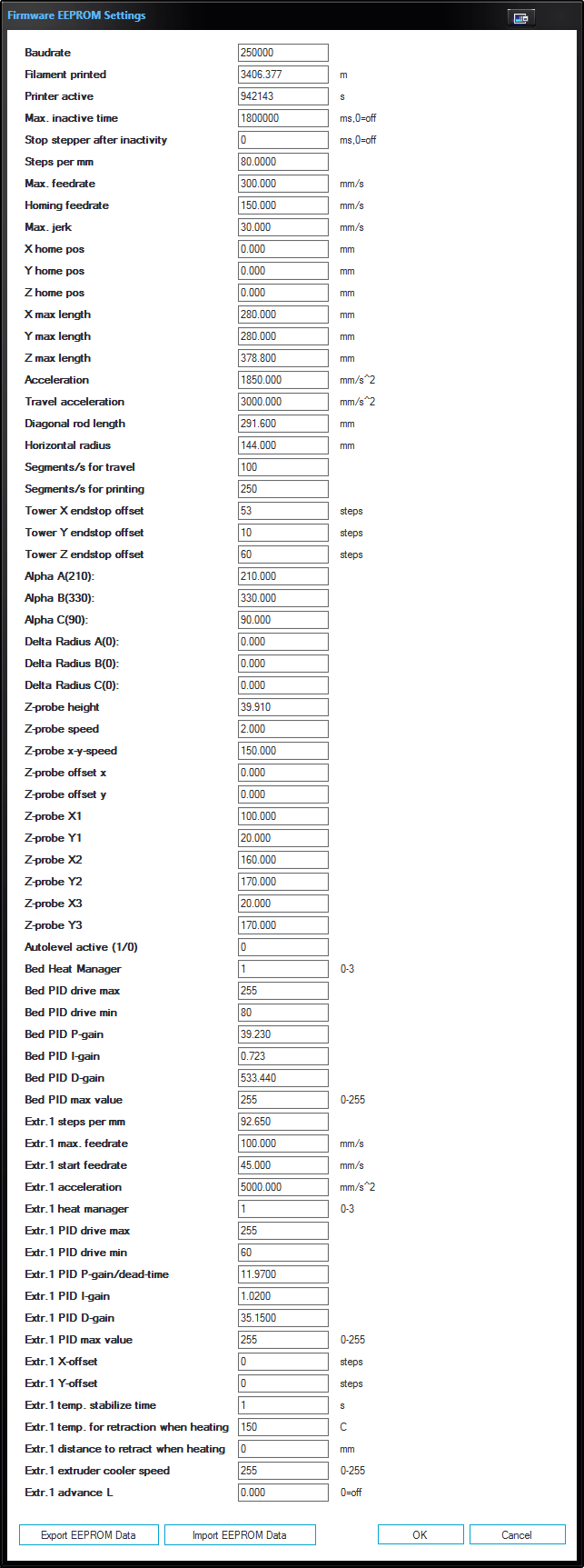

Post by SEBRET » Tue Jun 26, 2018 11:30 pm
screenshot of eeprom
