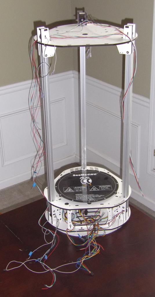

Okay . . . here I go again . . . resuming the process of completing my Rostock MAX™ v2 Desktop 3D Printer Kit
I have received permission to use the dining room table next week (because I have no air conditioning in the garage - thank you Ms. Sand)
The partially assembled printer is now on the dining room table
I'm in the process of finding all the parts (in the garage) and figuring out where I stopped building so I'll know where to resume
Here are the items I have for this build:
  • 1 x 84399, Rostock MAX™ v2 Desktop 3D Printer Kit - White, purchased Feb 21, 2015
  • 1 x 70861, Rostock MAX Ball-Cup Delta Arm Kit (new), purchased October 02, 2015
  • 1 x 70849, Injection Molded Cheapskate Carriage Set, purchased December 18, 2017
I'm mostly posting this for motivation - any encouragement will be most appreciated :)

Another modification I recommend is the 29A power supply kit - it's a big improvement over the ATX supply.
Good luck!
ULTIMATE 3D JEDDI
Posts: 1561
Re: Red Sand's Max V2 Build Thread
Post by Xenocrates » Sun May 20, 2018 3:24 pm
Sand, you're pretty darn close. Wiring a V2 relatively stock isn't that bad, and the new parts will only speed up putting the carriages, belts, arms, and hotend together. And so long as you make some progress every time you work on it, you'll eventually get there. I have a friend who had a V3 that sat with just the bed to solder, and the the firmware loading to do for over a year (He did move in the middle, and so earns more than a bit of slack). It didn't take long to get it running, and the first test print came out looking pretty slick.
In other words, there's not too much left to do, and the pay-off is nice.

hectori
Posts: 26
Joined: Sun Feb 01, 2015 5:48 pm
Post by hectori » Mon May 21, 2018 9:02 pm
I want to give you some advice.
I have a max v2 ​​and I have spent a lot of time calibrating it.
and I would like you to know some small details that have helped me improve my max v2.
since you have the max v2 ​​almost unarmed.
You should compare the holes of the towers in the wood.
why say this (in my case I found a misalignment, and it is very easy to detect just put one on top of the other and if there is misalignment you will see it immediately since you will see the holes out of phase in the center)
This happens because the laser cutter that works with belts which works like any laser printer is not so exact, giving a difference between x and y. (and even worse, the upper part is cut inverted and a diferent sheet giving us more misalignment, in my case I inverted it to help a little to have my towers completely parallel.)
just check the 2 sheets and you will notice. Do not forget to take a photo and upload it so others know.
Another simple thing to check are the towers.
my rostock is from 2015 and with the idea of ​​putting together another rostock max order bed and new towers in 2017 (and these new towers when I try new skates that I designed I found that they have a small difference that when you try the skate and turn the tower 90 degrees changes the dimension remaining difenrent tension.
When I checked my towers in my max v2 ​​2015 I did not find that anomaly.
Hector.
