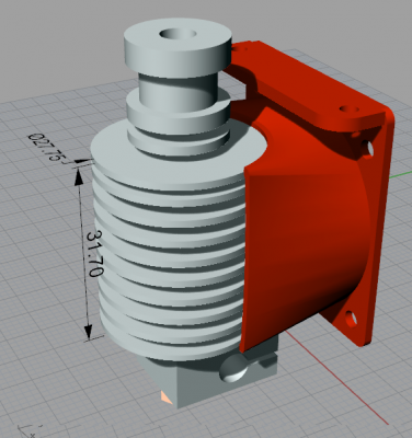

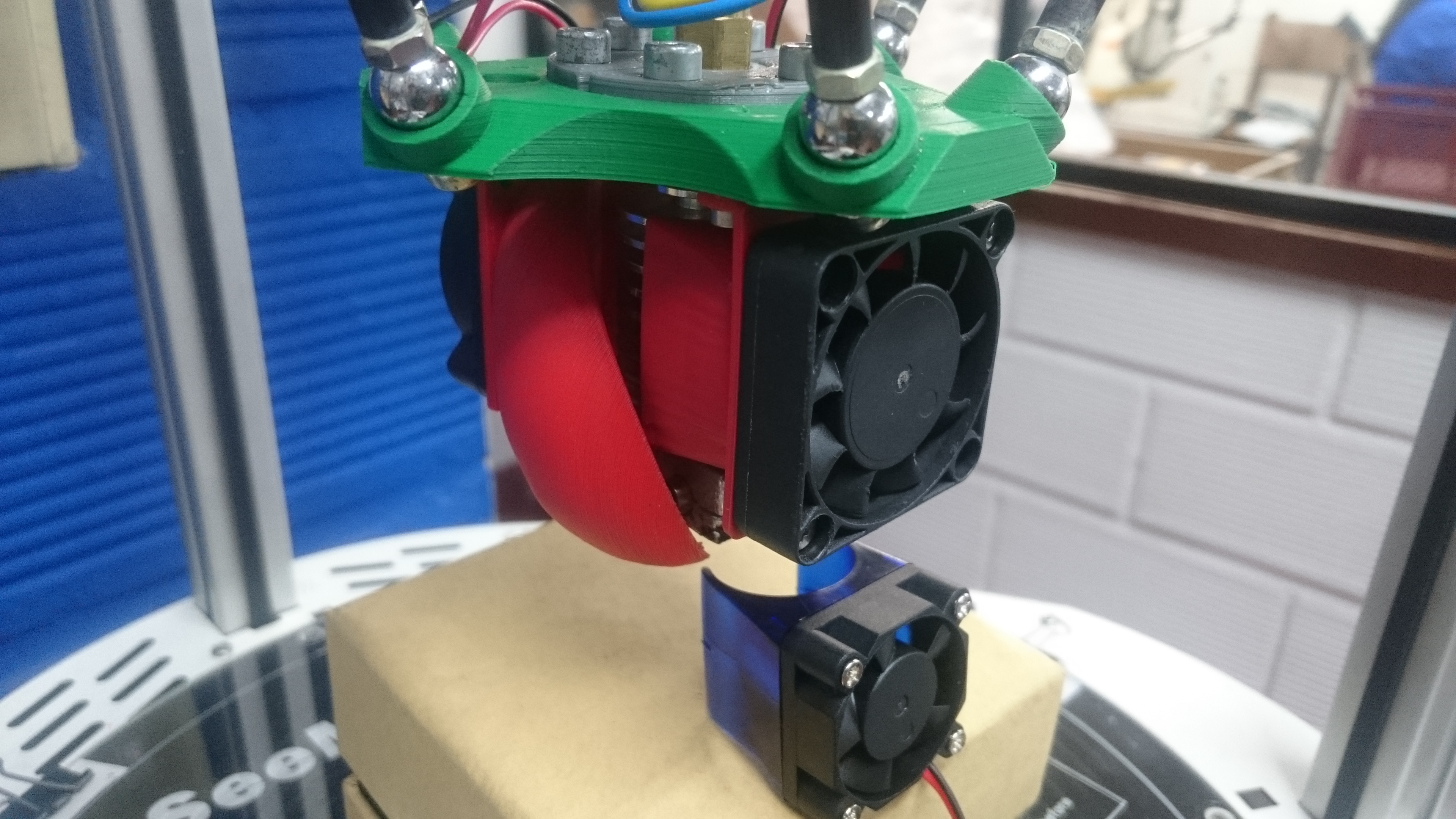

You need a good fan 40mmX40mmx10mm.
the 30x30 Does not have enough power.
Here is STL:
Fan40x40.stl
(4.36 MiB) Downloaded 11 times

The problem with 40mmX40mmx10mm fans is that they usually don't fit the mount. That means I'll have to put my hotend below the platform and I don't really want to change my setup. Will a 24v 30x30 fan do the job ?

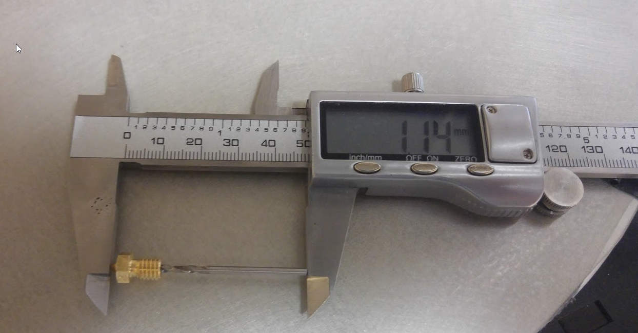

How old is your nozzle and is it original E3D? In some past Michael Hackney discovered that nozzles had a too long bore and caused a lot of jamming. E3D decided to adapt their design and made the bore less long. You can measure that by zeroing the length of a 2mm drill, shove it into the nozzle and remeasure like this:
I am sure Michael will comment when he reads this ;-)
I believe in the past we found some reaching 2mm and the PLA got cold before it left the nozzle.
