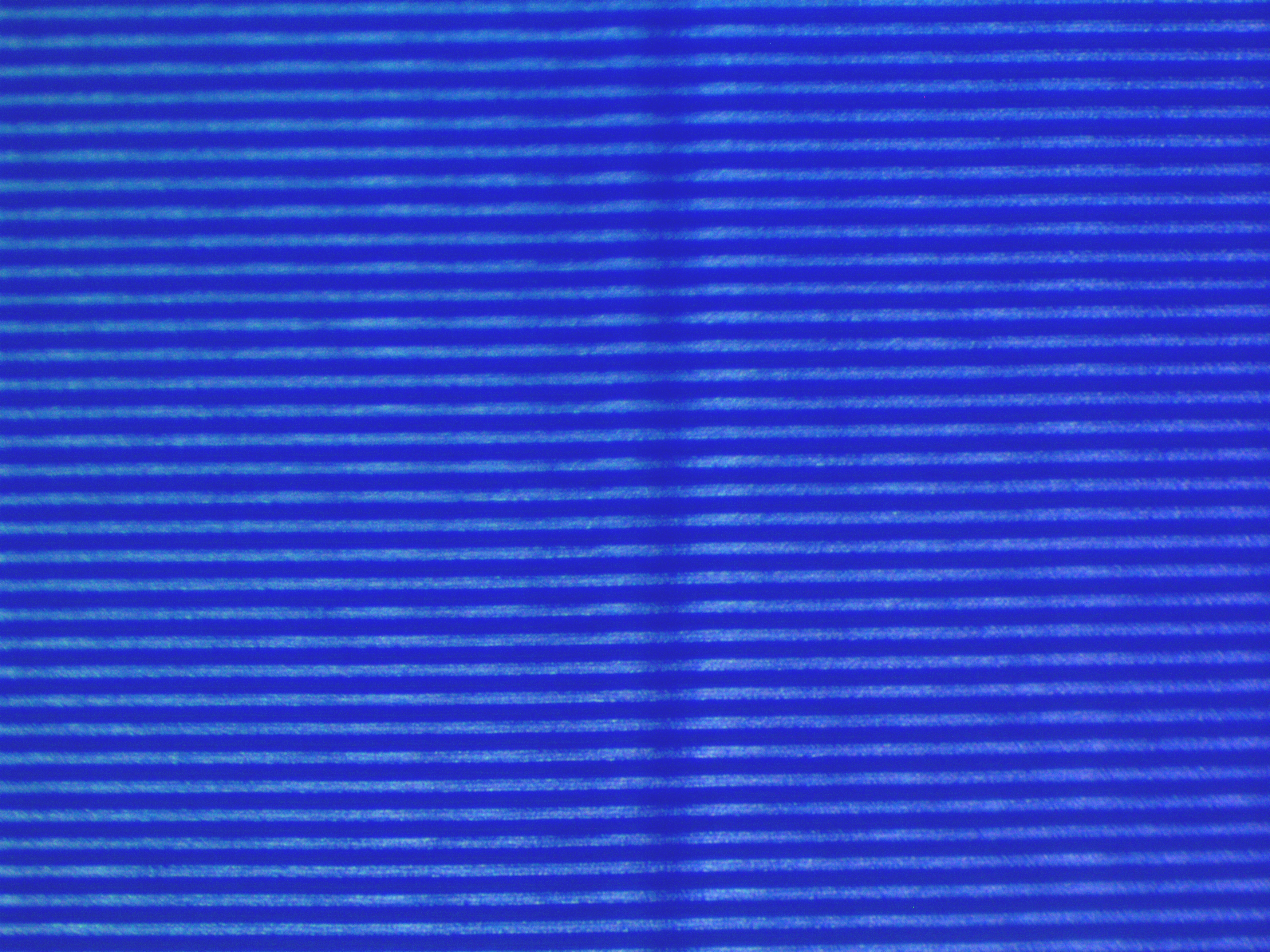

I've been doing a LOT of experimentation on this issue.
I'm convinced that the vertical lines you see here are not segments, but rather, stepping artefacts from the A4988 driver.
0110-m-p, can you try slicing the attached file in spiral vase mode, no need for top or bottom shells, with a layer height of 0.1618, and see if you still get banding? I'm assuming that your current steps/mm value is 80.
50x50x50.stl
(684 Bytes) Downloaded 15 times
Here is the result of some experiments I've been doing on this, the only change between these cubes is the layer height. I think these ridges are to do with decay mode in the drivers. Setting the layer height to a multiple of the golden ratio (once you figure out how much distance a full step takes) spreads the peaks out enough that they stop being visible.
Segments are very hard to observe, however I believe that these vertical lines are due to segments. Note that the segments don't always line up as you travel up the face of the cube.

The 0.1618 layer height is calculated as follows:
80 usteps/mm = 5 steps/mm (at 1/16 microstepping)
= 1 step / 0.2mm
Golden ratio * step size = 1.618 * 0.2mm
= 0.3236
Halve this to get a reasonable layer height:
= 0.1618 layer height.
The magic is in the golden ratio, it spreads out the single step peaks so that they don't line up with subsequent layers.
As you have 80.7 usteps/mm, the layer height you should use is:
0.1604 mm.
It's worth a try at least.

and a "golden ratio" version of 0.1618mmm
Code: Select all
G1 Z2.000 X24.820 Y24.820 E0.58277 ("2nd" part of Y+ move)
G1 Z2.041 X-24.820 Y24.820 E1.15507
G1 Z2.081 X-24.820 Y-24.820 E1.15507
G1 Z2.122 X24.820 Y-24.820 E1.15507 (X+ move)
G1 Z2.142 X24.820 Y-0.225 E0.57230 ("1st" part of Y+ move)
G1 Z2.142 F3000.000
G1 F3000.000
G1 Z2.162 X24.820 Y24.820 E0.58277
0.1618 height X+ face
0.1618 height left side of X+ face
0.1618 height centre of X+ face
0.1618 height Y+ face
0.1618 height left side of Y+ face
0.1618 height centre of Y+ face
