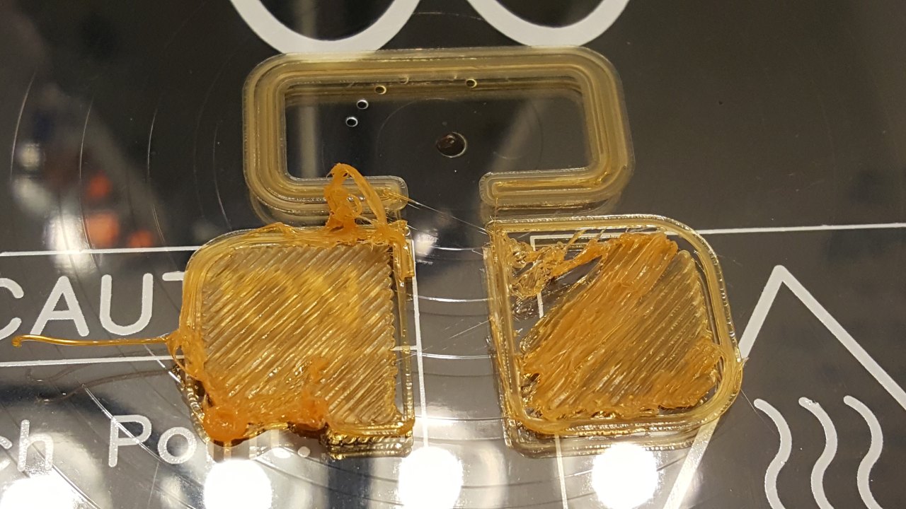

@geneb: I found 1 side had a very slight concavity to it, the other was without problem. So I marked the good side and it seemed to help some. I used a steel straight edge, and then switched to a piece of finished/highly polished) slate marble. I got it wet, and slid the glass on it from the side, covered with water. The concavity stood out very clearly (as a bubble that could not be "pushed" out), When the side with concavity was down it generated quite the vacuum when I pushed on it trying to remove it took a bit of consideration. The flat side, while it generated some vacuum did not "suck" down onto the plate when pressed. Also I do not have access to a raspberry pi at the moment, it is on my to-get list though.
@DeltaCon: I ran some tests and took some pics just to show. The first layer with auto calibration COLD, the first layer with auto calibration HOT, and the first layer with manual tweaks to the HOT auto calibration.
AutoCalibration with a COLD bed and nozzle. Printing with hot bed and hot nozzle.
AutoCalibration with a HOT bed, and hot nozzle (not actively heated at the time of calibration). Printing on hot bed with nozzle obviously hot...
Manual modification to the Z-Height via the navigation menu after HOT auto calibration.
These are items with SMALL foot prints, so far I have not had issues with small foot print items changing layer height across the bed. When my current print is done. (prob an hour or two). I will attempt a larger foot print item and see how the first layer goes down over a large area. I THINK it may be fixed due to a minor imperfection in the glass. I have manually tweaked it JUST a bit more beyond the pictures, but I think I'm dialing it in.
I'll keep trying to get it straightened out. I know I'll get there. I just would like to try to get my consistency up, and not have to tweak so much between changes. I have done a couple nice prints once I got it calibrated. (last time around).

Postby taggedzi » Tue Feb 07, 2017 8:56 pm
Sorry for all the "add on's" but I have tried printing something with a larger foot print at my son's request. My first print with the same settings as before, with NOTHING changed (I hadn't even moved the glass bed.) came out awful. I tried to manually adjust a bit, but that did not seem to help. So I auto calibrated twice, and ran again. When I saw the prints were coming out bad, I tried to adjust the Z height. It helped but I'm getting uneven results. One end of the bed is too far OFF the platform, and the other is squished down on to it. Here is a pic to show:
Auto calibrated Hot bed, hot nozzle. No elements in/on or near the printer were physically moved out of place. One end is squished (z tower) the other end is to high above the plate (x/y towers).
This is the type of thing I was getting before, and it was driving me crazy. I'm going to try flipping the glass over and make sure I didn't mark the wrong side of the glass when I found the concavity... but that is all I can think of.

Postby taggedzi » Thu Feb 09, 2017 10:12 pm
I have taken a step back, taken my time and re-measured and checked a lot. I cannot for the life of me get a good first layer, all the way around. I can get it good in one place, but not all the way through the plate.
Yesterday, I attempted to auto calibrate a few times. I tried the calibration wizard, and got 1 good first layer. But as soon as I printed something else, it was off again. So I completely disassembled the top of the unit and checked for anything lose, or out of place. Taking great care to make sure everything looked the way I thought it was in the instructions. I verified the extruded aluminum was touching the top of the brackets and was in very tight. I verified the screws connecting the Top assembly to the brackets holding the aluminum extrusions was in nice and tight.
Today I removed the hot end from the towers, cleaned the nozzle, and verified everything on there seemed to be right and connected it back up the way it should be. While I had it down I took the liberty to check the carriages. There was some play in them (in and out radially at the tops but it was minimal 1-2mm max... I don't know how much there should be if any) Basically the tops of them wiggled outward if there was any pressure applied outwardly, but they went right back into place if the pressure stopped. The adjustment screws on the top were about level to the top when calibrated (2 of them were even with the top assembly the other was down about 1mm, don't know if that makes a difference).
If it is still printing poorly tomorrow I'll disassemble the base and try there...

Postby geneb » Fri Feb 10, 2017 8:05 am
Matt, I'd check the carriages to make sure the screws are fully tightened. There's a gap of about ~1mm between the carriage halves when it's fully tightened. I just checked mine for motion and there's a tiny bit, but requires a non-trivial amount of force to move.

Postby taggedzi » Sat Feb 11, 2017 5:26 pm
@geneb
Thanks so much. I checked the carriages, 2 of the the screws were "tight" hard to turn, but not fully seated on the X-axis carriage. I tightened them all the way down, and it has helped significantly. I autocalibrated, then used the calibration wizard on the site and it has got SO much better. I'm was getting a bit of "feed" inconsistency too, that was causing a problem. I opened up the extruder and found that there were a good deal of shavings up there, I blew it out, and turned down the feed rate just a touch on my prints. And so far... (fingers crossed) the first layers are worlds better. Still not perfect, which I figure I'll always have to "shoot" for, but I'm thrilled with the results now.
I also did adjust the z-probe height to -0.18 and now calibrate cold, and that seems to get me almost perfect first layer height.
