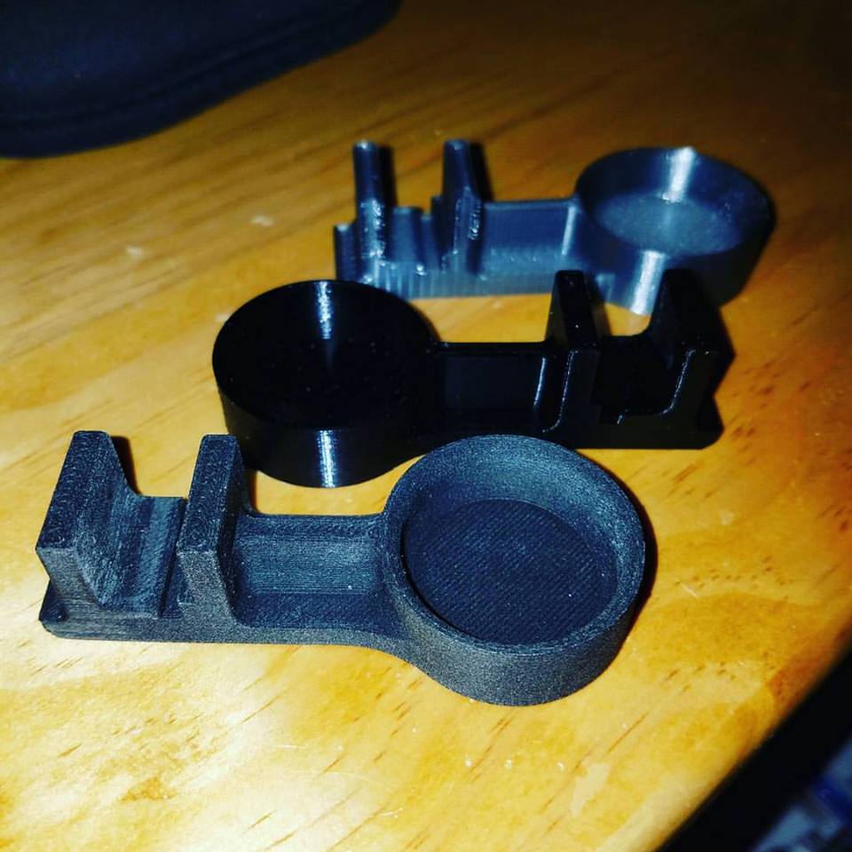

I used matte black HTPLA from ProtoPasta and I had great results with a few strings but the finish is outstanding. I did use temps of 215 first layer then 210 the rest of the print, bed at 70, 25mm print speed, 4mm prime/suck at 25/50mm/s with 5mm wipe and Jump 0 Trigger 2 in Kisslicer. I heat treated the part in a toaster oven but didn't notice much change so I will test it in the real world soon.
