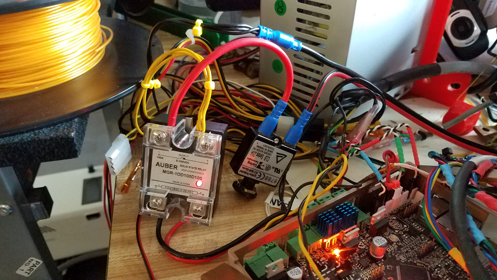

Here's a question that keeps bothering me. Why is it "right" to put the SSR on the ground side of the circuit, and "wrong" to put it on the hot side? Isn't it safer to gate the hot side?
BTW, I fired up the Onyx with this SSR. It took about 20 minutes to get from room temp to 75C. The Onyx has a thick GeckoTek aluminum plate on it (great heat spreader), and borosilicate glass clamped to that plate with binder clips. The glass has a folded-over dish towel during the warm-up phase. The wire nut is a little warm. The heat sink contact area of the SSR is barely above room temperature, which concurs with what Auber says on their site (can run without a heat sink with a 12V/10A load). I think the full-bore heating load is about 11 amps. I did order a heat sink, just in case.
Seems like the PID needs to be re-done. The temperature keeps wobbling.

626Pilot wrote:Here's a question that keeps bothering me. Why is it "right" to put the SSR on the ground side of the circuit, and "wrong" to put it on the hot side? Isn't it safer to gate the hot side?
It's neither right nor wrong. It should work on either side of the circuit, so long as you can keep the correct polarity on the SSR.
When telling someone else how to do something it's way easier to pick ONE solution and document that. Some people work better when given an exact solution, especially if they don't quite understand it. Doesn't mean there aren't a dozen other ways to do something.
It's safer to FUSE the hot side. The SSR isn't a fuse.
I agree, I would put an SSR in the hot side of the bed circuit.

dc42 wrote:I agree, I would put an SSR in the hot side of the bed circuit.
I thought so. If the bed has +12V of potential even when the heater is supposed to be off, it's one more way for a short circuit to make something bad happen.

IMO a 350W MeanWell PSU is more than adequate for a single extrusion machine. Your bed heater takes 132W at present, so about 180W when you turn the voltage up. If the hot end heater is 40W then it will rise to 54W at the higher voltage, so we're at 234W. The stepper motors, electronics and fans will take less than 60W. So about 290W total and you still have 60W of reserve when everything is running at full power.
Just to be clear, we are talking about a 12V-only PSU here. With ATX PSUs the power is split between different rails and other considerations apply.
Turning the voltage up to 14V also increases the voltage to the fans. In theory you should connect a couple of silicon diodes in series with them to bring the voltage back down to 12V.

Just a friendly reminder about voltages and wattages.
The V3 Onyx bed heater is about 0.9 ohms, so with a 12V power supply you see about 11A of current at full power for a total of about 140W.
Now, if you switch to 24V you will double the current to 22A and quadruple the wattage to over 500W. This is why you need a 600W 24V power supply, AND safety devices to keep the bed from overheating. With 24V heating my bed can easily achieve well over 150C if not controlled by a SSR.
In order to sleep more easily I installed two 150C thermal fuses under the Onyx bed in the well where all the wires are connected. I put them in series and glued them to the Onyx using Permatex ultra copper silicone for good thermal contact. I also added a thermal fuse in thermal contact with the heat sink of the SSR in case it overheats--but it rarely even gets warm. All thermal fuses are in series so if any one of them trips the whole string goes dead. Since the thermal fuses can't handle the 20A load of the heating current, I use current through the fuses to close a normally open relay. All the 24V power to the SSR and bed heater go through the relay.

Switched the SSR to the hot (+12V) side of the circuit, and added the Blue Sea Systems 25A breaker to the circuit.
Wiring is now:
+12V -> SSR+
SSR- -> Breaker's "Line" terminal
Breaker's "Load" terminal -> Onyx+
Onyx- -> blue crimped pin gizmo -> GND
The pin gizmo is throwing off less heat than the wire nut, and the back of the SSR is very close to room temperature. The circuit characteristics have changed enough that PID control keeps overshooting, so I have to finesse that back into shape.
I have also adopted a safety protocol that I learned the hard way, last week. I had the high-current wires on the SSR reversed, and when I turned on the PSU, the heat sink got very, very hot within a minute. This was WITHOUT the heater being turned on in the controller! I had wired it backwards, and apparently, that's what an SSR does when you do that. They are NOT bidirectional! From now on, any time I touch the SSR wiring, I will turn on the PSU (without turning on the bed heat on the controller) and keep my fingers on the heat sink for a minute. If it doesn't get hot, I probably got the wiring right.
What's a good source for an appropriately rated thermal fuse? All the ones on Amazon are either too low in amperage, or just say "Dryer" and have no published current/temperature rating.

Okay, this is interesting! After hand-tuning the PID variables, the heater is staying within 0.1C of set point, almost always exactly 75.0C, AND I don't have to lower the max PWM like I did before. I put that variable back up to 255 (maximum value), and it works fine. I think putting the SSR on the +12V side of the circuit is doing something to the electrical characteristics that makes it easier to hold a steady temperature than when it was gating the ground side. Maybe there is some kind of "inertia" going on.
The temperature control is very nearly as stable as it was when I wasn't using an SSR at all. In this configuration, my guess is that standard deviation is less than 0.01.
