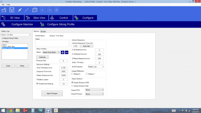

Postby jlmccuan » Sat May 30, 2015 9:05 am
I've had no problems with the timing in CW. The first layers' times and subsequent layers each have their own timing and don't require any editing for everything to be right on with regards to the exposure, retract and return to the next layer. For one resin I use I have a 12 second exposure for the first layer and then 4.25 seconds after that. There is no dead time in the shorter exposure layers. As soon as the projector goes off the platform lifts and when it comes back down there is no delay in the projection of the next slice. Am I not understanding the OP's problem?
Here are the CW settings for that resin.
