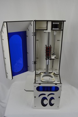

It arrived today and I'm starting to take photos and build. Ahhh, I miss that smell of laser cut melamine and the pleasure of pealing off the protective film!

Hmm, I didn't get a resin vat with my kit - or at least I didn't find it anywhere.
I've almost got the main shell together. I'm dry fitting everything as some pieces have a specific orientation so I may have to change them around.
The photos on the SeeMeCNC site have some great hints but that "zoom-scroll" thing is a PIA! So, I downloaded the images. Here they are to save you the trouble.

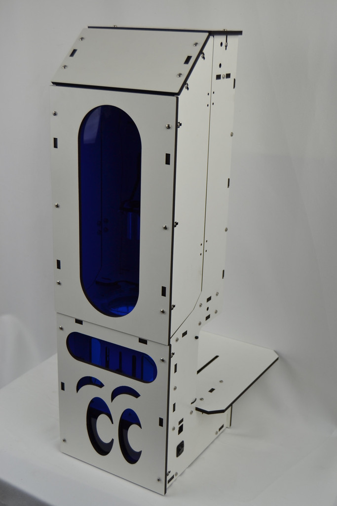

Postby mhackney » Sat Aug 23, 2014 8:05 pm
Mechanicals complete, electronics wired and unit tested. Now I need to upload the grbl firmware and test things out!

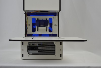

You might have to remove the focus stop, I can't get a good idea of what the focal distance is from the droplit images. With it in place the minimal focus distance is about 8 inches. With it removed it's less than 4.
I did some quick tests with the projector and it cured maker juice resin without modification, probably not a bad idea to remove the color wheel anyway.

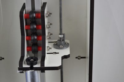

Got the acrylic parts in my kit. Following mhackney's build thread, I was able to unpack and build up to the end of his thread in a total of 3.5 hours. Some notes: The projector plate was a very tight fit to the sides; I had to trim material from the tabs and holes on both sides to get it to fit. Dry fitting the very top and the lower front plate also required some adjustment in the tabs too. Otherwise trying to force them would probably break something. Once together, the cabinet seems quite rigid. Tomorrow I plan on finishing the build and wiring the electronics. Will update the thread with some pictures and any observations during completion.
