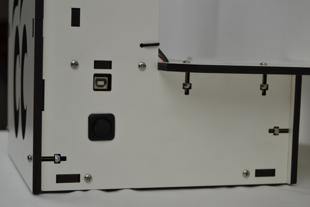

Hmm, I didn't get a resin vat with my kit - or at least I didn't find it anywhere.
I've almost got the main shell together. I'm dry fitting everything as some pieces have a specific orientation so I may have to change them around.
The photos on the SeeMeCNC site have some great hints but that "zoom-scroll" thing is a PIA! So, I downloaded the images. Here they are to save you the trouble.

						My beta DropLet is assembled!
[img]http://mhackney.zenfolio.com/img/s5/v12 ... 5513-3.jpg[/img]
Mechanicals complete, electronics wired and unit tested. Now I need to upload the grbl firmware and test things out!

And the big news - I have motion! I had to get the latest grbl and compile and flash it. The SeeMeCNC supplied hex and re-compiled source did not work.
