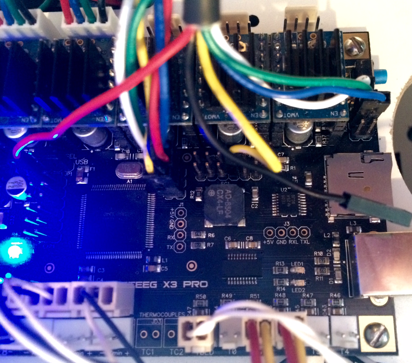

I'm trying to set up my VIKI so I can use the microSD card reader. I have everything connected as per Panucatt's documentation but only, the Chip Select line (CS red on J3 on the VIKI (version 1) is shown going to 1 of 2 pins on the X3Pro that do not exist! Intact, the X3Pro drawings on their site also do not show this pin (#53). I am going to use one of the digital pins n EXP3

It does exist. Currently there is a jumper on it, its for SD communication related stuff. Remove the jumper and connect it like shown in the first link. On the X3 Pro drawing its shown as a red octagon, right above J3 in that drawing.

Tyhe drawing on the X3 Pro page doesn't show this and here is a photo of my board - which does not have it:
Am I missing something? I tried using one of the open digital pins on EXP3 - pin 35 - and configured Repetier for that. Still no joy. The VIKI instructions also say to remove J12 from the back of the X3 Pro. I completely removed my card and scrutinized it with a magnifier and there is no J12 jumper or pads! You can actually see all of my hook ups in the photo above and except for the CS (red) wire, they match the VIKI setup page. I used pin 35 on EXP3 for CS.
My board looks like the drawing on the X3 Pro page: http://files.panucatt.com/datasheets/x3pro_wiring.pdf and not the drawing on the VIKI page that shows how to connect to the X3 Pro: http://files.panucatt.com/datasheets/vi ... iagram.pdf

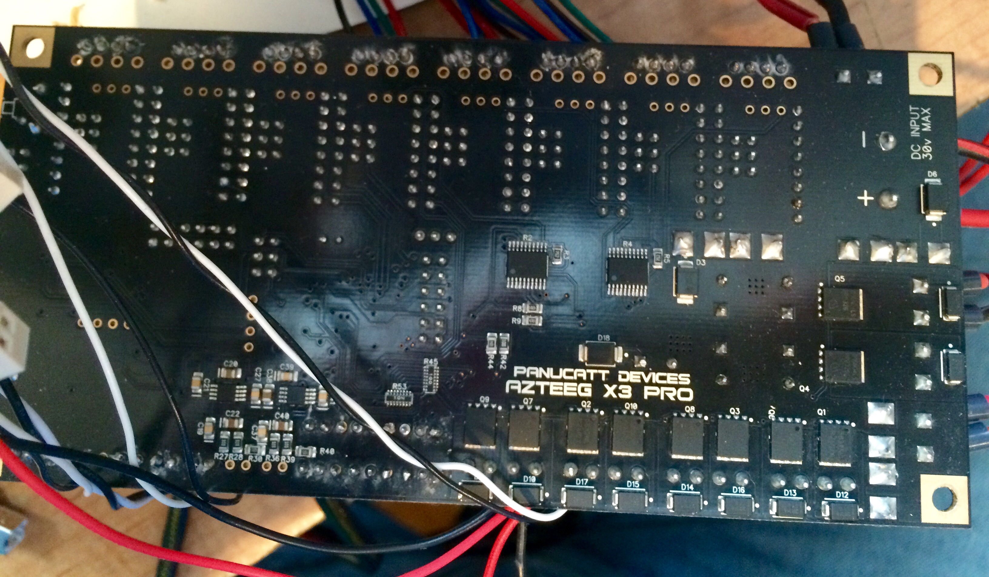

Guessing yours is a V1.1 or something along those lines? Mines a V2, I have the jumper on the top of the board. You didn't see any bridged solder pads or anything underneath the board? Could you take a picture of the bottom?
If yours is older than the V1.1, it could be a possibility that your board may not be compatible with the SD card on the LCD. Mine actually broke when a wrench fell onto my Viki and hit the SD card. Probably some broken solder connection, but I've been using the built in reader since.

Mine likely is a 1.1 or even 1.0 since it was one of the first batch. I do not have any sort of solder pad on the back side - I scrutinized it with a magnifier. I see how the X3 pad looks so had some idea what to look for. Nothing labeled J12 either. I've written to Roy to see if he can help. I took a photo of the backside while I had everything disassembled:

Postby Nylocke » Sat Feb 14, 2015 12:44 pm
Probably a V1 if its from the first batch. May be too old to be compatible, at least in terms of that guide. Roy may have a workaround or an offer, considering when I got a faulty Viki they replaced both the Viki and the X3 for free.
