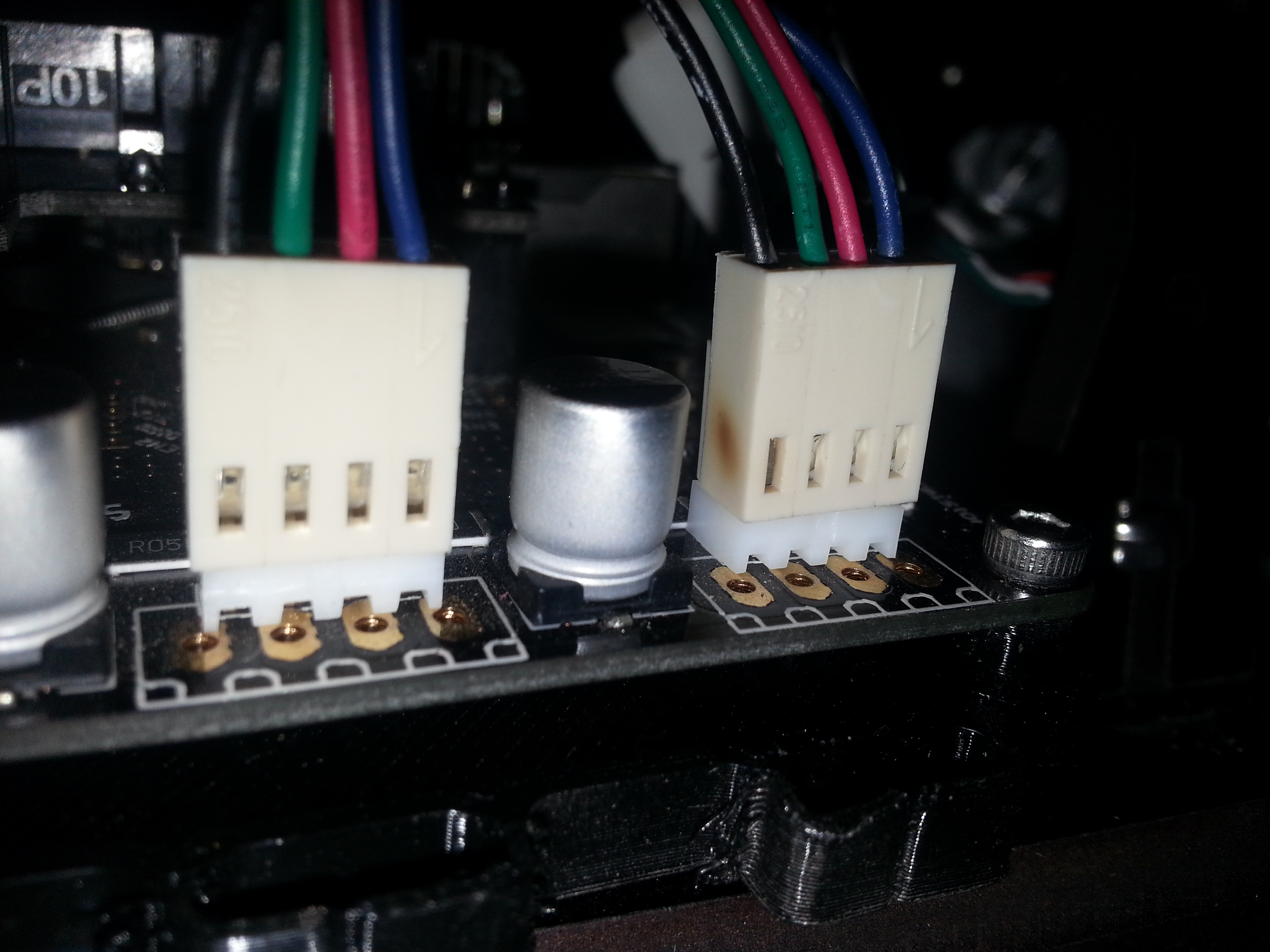

Poor connection or something else going on?
Post by KAS » Thu Mar 03, 2016 6:02 pm
The pin connection is burnt a bit. Sign or of a loose connection or is that capacitor getting hot?
forrie
Posts: 159
Location: Crab Nebula
Re: Poor connection or something else going on?
Post by forrie » Fri Mar 04, 2016 2:59 am
Pop the black pin out and have a look inside (and the pin) , should give you the answer
TheIrishScion
Posts: 56
Joined: Mon Jan 18, 2016 5:44 pm
Post by TheIrishScion » Fri Mar 04, 2016 3:43 am
KAS wrote:Sign or of a loose connection or is that capacitor getting hot?
Loose connector, capacitors don't get hot like that. Well, not for very long, and you can tell they did because of the exciting bang they make very soon after they start ;-)
