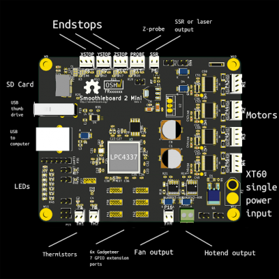

This blog post was put up on November 19. There have been some big changes!
SB2 Mini design:

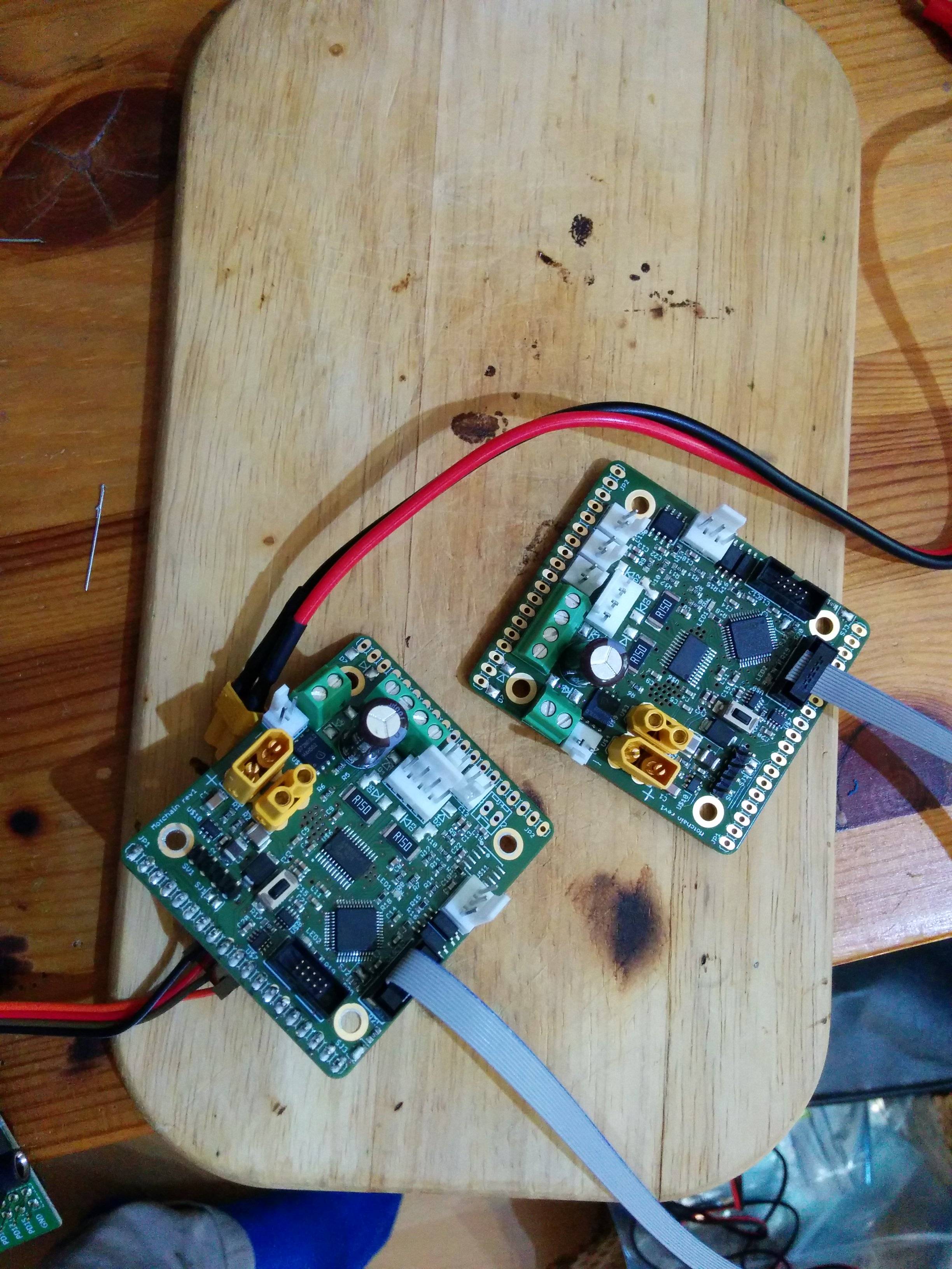

Hot end expansion boards (stepper driver + hot end power + thermistor + filament sensor), running on the CAN bus, which can be daisy-chained:
Highlights:
  • There is an updated SmootheBoard 1.1 with 1/32 Allegro drivers coming out in a few weeks
  • v2 will run on an LPC4337 @ 204MHz with 264K RAM (v1 had 64K) and 8MB ROM (up from 512K, I think), hardware FPU, SDIO, and an M0 co-processor
  • Smoothieboard v2 has been delayed by mbed's incomplete HAL, but they are making good headway now. They already have a prototype driving the FirePick "overhead delta" pick-and-place/3D printer. They are working on hiring full-time developers to finish the port, and to work on an RTOS port in the future
  • SB v2 will come in regular, Pro, and Mini trims
  • v2 Mini will be as cheap as possible and have 4 of either either Allegro or Hero drivers, and you'll have to solder the connectors yourself; also only one hot end FET and one SSR/Servo connector, 3 endstop+1 probe connectors, no multi-extruder CAN, extra USB port (thumb drive), and no Ethernet
  • v2 (regular) will have 4 Trinamic stepper drivers, 1 bed FET, 2 hot end FETs, 2 SSR/Servo connectors, 6 endstop+1 probe connectors, multi-extruder CAN (see below), extra USB port, and Ethernet
  • v2 Pro will have 5 Trinamic stepper drivers, an FPGA, 2 bed FETs (why?), 2 hot end FETs, 4 SSR/Servo connectors, 6 endstop+1 probe connectors, one DAC, multi-extruder CAN, extra USB port, and Ethernet
  • The problematic Molex power connectors (just replaced a melted one two days ago) are being replaced with XC30/XC60 connectors, like you see on RC applications like drones - big cheers from me on this decision
  • Edison port dropped (good choice, in my opinion)
  • Gadgeteer-compatible expansion ports added - you can use these to connect an Edison, Raspberry Pi, extra stepper driver boards (planned), cameras, sensors, LCDs, or whatever - this is like having a GPIO header, except much more flexible, as each connected device gets its own port (you don't have to figure out how to split them up or use a custom PCB to break out the wires). The v2 Mini has six of these ports, and the regular and Pro boards should have "as many as possible"
  • Stepper expansion boards will run on a CAN bus (like in your car) with an extra STEP signal, can by daisy-chained to have "infinite" drivers, and use the same XC-type power connector (each has In and Out connectors). Each board has a stepper driver, "hot end" (presumably power FET + thermistor input), and a filament sensor, which is legit as hell. The boards are being developed by Kliment (author of Pronterface) and appear to have their own onboard CPUs, which makes sense, because they have to talk to the CAN bus and send/receive/forward serial data
  • JTAG port (unsoldered) for debugging
  • They want to hire Thomas Sanlander, famous hardware reviewer for YouTube, to do tutorial videos
I think it was a good idea to drop the Edison socket, and a better idea to add the Gadgeteer interfaces. All an Edison (or RasPi) really needs to talk to the controller is a serial line of some kind, like CAN, I2C, or SPI. It doesn't need 40 or 80 pins just for that. Because each Gadgeteer interface stands alone, there is never a question of where to plug something in, or whether it has to have custom jumper wires running to a pin here and another pin there.
This really does seem to be shaping up to be the Cadillac of 3D printing controllers, and I am DEFINITELY getting one as soon as I can! This is doubly great for me because I was thinking about developing my own CAN-based, daisy-chainable solution for running extra hot ends. Now I don't have to!

Their CAN implementation has an extra differential STEP line. The bus can run at either 1 or 8 Mbit/sec, depending on which controller they use. Even at 1Mbit, the math isn't too bad. The frame size (if you want to send 8 bytes) is 108 bits (13.5 bytes). That gets you a destination address and CRC for error correction, and the protocol handles error correction (resend) and congestion for you. At 1MBit, you can send 9259.259259... frames per second. Enough to run 8 external steppers at 1KHz update speed if they use all 8 bytes to tell them what to do. If the data they send is a 32-bit packed dir/float (1 bit dir, 31 bits step frequency) then they can run 16 external steppers. If they can get away with a 15-bit frequency, that means 32 steppers. That begins to get into android-type robot territory, similar to using DynaMixels but possibly cheaper per unit of torque delivered.
In fact, that gets me thinking...
Because each stepper expansion board has its own controller, it would also be possible to send the mathematical description of the required movement (line or Bezier curve) to each controller, and then let it generate steps locally. If someone develops a general robotics expansion board for Smoothie 2 - no printer stuff like hot end heat, but an encoder input, perhaps IMU (accelerometer/gyro/magnetometer) and some kind of torque sensor as well - the board can probably be made small enough that you could integrate it and an encoder with a stepper, and it can send the IMU/torque readings back to the Smoothie controller, which can supply it to whatever application is driving the robot. That would help the controller keep the robot balanced, if it's the kind that needs to walk, and help it avoid breaking eggs or damaging its own joints. With that method (sending a definition of the curve rather than every individual step), the CAN bus could drive several dozen motors without running out of bandwidth on the bus, and have plenty left over for IMU/torque feedback. Since they already have a separate STEP line, the different controllers can be kept in sync, maybe with a PLL in case there is any tiny drift in clock speed between the expansion boards. This feature could make the SB2 Pro very attractive to people who want to develop quadrupedal, humanoid, or other robots with highly complex articulation. (Wonder if they thought of that?)

dc42 wrote:- CAN bus peripherals is interesting, because it's something we had already decided to implement in Duet WiFi 2 (we looked at RS485 too, but CAN is simpler because so many microcontrollers support it directly).
We are not actually doing CAN fully. It's "electrically" CAN ( with an additional step line ), but on the software side it's going to look much more like RS485.
dc42 wrote:Also you have to be able to send details of the next move over CAN before it starts, so that the drivers know at which step to switch the direction signal.
Actually, by definition ( because of acceleration ), direction changes do not happen at maximum speed, so that's very much manageable, we don't even need to send moves in advance.
It's all experimentation of course, we might run into trouble along the way :)

dc42 wrote:Instead of a differential Step line, I would look at using use a differential Start Move line. Then the same signal can feed all the expansion boards.
We plan on having the same step signal feed all the extension boards.
The faster one gets the step pulse, the other follow it at a given ratio they have been configured for.
This works both for extruder systems where only one runs at a time, and for systems where multiple extruders run concurrently but they have a fixed ratio between them. This covers all the *currently* used multiextrusion systems. It won't work for a system where ratios between the extruders vary live ( though it might ), but we'll worry about that when somebody actually builds a machine that has a use for that.

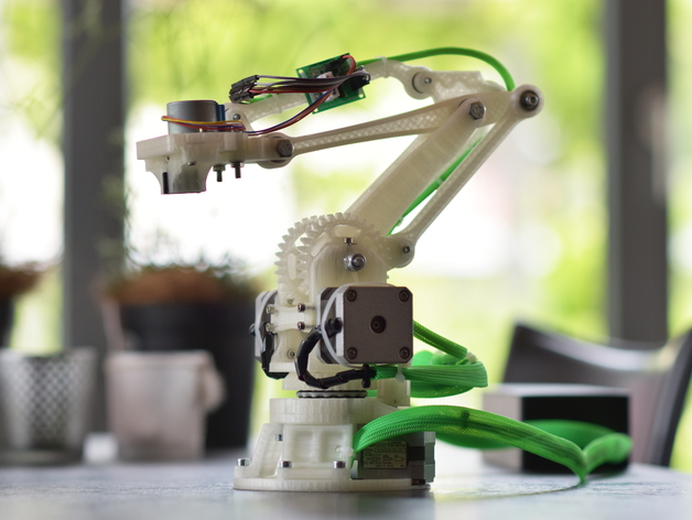

Slightly offtopic, but do you know if anyone is working on an arm solution for "desk lamp" type articulated robots, like this one?
arthurwolf
Posts: 21
Joined: Sat May 24, 2014 3:36 pm
Re: Smoothieboard 2 Progress
Postby arthurwolf » Wed Jan 11, 2017 10:58 am
626Pilot wrote:Slightly offtopic, but do you know if anyone is working on an arm solution for "desk lamp" type articulated robots, like this one?
I've talked to at least 4 different persons working on adding that to the Smoothie code, but I don't believe any of them have any public code yet.
It's one of those things that will happen at some point, but hasn't yet.
