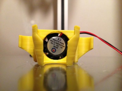

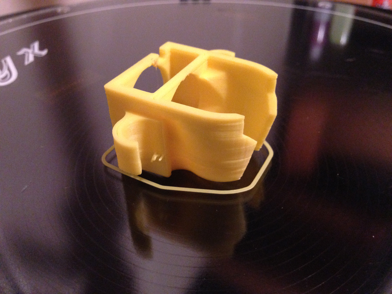

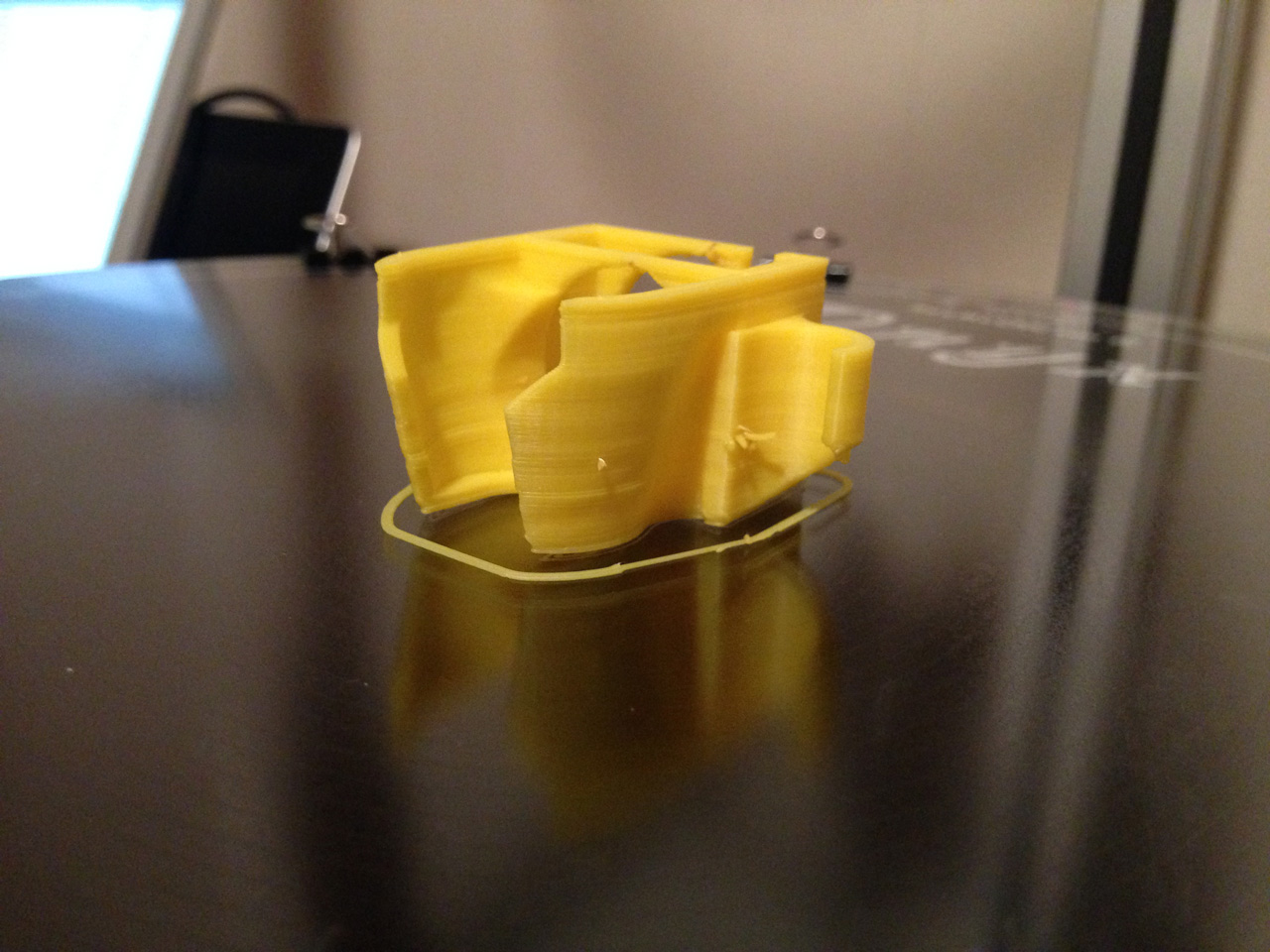

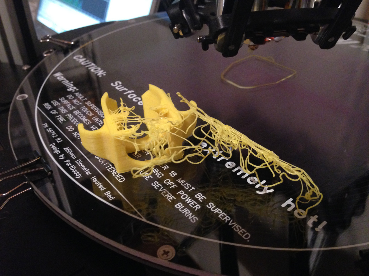

Did have some problems using the gluestick to keep the ABS from peeling off, so after two unsuccessful attempts I used Aquanet and it finished with no problem.
Whatcha think?

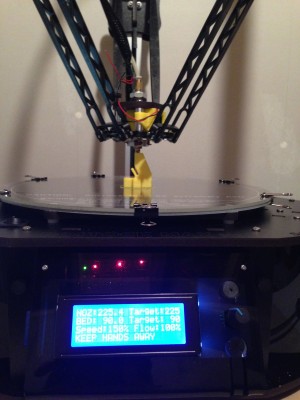

And for a few laughs
That is pretty cool. I'm guessing that's produced from the slicer he's using? If I remember correctly, Slic3r gave you a time countdown for the print where Cura gives you a percentage. Maybe an updated version of Slic3r gives that message?Eaglezsoar wrote:I love the mod you made to the display, Keep Hands Away.
Thats helpful info, thanks.esbowman wrote:I think 3DR is right. Must be out of the box that way.

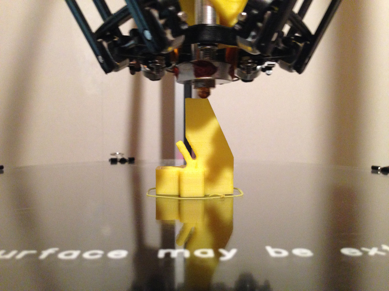

Regarding Slic3r, I actually updated because the version packaged with Repetier Host Mac was outdated, and I was getting memory errors on a fairly high resolution mesh I was slicing. So I updated to the latest stable Slic3r from their site (1.0.1) and it blasted through the model with no problems.
For those unaware, be sure you go to Repetiers preferences and point it to the Slic3r app you manually installed, otherwise it defaults to using the version it ships with. Took me a few minutes to get that right. Printing something for my 3 year old son now.
