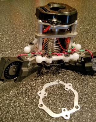

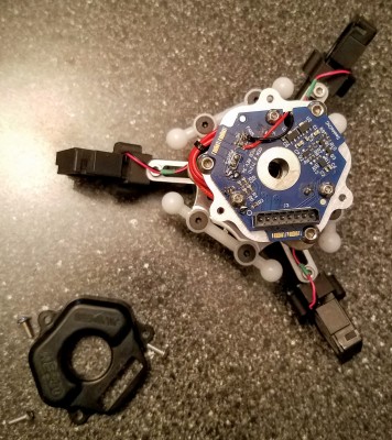

Finally got the probe board mounted up with a Prometheus hot end.
The probing works well, I am impressed.
Sure is quick and easy to swap heads back and forth from stock to Prometheus, thanks to the ball joints, plug on board and auto calibrate :D

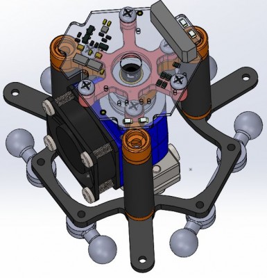

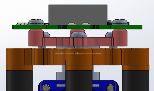

I haven't gotten my accelerometer board wired up yet, but I made a 3D printable mounting solution for those with the 713Maker hot end hardware.
I should have the STL posted up to Thingiverse shortly. I printed mine in ABS. All it needed was some 8mm M3 bolts to attach the probe board to the mount.
Edit: Here is the Thingiverse part

Our V3 came in today and we are milling the first prototype adaptor ring tonight. By the end of the week we should have them in production if all goes well and shortly thereafter also a solution for the stock V2 hotend folks (if any are left out there) to work with our mounts and effectors. We will also shortly have a full metal effector/mount for the HE280 hot ends as there are a number of reports that a metal effector tends to flex less and give better calibrations.
The new adaptor is full metal and of course can be anodized to any of the colors we offer. It offers a firm mounting for the HE280 calibration board and we are hoping to keep the price in the $5-8 range. It will of course be an option when buying one of our kits just as all our lock rings are currently.
