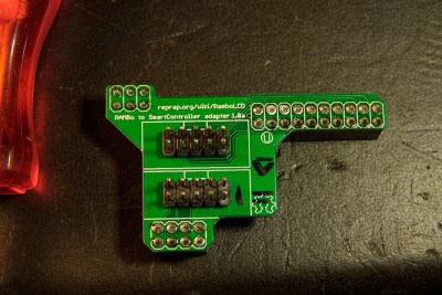

That sounds like you've got a cold solder joint on the LCD adapter board, or a solder bridge across a couple of pins.

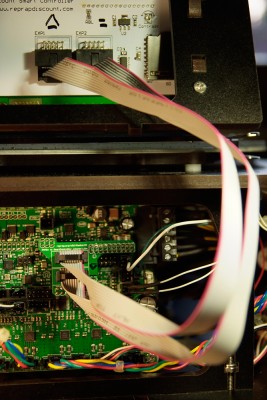

Hello
As promised, here are the pictures

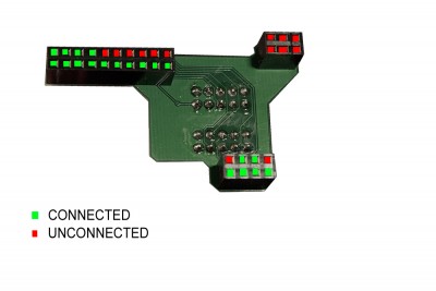

I also added an image with the pins where I could find out which pins are connected, ecxactely 20, and which not , 14 pins.
So I think this count fits perfectly the count of the connector pins of the LCD, but maybe you can see which one is a problem ?
I did a simple test, I took an Ohmmeter and stuck a resistor in every pin and I`ve tried to find the counterpart pin on the LCD Connector , so I could see which one is connected and which one not.
Today I also played a little bit with the navigation dial, and it works , because I could activate the hot end and the bed to heat. Even without any information on the LCD
So as I wrote, the LCD has its blue light, and the pixelblocks are visible.
So I guess its the Rambo which doesnt know that it should give the LCD the informations for the display.
So what ist the origin of the problem.
Firmware
Cold solder joints ( I guess not )
Thank you in advance, Christoph.

If you want to contact SeeMeCNC you should probably send them an email, John does post here occasionally, but it's infrequent, this is predominantly an end user forum.
As the the LCD, it could be bad wiring, or a bad LCD panel, the latter does happen.
