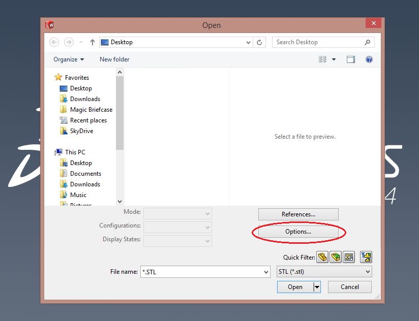

Stl files are generally a crapsoot. I wish people would post igs or step files as well. When you open them hit options and change the units.
Right click on the import in the feature tree and try import diagnostics to see if you can fix it. I will try that model in sw2014 in a bit.

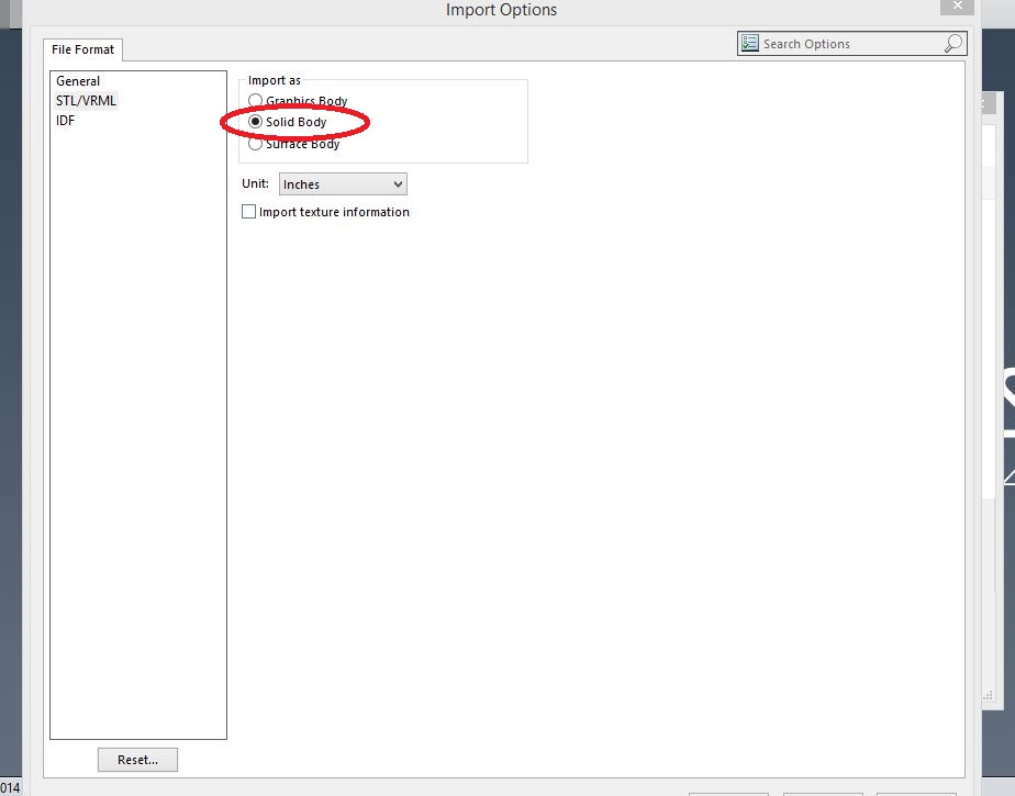

Have you tried pulling it in as a solid? http://grabcad.com/questions/how-do-i-c ... lid-model#
In those same options, change the units to millimeters.
It'll give you a solid and a surface for that file, its just the nature of a STL file, they are just surface triangles and are pretty poor.
For future reference, when you save a solidworks file into a STL, hit options and you can change the deviation number to something smaller so you have shorter line segments rather than long choppy segments.

I use Solidworks 2013 and pull in .STL files to modify them all the time. I do it for both 3D printing objects and also for cutting out on my CNC mill. It is a bit late tonight, but as I recall I import it as a solid object in the .STL import options tab. Then I do feature finding (pretty much automatic) and end up with a solid part in Solidworks that I then pretty much do with as I please. I have brought in .STLs from Thingiverse and then worked on them for the changes I wanted, then just saved as an STL again and printed them out just fine. I just did a google search on importing .STL files into Solidworks and it works good for me so far.

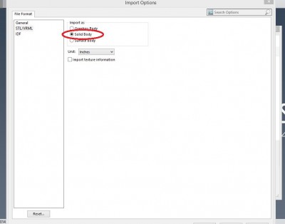

Importing STLs as solids into Solidworks is pretty simple. Check the screen captures. As far as modding whats there i.e. adding bodies to bodies, that is pretty simple too. Say you have three different files you'd like to combine into one part. Import all the STLs as solid bodies as separate parts. Then save each file individually as a solidpart file. Then open anyone of the three files and go Insert/Part and translate the parts to where you'd like them to be. Once you're satisfied with the position of everything you can then use the Combine feature and do exactly that, combine all three bodies into one solid body. From there, export as STL and you're ready to roll.
