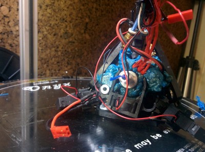

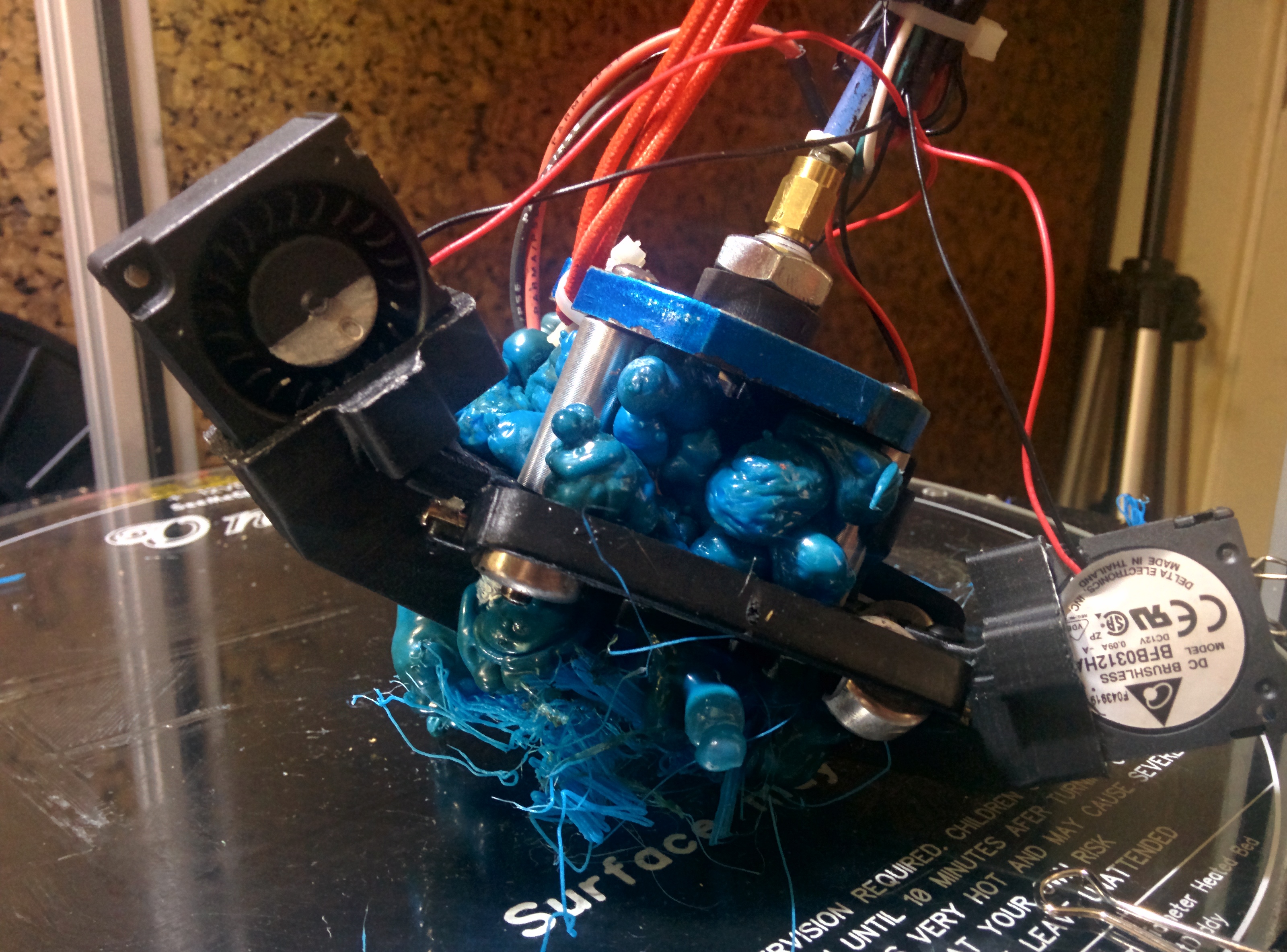

10 hour print with weed trimmer line, gone wrong. One set of arms detached themselves. Y'All have a wonderful day.

I'd be more concerned about why the arms fell off.
I could see it if they were magnetic, but that looks like the stock u-joints.
Posts: 1407
Re: Just needs a little cleaning,,,,,
Post by Mac The Knife »
geneb wrote:I'd be more concerned about why the arms fell off.
From what I could tell,,,, the autopsy is still ongoing,,,, the print came loose from the bed, and got stuck to the head. eventually it flowed through, and around the effector plate. The print was a large print, and it was only a matter of time before the nylon flowed around the u-joints, and pried the arms off.
I finally have a use for the hot knife attachment for my iron.

The parts that didn't survive the cleaning,,, one thermistor, and my ceramic heat break. Even the teflon liner survived and is reusable.

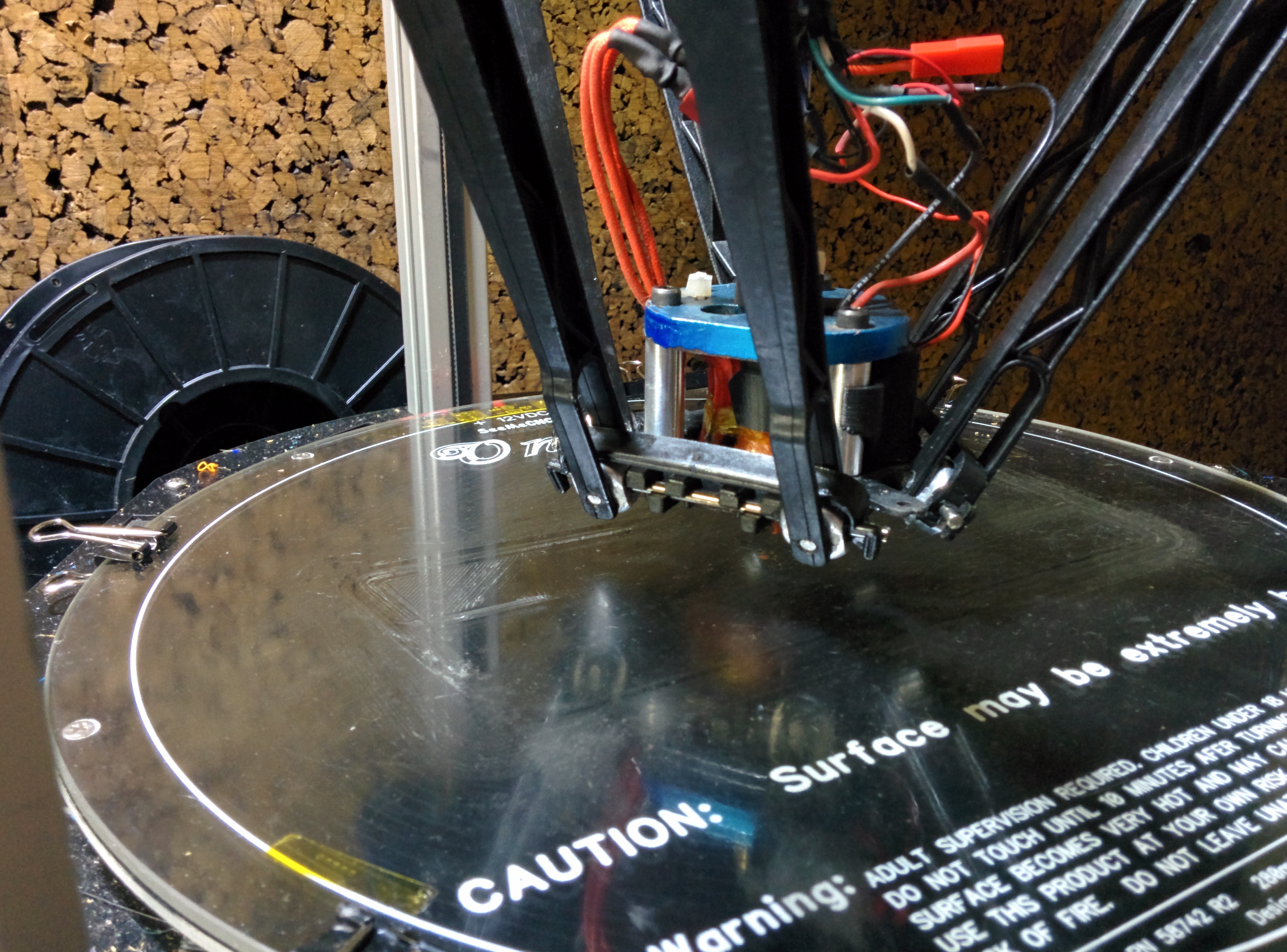

And here it is warming up to print some new fan shrouds.
I machined a new ceramic heat break, wired up a new thermistor and tapped the aluminum standoffs with 8-32 thread so I can fasten them to the effector plate with 8-32x 1/2" button head screws, and the hot end mount with 8-32 x 3/4" screws. No more juggling tools.

Webcam, yes, remote control, no. Bead blaster in the basement for cleanup? Yep. I hooked the hotend directly to a car battery to cook off the remaining nylon, then bead blasted the charred remains off from it. Those ceramic heaters are pretty stout.
