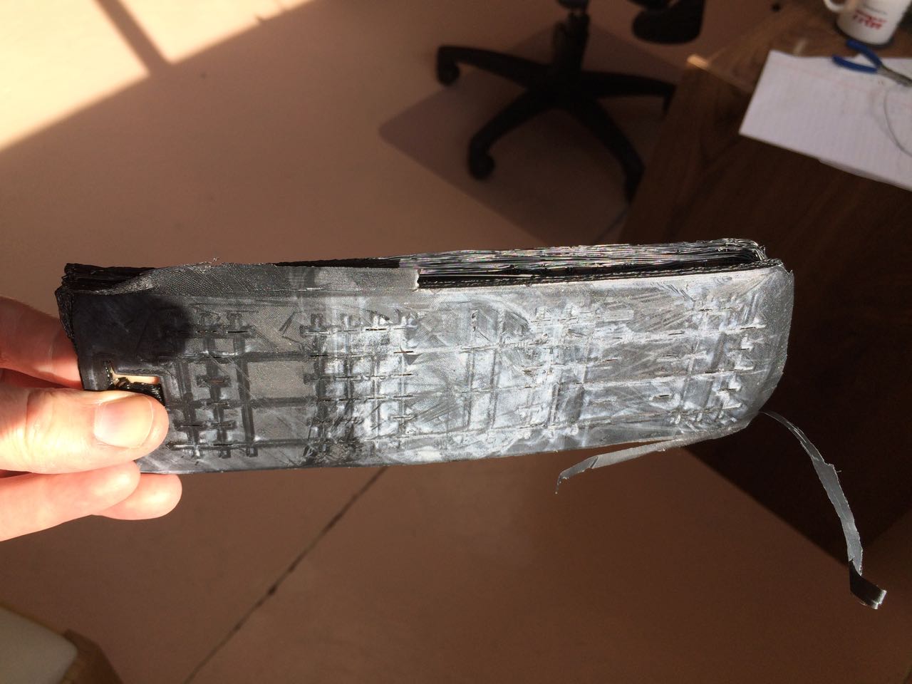

Attempt to print the Digital Sundial in ABS on a Rostock Max V3.
It started curling and detaching from the bed almost immediately.
Presumably, after 5 mm, the curling was bad enough that a head strike shifted the belt on the Z tower by one tooth, so subsequent layers had a fixed offset.
Bed is Fablam at 60C. Ambient temperature was probably about 18C, no enclosure. I didn't record the extruder temperature, but I think it was 230C. Slic3r at 0.1 mm layer thickness.

i print abs at 90c bed temp, i had a print that started off a little high yesterday (still tuning my duet upgrade) and it finished fine with no warpint.
