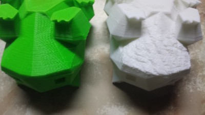

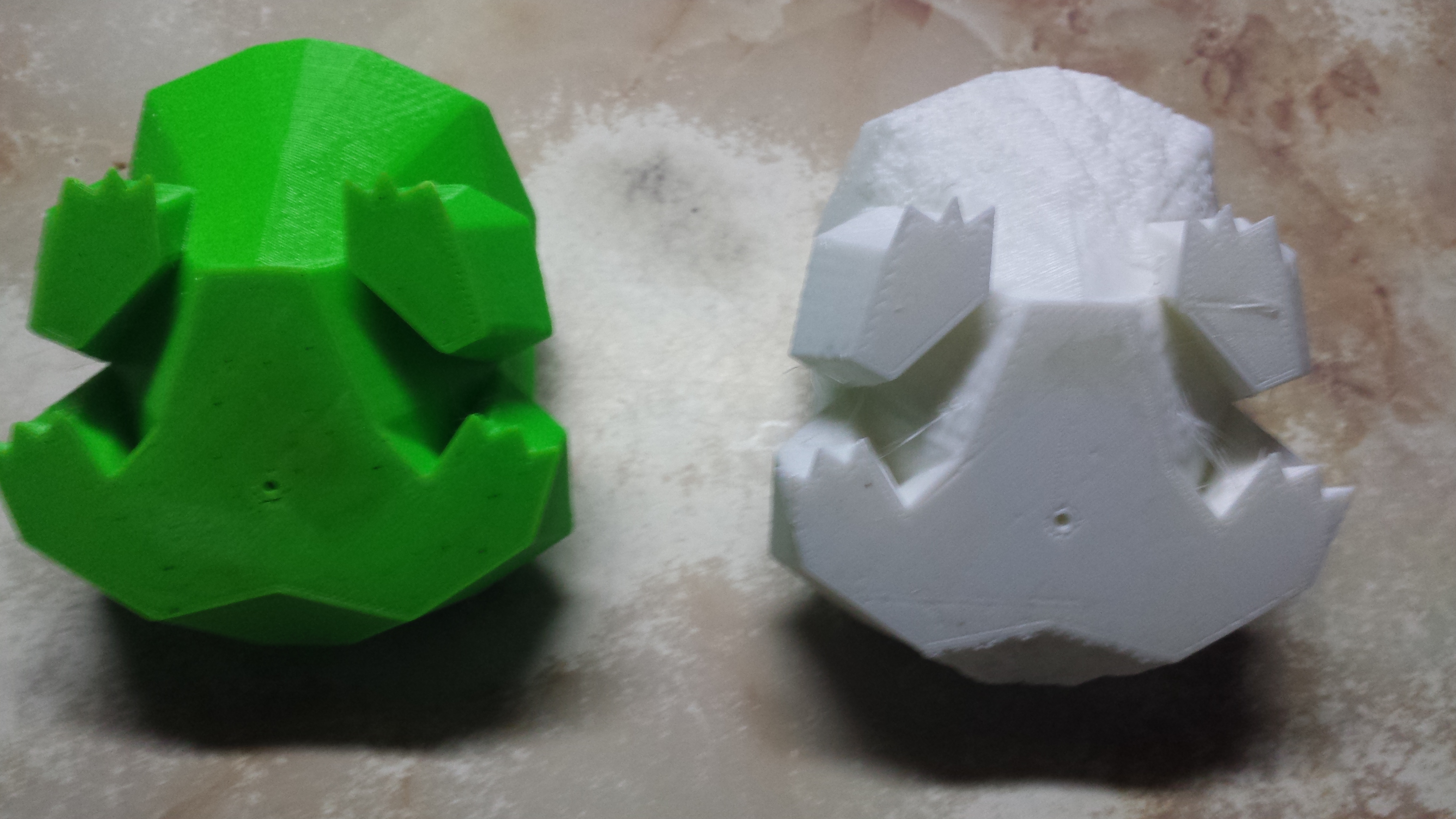

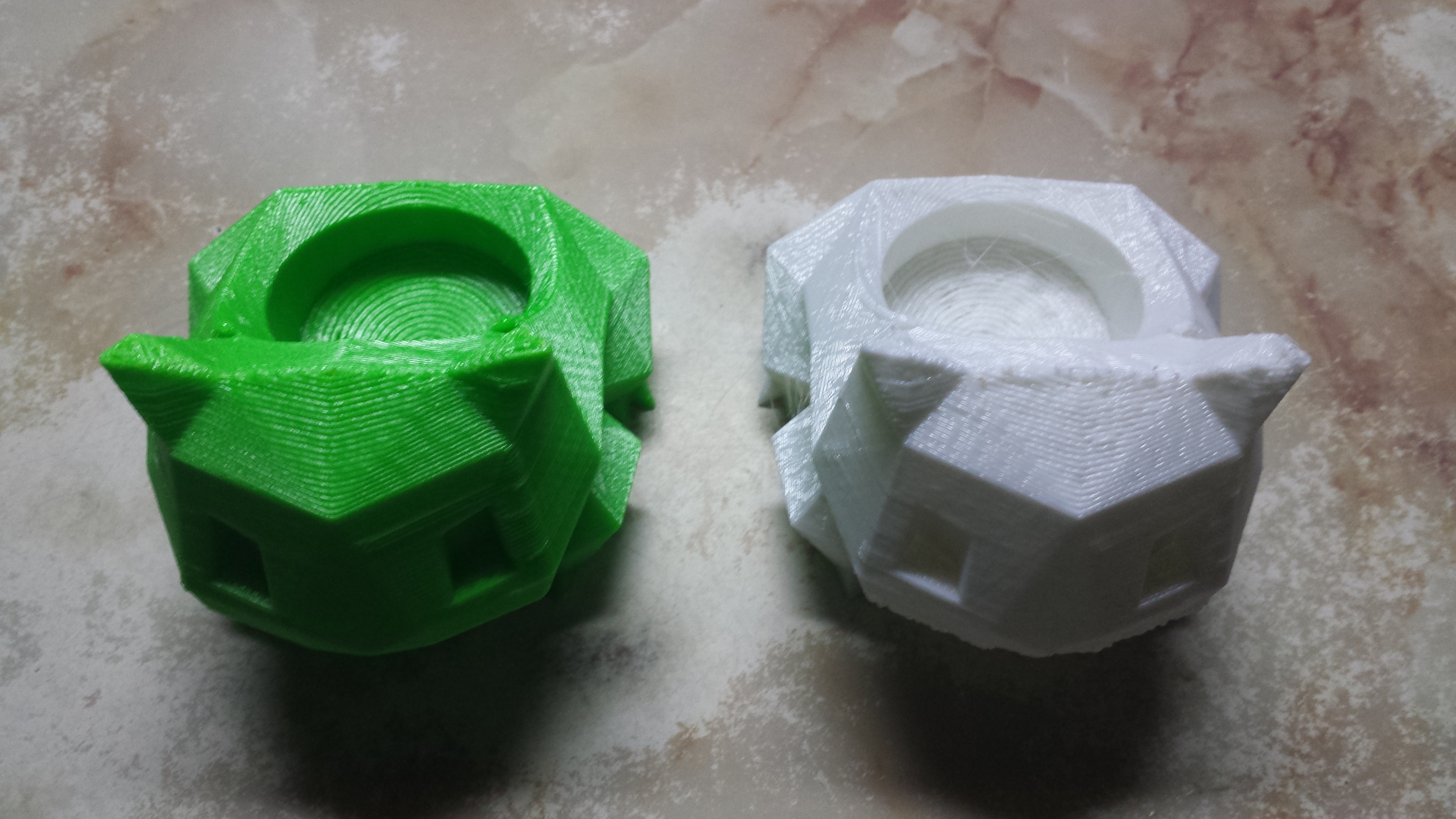

Hasn’t been going well for me for this month. For some reason I can’t get a good print.
The green one is a good print before messing with the hotend. Now it print ok but some prints are coming out really bad. The white one is example.
IMBoring25
Posts: 616
Re: Couple issues of prints
Postby IMBoring25 » Sun Nov 20, 2016 3:40 pm
Looks like the motion is still solid. Maybe an intermittent partial clog?
joe
Posts: 269
Postby joe » Sun Nov 20, 2016 6:58 pm
Look like a combination of over extrusion, poor cooling, print speed a little high. Your retraction may be off too as I see a lot of stringing.
So 1, check your extrusion first. Does it extrude 100mm when asked - disconnect the bowden tube from the hotend a measure from there.
2, slow down to 20 - 30mm/s and start from there.
3, your fans should be 100%
Then fool around with retraction. Do each step separately and look at the result. Have you check the hotend temp with a meter? it may be printing way to hot.
