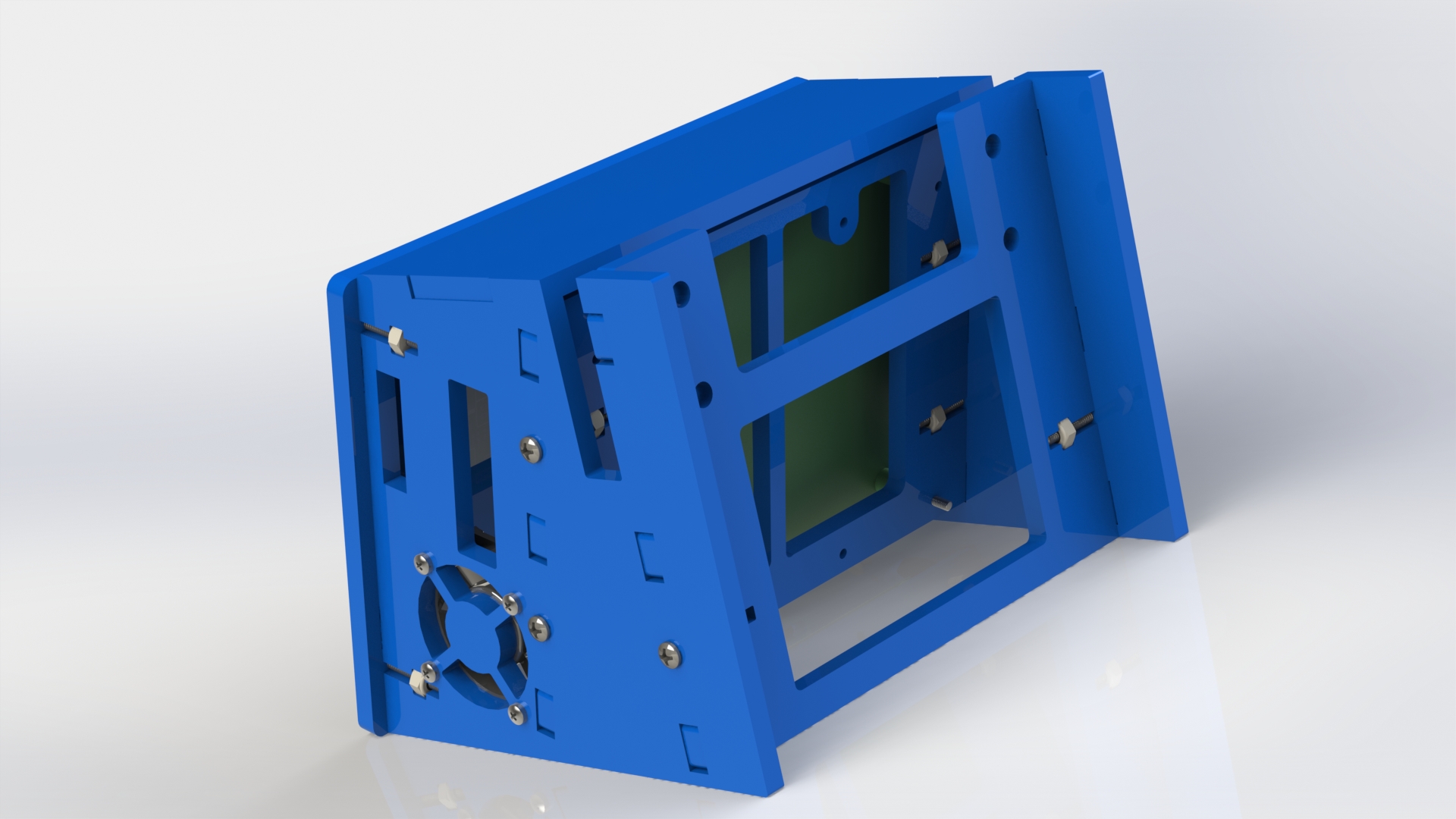

More work on the electronics enclosure today...
MAX METAL
The front cover houses the stock Reprap Discount LCD controller.
The top cover is just an interference fit. It should stay put, but will keep dropped parts out of the electronics.
There is room for a 40 mm cooling fan on either side. If using a Rambo, the fan goes on the right. If using a Smoothie, the fan goes on the left. Both boards will require 1/2" spacers. The extra height is to move air around the drivers on the top and bottom sides of the boards. The Smoothie design is based purely on CAD data as I do not currently have one. I use a 40 mm today on the Rambo in the same configuration without issue.
The spacers are printable, but they could be purchased or lathed if desired.
More pictures below...
Enclosure Only
Back side
Cover Removed - Rambo Electronics
Smoothie Version
