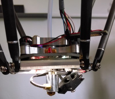

Hey sorry I didn't see your post earlier. Yeah that mount was designed for a unique setup with the Prometheus hotend hung 3/4 below the effector.
Honestly, I have never even come close to printing at full Z. I'm more interested in the larger circumference ability.
Download DesignSpark and use the CAD file attached above. You can push/pull and adjust the mounting angle to match just about any setup. Unless the fan comes to close to the nozzle that is.

Is that your LCD ring attached between the effector and the jhead mount? That effector looks like the tricklaser one so how does it shine the light through the metal?

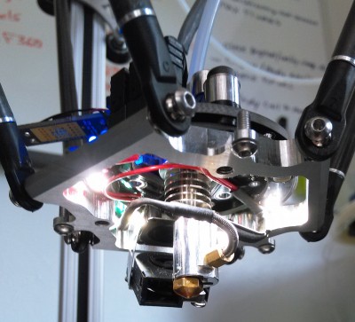

Post by Nylocke » Sat Apr 30, 2016 12:56 pm

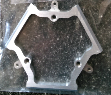

If you check out the platform its mostly empty space
Screen Shot 2016-04-30 at 11.55.50 AM.png (213.93 KiB) Viewed 6011 times
So it just shines through the areas where there is no aluminum

Post by KAS » Sat Apr 30, 2016 1:10 pm
Nylocke is correct. No LEDs are covered up, they just happen to fit perfectly within the frame.

KAS wrote:Nylocke is correct. No LEDs are covered up, they just happen to fit perfectly within the frame.
Nice! that is a neat way to mount the light ring... I did not realize the LED's would fit like that.
One of the reasons I designed the area between arm mounting screws as wide as possible was so heat sink cooling fan can fit down between, allowing any mounting height of hot end. Even the E3D 30mm fan and shroud fits down in there.
I also wanted platform as light as possible but still rigid.
~~~~ CAUTION ~~~~~ :o
Be careful not to short out the light ring by clamping it right against metal platform or groove mount, you might want to use nylon washers between metal and light ring. The newest revision of light ring has extra connection pads intended for powering ring through stand offs, so watch out for that if mounting to metal platform!
KAS, you might have a older revision of light ring, that does not have the added pads, so maybe you won't have any issue.

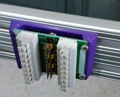

Here is a bracket to mount the YJ-Pad wiring block by Yellow Jacket Concepts to the MAX METAL Frame side extrusions.
http://repables.com/r/752/

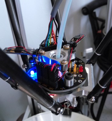

Post by bvandiepenbos » Wed Jun 08, 2016 11:41 am
@KAS
On my most recent build I mounted the light ring above platform like you showed. Great idea!

bvandiepenbos wrote:On my most recent build I mounted the light ring above platform like you showed. Great idea!
What's that hot end you've got there?

Post by bvandiepenbos » Sat Jun 11, 2016 1:54 pm
Beta testing new pico hybrid from B3 Innovations.
