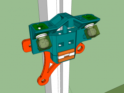

Trick Truck-compatible carriage for magnetic arms, with integral belt clamp: (Pending install/verification, no link yet)
These carriages are designed specifically for use with Trick Laser's Trick Trucks, and are pocketed in the back to accommodate the Trucks' wheel mounting screws. They should work on any "trucks" with two M3 screw holes, set 50mm apart. The small channel on the rear of the upper surface is for tying the carriage to fishing line, which then runs over the counterweight pulleys (below) and attaches to 500-gram weights. This takes up almost all of the weight of the flying extruder platform. The post going from the "roof" to the main body is for tying paracord to the extruder platform. The two rectangular openings on the front are for captive M3 nylon locknuts, which are also used to secure the chromed steel balls. The bump on the front of the "roof" triggers the endstop switch. There are no endstop screws because all good firmware lets you adjust the endstop offsets in software anyway. This can be done either by using an auto-calibration system, or by directly modifying the values in EEPROM. The belt feeds through the lower front of the carriage, where it's locked in place with a toothed part that matches the profile of the belt.
I'm printing three of these right now. I'll upload them at the same time that I upload the mag-lock effector (below).

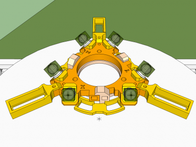

Mag-lock effector for magnetic arms, featuring integral fan ducts and LED ring: (In progress, no link yet)
This is meant to be printed with the fan ducts. You can also print it with the LED ring, but removing support will be a huge pain, so it's easier to print that separately. The LED ring needs to be adjusted to accommodate the mag-lock effector plate, so this isn't its final revision. The effector plate is meant to be installed from below (it twists into place), and is held firm with neodymium magnets. These have been located as far as possible from the magnetic arm joints in order to minimize magnetic interference. Captive M3 nylon locknuts are used to secure the chromed steel balls.
I'm going to publish this, and the carriages, as soon as I finish adjusting the LED ring and verifying that everything works properly once installed. I'm already using an older version of the carriages and effector, and the results I'm getting are VERY good. The only trick is that the ball sockets have to be lubricated with a THIN application of Super Lube. I use a paper towel to ensure the application is thin and uniform. If it's too thick, there will be problems with positional accuracy, and the effector does need to be moved around for a minute or two for the joints to settle after they've been oiled. The system will work OK without lubrication, but you'll get uneven layers, especially around the corners, as there will be a small amount of binding.

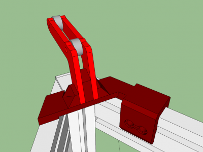

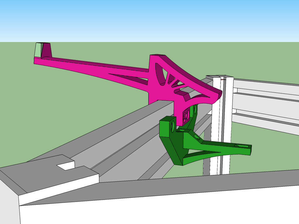

Counterweight system, using V-groove pulleys and 500-gram weights:
This one will need to be printed with support. In the future, I plan to do a version that reaches out towards the center of the printer, and puts the pulley there, so that the counterweight can take weight directly off the flying extruder platform. For now, the weight is taken off at the carriage. If you have cats, you better figure out some way to keep them away! I've had to take measures to keep mine away from this because they LOVE to swat at the weights and bite the fishing line, especially when the printer is in motion.

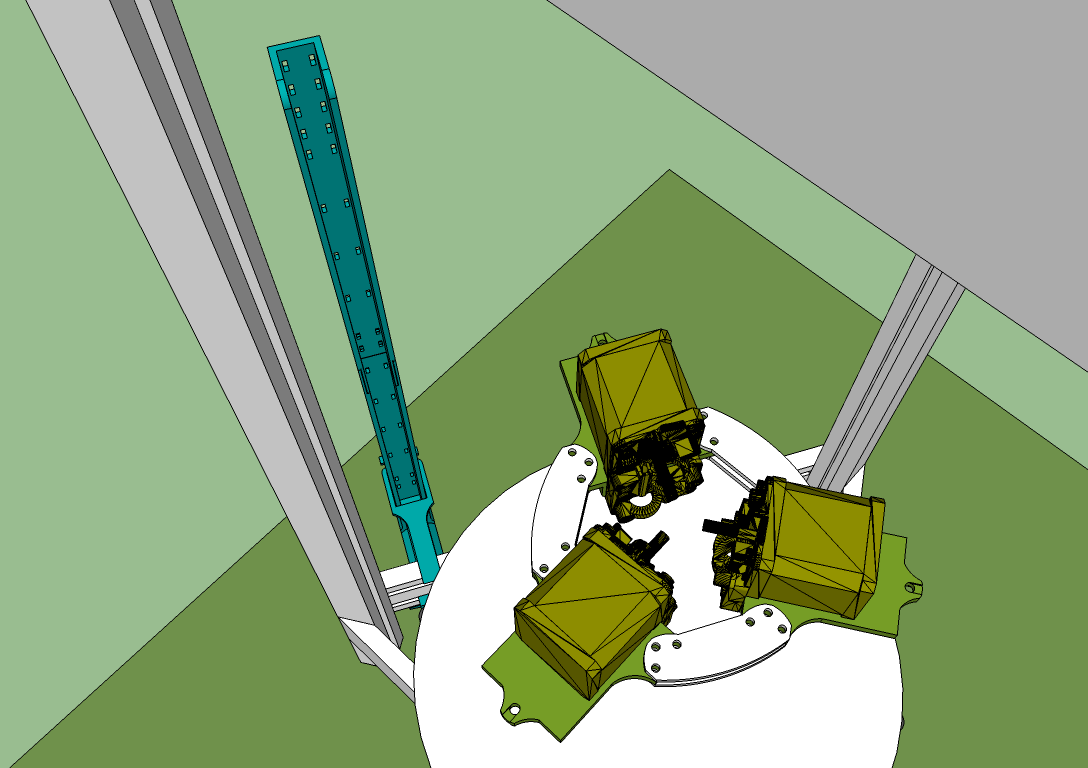

Cable mast and Flying Triple-Extruder Platform: (Platform in progress, no link yet)
The cable mast is a great way to take weight off the platform. The cable is meant to travel in an arc, ascending from the top of the mast before curving downward to the effector. The top of the arc can be suspended from a strain relief mast (below) with paracord. The extruder mounts are deep enough to accommodate the 5.18:1 steppers from TriDPrinting, and that's all ready to go, except that I want to enlarge the holes where the paracord is tied to the crossmembers. The cord I'm using now tends to wear out and lose some of its elasticity over time, and I'm hoping for better luck with some thicker stuff.

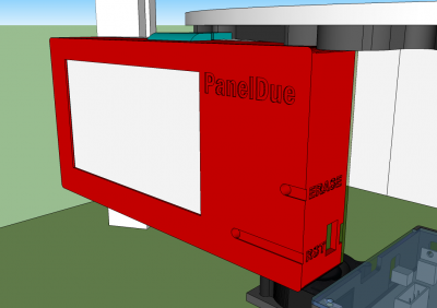

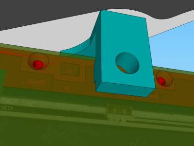

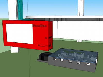

Smoothieboard and PanelDue enclosures: (Smoothieboard mount in progress, no link yet)
The Smoothieboard enclosure is intended to be located below the printer. I haven't decided how to mount it yet. It's designed to work with this small 4.21 CFM blower.
The PanelDue mount is meant to bolt to the lower front frame crossmember. It's based on dc42's box, but is designed to print a little more easily, and to have a lid and a method of fixing it to this particular frame. It comes with center, left-offset, and right-offset mounting brackets.

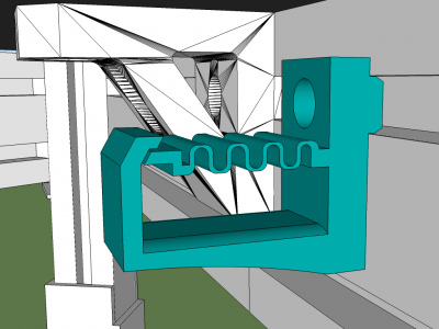

Cable Clip
This clip features a spring retainer that will print very well with PLA. It's designed to be short enough to slide past any accessories that might be mounted in the channel above/below it.

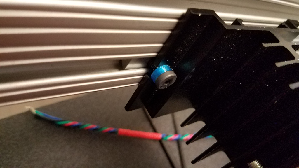

Spacer for SSR Mount
These printable spacers are useful for mounting an Auber Instruments 100-amp SSR + HS25 Heat Sink to your MAX Metal.

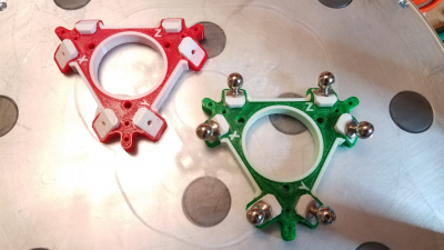

Made some progress on the effector. I decided to drop the mag-lock idea for now. It's designed for two-or-more-color printing, but will also print fine on single-extrusion systems:
The photo doesn't show the LED ring or integrated fan ducts, but they're still there in the models. You either load those things into the slicer or you don't, depending on which features you want "built-in." They can also be printed separately and bolted on. There is some color bleeding (PETG seems sensitive to this in Cyclops hot ends) but I have a Palette coming soon, so hopefully that problem will go away for good.
Since these are printed effectors, it's necessary to design a system for making sure all the ball joints are at the same elevation. I think a micrometer is probably enough. Otherwise, I have to design a printable calibration rig that would work with a micrometer. Without adjusting the ball joints at all, my Smoothie fork has been able to calibrate the printer to within about 45 microns - not bad!

I'm having trouble perfectly leveling the ball mounts on the printable effectors, so I'm looking into another solution.
Also, I've added spacers for installing the Auber 100-amp SSR + heat sink directly to the frame: http://www.thingiverse.com/thing:2063788
