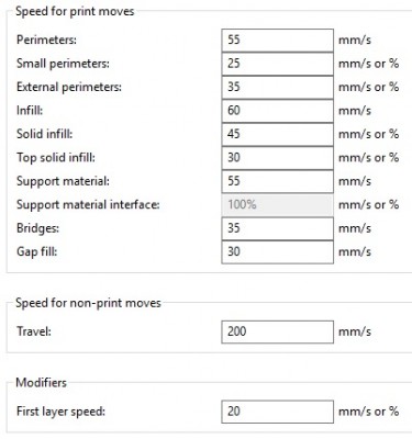

Hi everyone,
I was curious if you wouldn't mind sharing the print speeds you generally use on your Orion printer. I have it set relatively slow to get acceptable prints and I was wondering if it was in par with others.
Mo

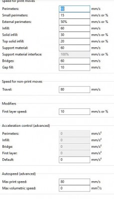

Postby Tincho85 » Sun Oct 25, 2015 5:04 pm
It's not an Orion, but we have very similar speeds.
Martín S.

Re: Print speeds?
Postby LAFilament » Sun Oct 25, 2015 7:15 pm
Very interesting. Good to see where I might be able to speed it up. Thanks.

LAFilament wrote:Very interesting. Good to see where I might be able to speed it up. Thanks.
Tincho95's settings look good.
Each type of filament can be printed at different speeds.
The only way is to experiment with the speeds of different filaments and keep
excellent notes. Red Pla from SeemeCNC prints at this speed (as an example)
This can be very time consuming but is the best way.
