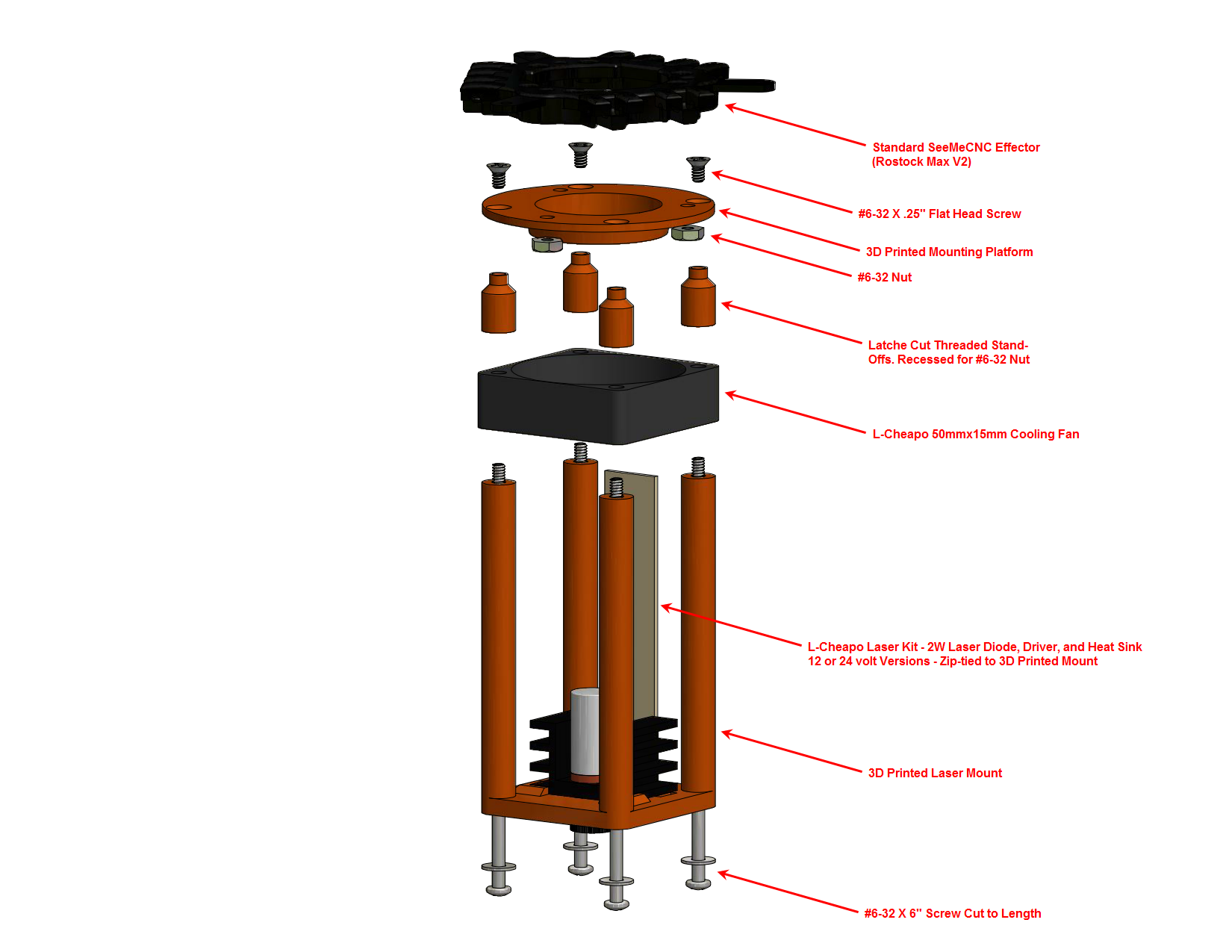

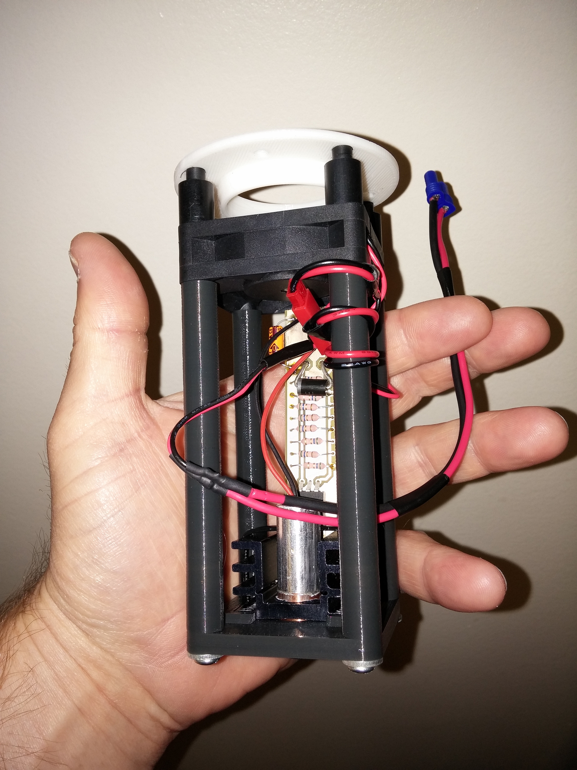

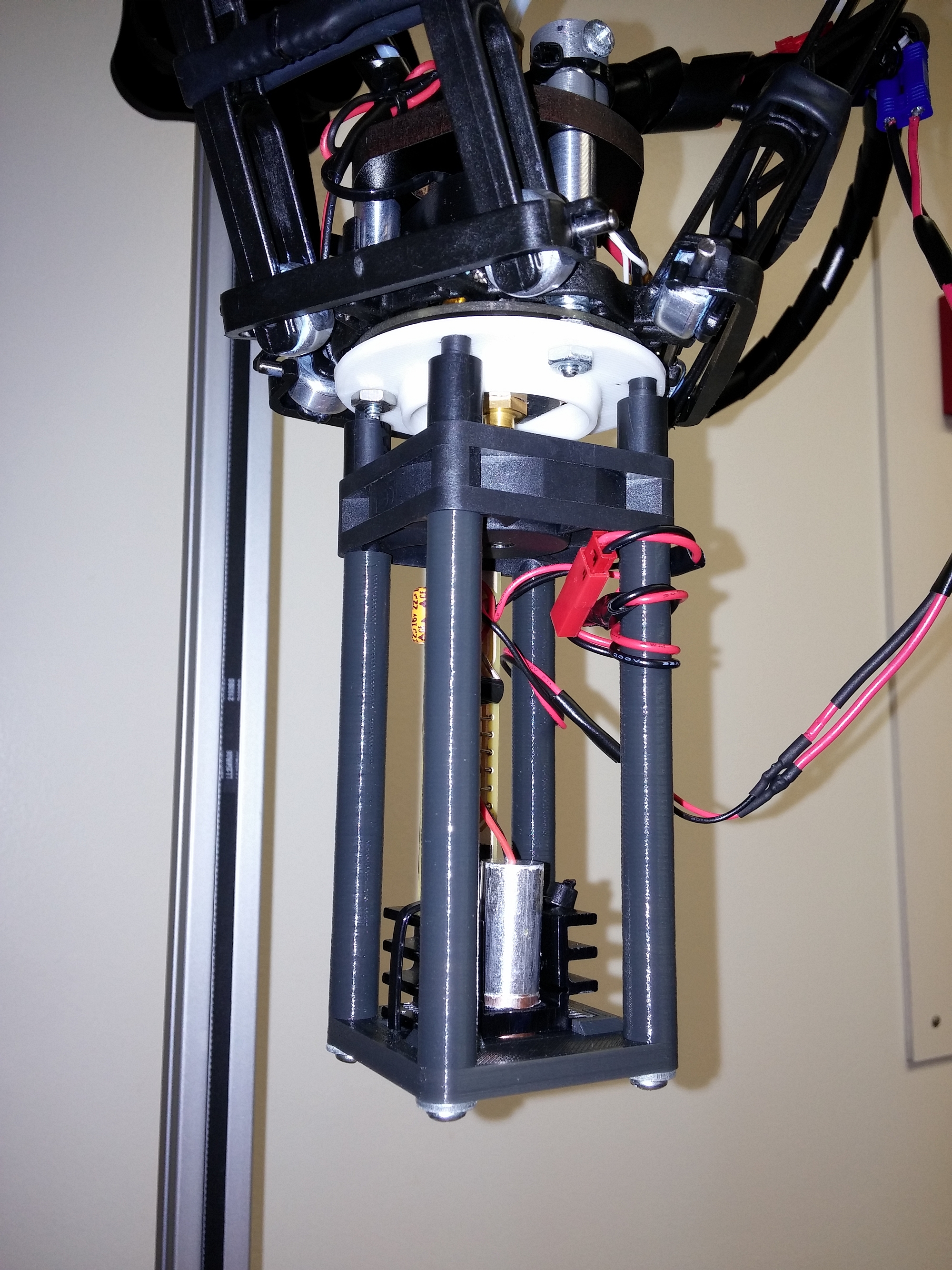

Alright, here's what I have so far for the laser. I printed the thing out of PLA so it would be stiff. You want as little flex or vibration in the mount as possible. Especially so since this is a long mount. This particular design works very well. It's quite rigid when assembled. The whole point of it is so I can easily add it to the underside of the effector quickly. Attaching it can be a little tricky though. I use needle-nose pliers to get two of the nuts started. Still, it only takes me a minute or two to get it on and off. The driver can be separated from the heatsink and rewired off of the mount but I chose to keep it intact.

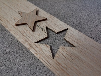

I haven't really had a chance to play around with various materials for engraving and cutting. Balsa is cheap and easy to cut. I have plenty of that stuff. I cut a star shape out of some .09" thick scrap balsa. You can see that it cuts quite sharp and cleanly (burned some stuff on the other side that came through). There is nothing to control the output of the laser. All depends on speed. Run your bot fast for engraving and slow for cutting when wired to the hotend. When wired to the fan you can control laser output. I've learned that there is a fan2 input on the RAMBo. All depends on how you wish to wire it. Since I already had an E3C connector on my hotend, I went that route.

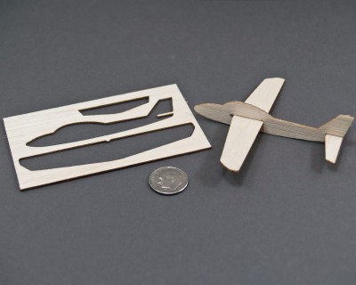

Cut a business card sized glider this morning.
