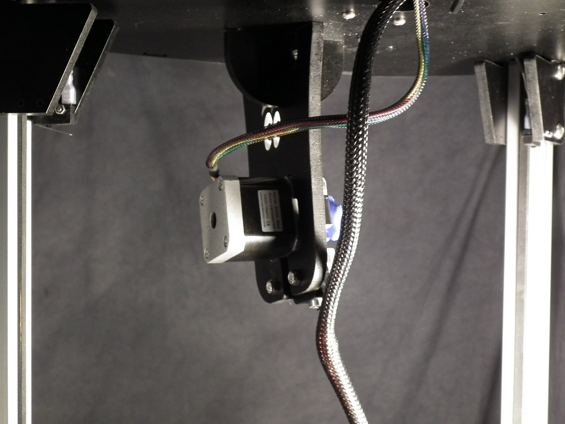

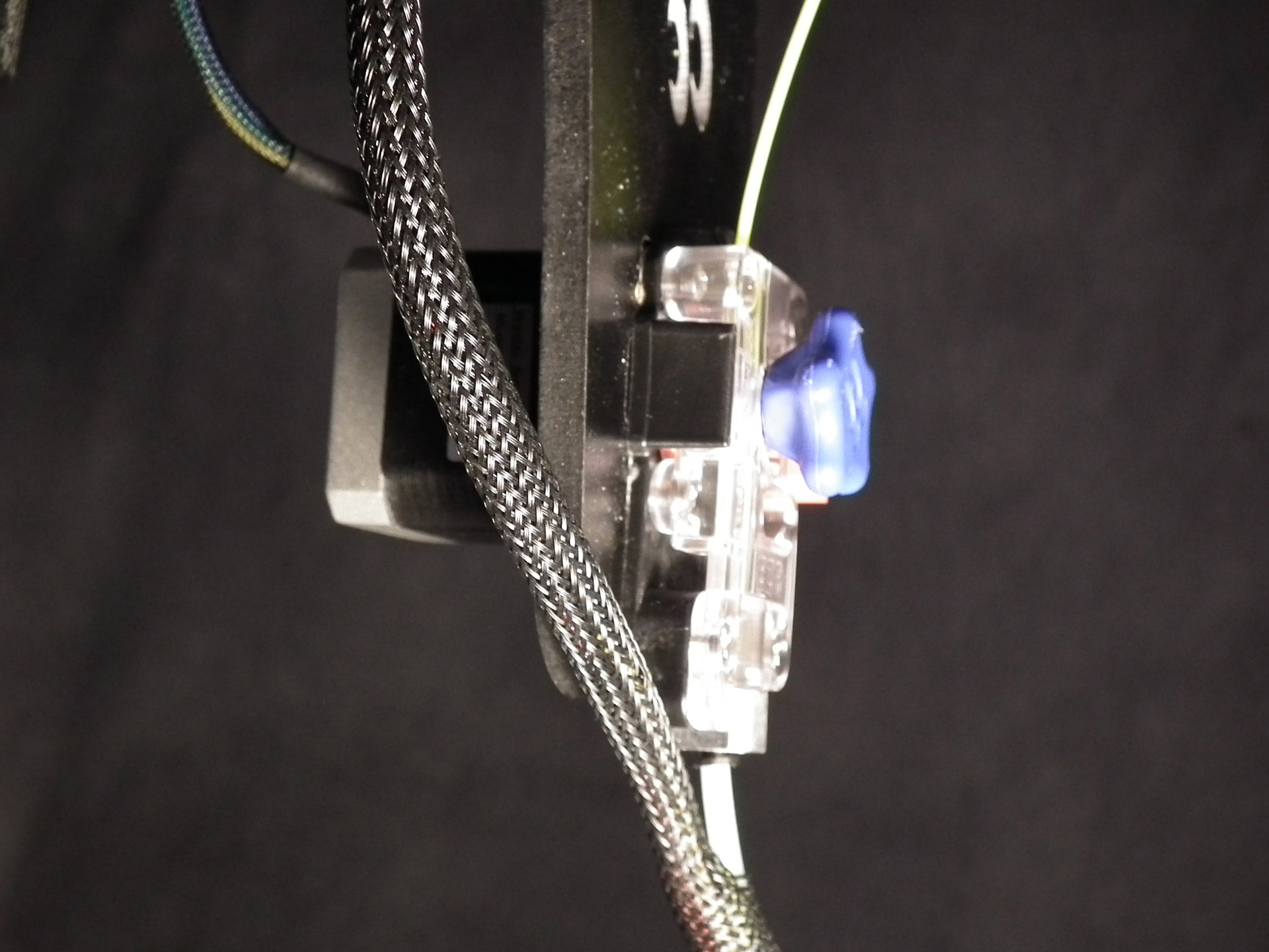

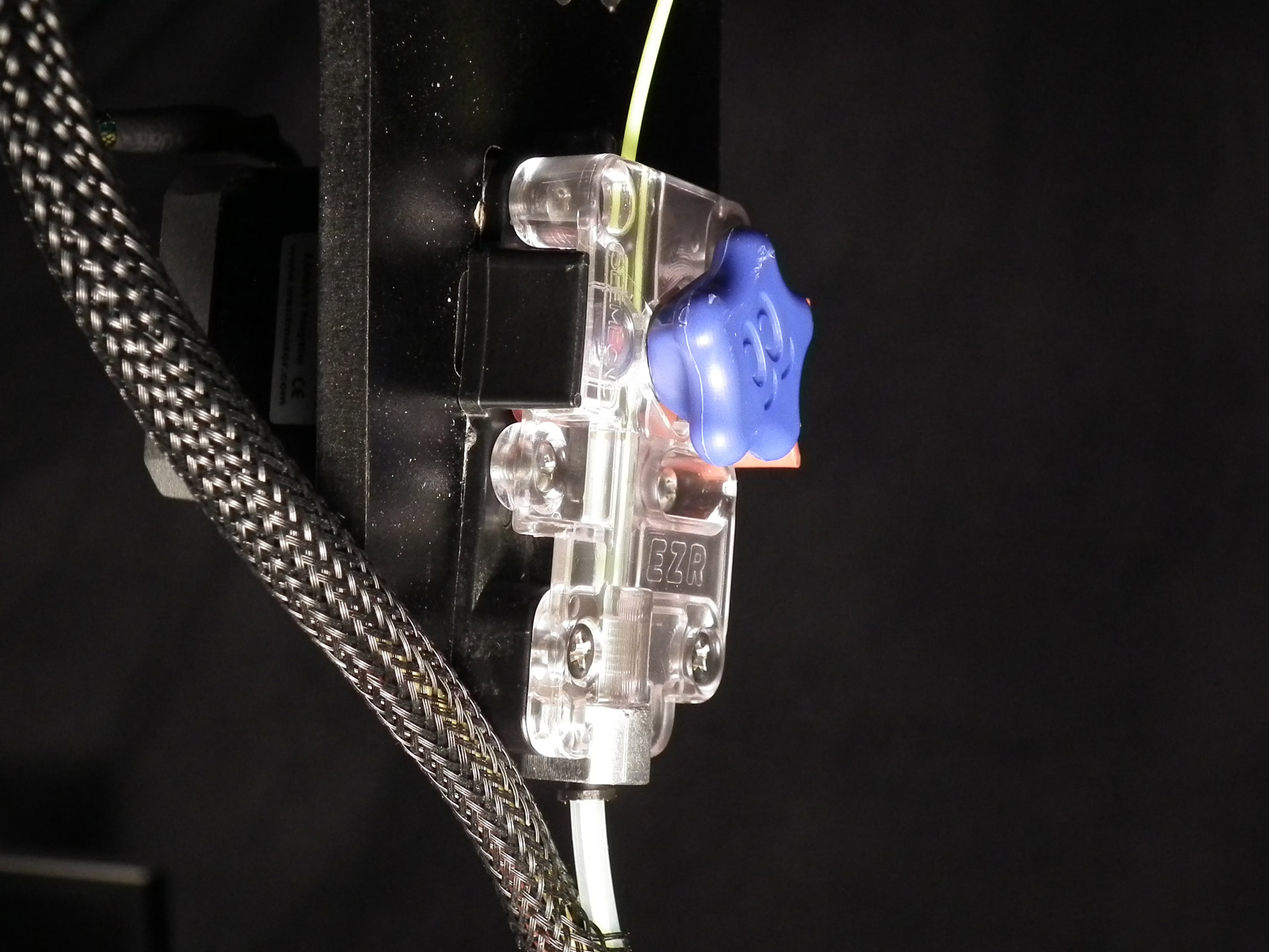

I received my EZRStruder this week and installed it today. My first impression are that it is a dramatic improvement over the EZStruder.
Initial impressions:
Very easy to install, even with no instructions. It eliminated the weird U shaped melanine spacers used for the EXStruder, and has the correct mounting screws, so the install looks a lot cleaner.
Without directions I was unsure how the align the hobbed gear with the idler. It was very hard to see how it aligns, so I put the gear on and ran some filament back and forth through the extruder by hand to "self align" the nitch with the filament path.
It aligns differently than the original hobbed gear, so you can't just swap the plastic because it does not align the same way. This meant taking off the existing hobbed gear and shattering the supplied hex key in the process (I guess the Loctite worked too good on the grub screw). I got the screw out by heating the hobbed gear with a lighter and then using a pair of pliers to hold a section of the broken hex key and turn the grub screw.
Once that was done the rest of the assembly is dead simple and obvious. It went together really quickly once I got past the hobbed gear.
Filament loading is 10000000 times easier than before. It basically self guides. You don't really even have to press the lever, just insert filament and wrist the knob. Magically the filament appears inside the Bowden tube.
It seems to grip stronger than the EZ struder. I can more easily manually extrude with the knob without slippage. Nice.
I mainly got it for the ease of entry, and loading, which is frustrating with the EXstruder, and was nicely surprised that it seems to drive better as well. I was happy with the existing EZ struder. It's well worth the investment.
I rarely print with flexible filament, but I may try this out sometime with the EZRStruder and see how it goes. The filament path is much more constrained and it looks like it will prevent binding.

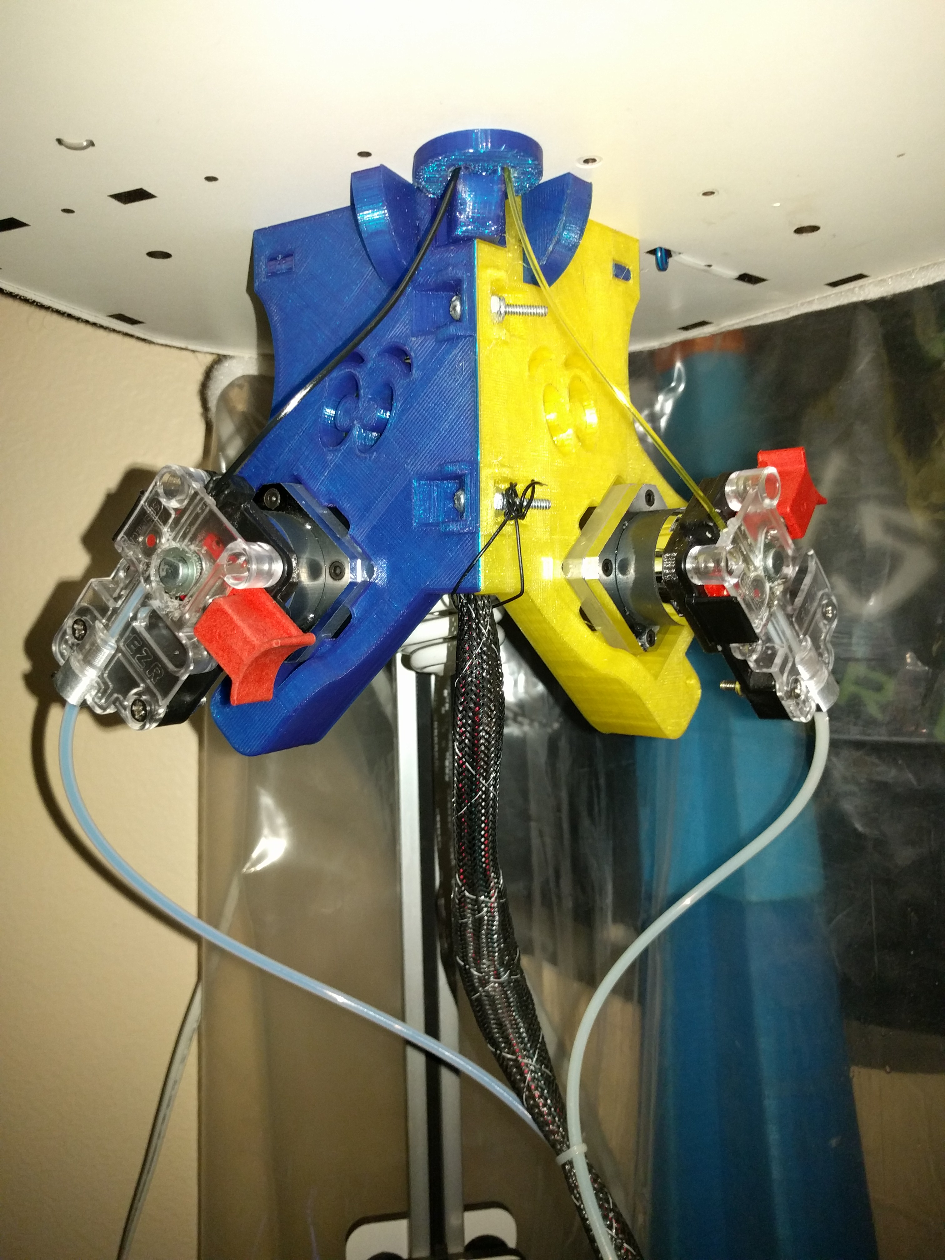

Just thought I would tag back in with an update.
I discovered that the EZRstruder requires a SLIGHT modification to work with the geared steppers from TriDPrinting and their hobbed rollers. The oval hole in the red push lever needs to be modified to be more circular, otherwise the grub screw for the roller gets caught on the red arm.
I modified both of my EZRstruder red arms by dremeling the oval out to be more of a circle. So far, the added torque and stepper resolution increase has been awesome! Still just trying to dial in the proper settings for my cyclops, but that is a different story. :roll:
General view of one of the extruder setups
I copied Gchristopher and used his and the dinosaurs' mounting scheme
Currently trying to get a rather cool looking succubus to print

Can't you just loosen the grub screw, pull the hobbed roller off, flip it over and align it and then tighten the grub screw?
lightninjay
Posts: 289
Location: Tampa, Florida
Re: First look at the new EZR Struder!
Post by lightninjay » Sat Aug 20, 2016 4:48 am
Great question! Alas, I cannot. Once flipped, the grub screw does not come in contact with the geared stepper's shaft in order to be tightened down. :(
Had I just used a regular tradition EZstruder it would not have been an issue.
But since I chose to go with the newer EZ(R)struder with the geared stepper motors, the fatter stepper shaft and reconfigured 8mm ID hobbed roller create a scenario with a raised grub positioning screw.
Thus, I did something to the effect of this.
I dremeled out the flatter edges of the red button to make it more like a circle.
I would have preferred to just flip the roller, but I suppose one could just use shorter hob screws or attempt to grind theirs down a bit... :x

I actually took the time to grind down my set screws using a Dremel and a grinding disk. Now I have no issue with the set screw hitting the red release lever.
The EZRstruder seems to exert a more direct pressure on the filament than the EZstruder did. Could just be placebo, but, for this reason, I think the EZRstruder is a better pair for the higher torque of a geared stepper motor.
A few seconds of grinding on a set screw will get ya going in order to use the EZRstruder and a geared stepper motor with the larger hobbed gear. Or SeeMeCNC can slightly redesign their red levers, although this option may be unlikely due to the already sunk investment in their injection molds.
