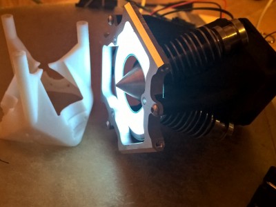

If the cooling fins interfere with arms you could rotate assembly 30 degrees by using a max v1 effector platform, they had 6 holes for stand offs, so you hard more position options. If you can't find one, the stl is probably on github, then print one.

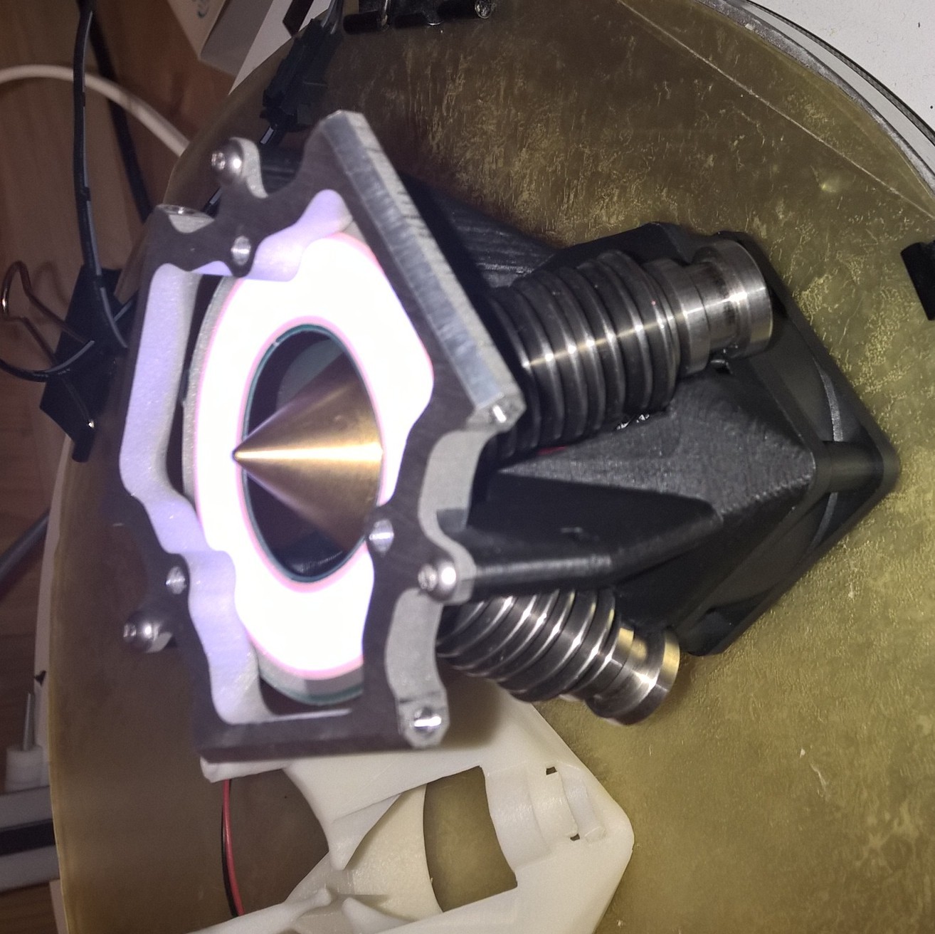

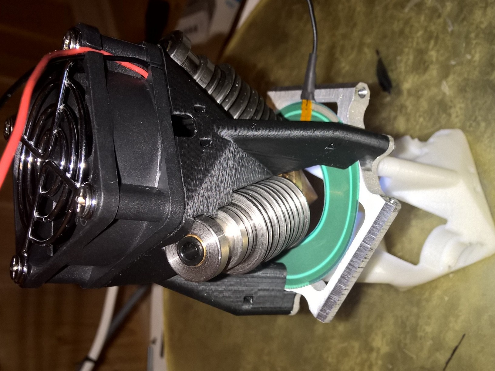

I finally got a couple of completed prints out of mine. The height of the support legs for the mount is somewhat critical, I ended up modifying the open SCAD file printing a second one, then adding spacers.
The one issue I have with it right now is what I'm guessing is a large thermal gradient in the brass nozzle as a result of it's size. My thermocouple reads 190, but if it sits at that temperature for any length of time the PLA in the nozzle will pour out of it with extremely low viscosity, which is usually a sign of way too high a temperature.
This makes controlling stringing difficult, I'm going to continue dropping the print temperature to see if I can get it under control. I'm also still messing with how much material has to be deposited on the purge tower to get a clean color change.

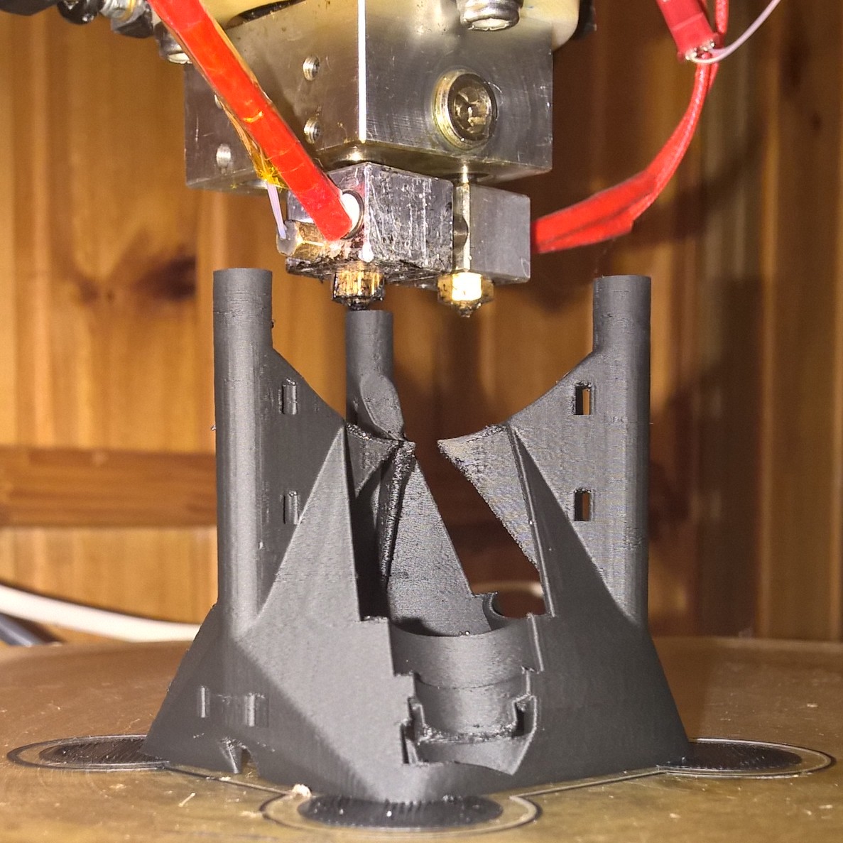

I'm currently running 2 steppers from Rambo on mine, with a short length of filament in the 3rd hole, if I can resolve my retraction issue, I'll stick one of my spare pololu drivers on a small breadboard and connect it to a couple of spare IO pins, they are really trivial to wire up.3D-Print wrote:Curious as to how others are running the two extra steppers and what hardware and software is being used.
Currently I can't get S3D to generate the retracts I want, CURA and Kiss have other issues.

Jesse's Diamond had an interference problem between the ribbed cold end and the heater cartridge. He mailed it to me and I machined the bottom several fins on an angle so they would clear. Anyone else have this problem?

My initial effector mount cleared, but there wasn't enough clearance between the mounting bolts and the print, which led to issues, I dropped the mount by 10mm, that led to interference issues with the fins, I ended up adding 5mm spacers and that's worked out OK. Bear in mind I'm running E3D V6 Lite heatsinks, I don't know if they are dimensionally different.mhackney wrote:Jesse, were you able to get yours operational?

My issues are largely about generating the retracts I want, if you retract A and prime B, you end up with filament immediately being extruded during the prime. I guess the retract just forms some sort of air bubble this tends to cause the priming extruder to dump a tone of plastic and often skip later causing underextrusion as the pressure normalizes. So what I would like to do us retract A before moving to the prime tower prime A, then use the prime tower for the color change, I can't find a slicer with a enough prime tower area that will let me do this. I can do everything except the retract/prime on the primary extruder during the move to and from the prime tower. If it's cooler this weekend I might write a post processor. Currently I get good color changes and pretty good quality, but with brutal strings between the prime tower and the print.

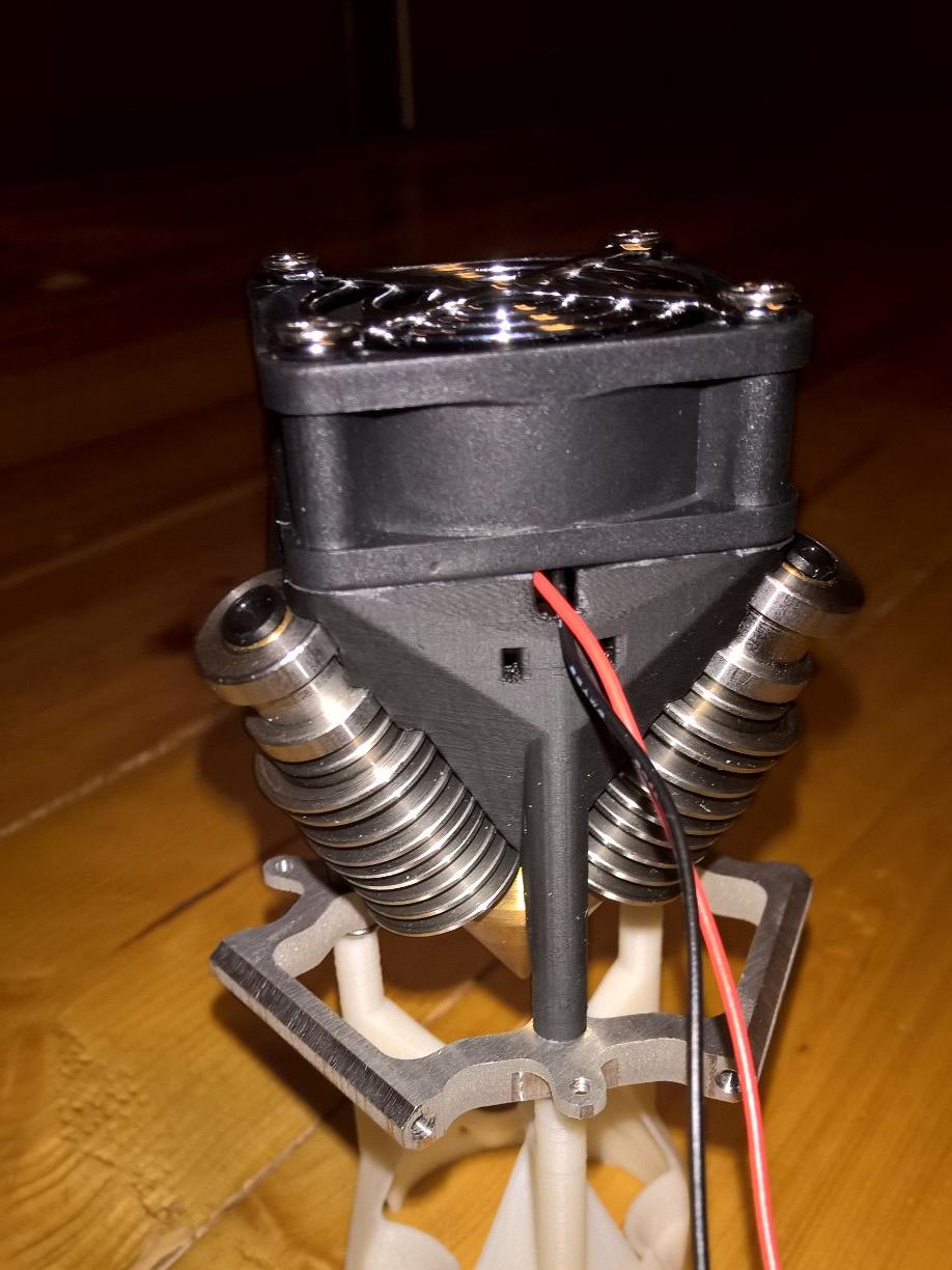

Oh, looks like it takes whole month. But I did it. If anyone wants .stl, just ask, i'll mail it to you (with modifications, if needed).Renha wrote:If someone going to print or (re)design mount, please wait week or two if you can, package from mhackney is coming, and I'll check one I've designed, I like it and hope you'll like it too

Thank you! I am going to make another version with attaching to outer holes of TL effector instead of inner ones (actually, universal - outer or inner or both kind), because EL ring I'm going to use for getting light doesn't fit now. Screw heads would be gone from bottom surface of effector too, so overall height should become better. I'll post .slt pubically when it would be perfect
so again: you should not wait, just ask and I'll send

...maybe something like that?

This if part of my Ashwood mkI MAX METAL-based printer project (bet previous version without light is fully compatible with classic SeeMeCNC EPlatform); special thanks to Brian for awesome TL MM EP!

Is this a problem that's specific to the diamond or would the cyclops also have this issue?Polygonhell wrote:My issues are largely about generating the retracts I want, if you retract A and prime B, you end up with filament immediately being extruded during the prime. I guess the retract just forms some sort of air bubble this tends to cause the priming extruder to dump a tone of plastic and often skip later causing underextrusion as the pressure normalizes.
Re: Interesting new Diamond hotend 3x filament
Don't know if the cyclops would do the same thing, it seems like any similar design would behave this way. It's not really an misuse IFF you can get the right set of retract/prime pairs and have a decently sized prime tower for the color transition.
However at the point I did my testing there was no slicer that allowed both.
Cyclops does have the advantage of being considerably lighter, that big block of brass for the nozzle is quite heavy.
