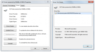

Postby GPriv » Fri Sep 11, 2015 9:35 pm
PLEASE HELP!
I have a Dell laptop running Windows 7 Home Premium.
Last year I assembled the Max V2, got it all up and running--printed the fan shroud, then haven't touched it since (family stuff to deal with).
Now that I'm back, I needed to learn a 3D program to design stuff. Chose Fusion 360. So far, seems okay.
I designed a doo-hicky and wanted to test print. ...Nothing. AAARGH!
The com3 port is "access denied".
I've tried everything--in my realm to fix it. This includes rebooting a million times. Uninstalling all software and reinstalling. Uninstalling the driver, powering up, letting Windows find driver
All fruitless.
The Com3 port is the same for Arduino and printer. I've uninstalled the driver a few times and re-installed it.
the green LED on the printer is illuminated--the yellow one flashes. I don't recall the yellow one flashing. Is this a sign?
I don't know what else to do.

Postby GPriv » Mon Sep 14, 2015 4:12 pm
See photo:
I restored the 'puter to an earlier date (one that I remember the printer DID work). Good call on that front as it worked.
I copied the info below to have in the event printer stopped working. Then, I forwarded the 'puter to the state it was in before I preformed the restore function.
It all still works.
What a pain.
Thanx to all who tried to help!!
