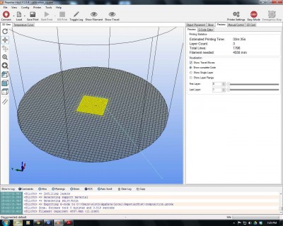

I upgraded to 1.04 and when I sliced my drawing it now wants to start the print way off the print area. Any idea why? What makes my head it hurt is from the image you see it knows it will be off the bed. I am running a Rockstock MAX V2 with .91 firmware. Nothing else has changed between yesterday and today other than the upgrade to Repetier Host 1.04. Worst case I can uninstall and go back to 1.01. Has anyone else seen this?

I found the problem, during the upgrade it changed my printer settings. Changing them back to X home=0 Y home=0 Z home=max set fixed the problem.
