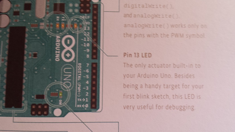

Postby RocketMagnet » Thu Oct 02, 2014 12:22 pm
Ok looks like It's intended function is definitely for debugging... well that's what the official Arduino Project Book manual states on page 11.
Though I suppose as you can code it to light however you like to feedback whatever you want it to....
Arduino Manual Pin 13 LED

Postby awander » Thu Oct 02, 2014 1:13 pm
Well, that is on the bare Arduino. I suspect ot's telling me something on the RAMBO board.
I'll have a peek through the code.
