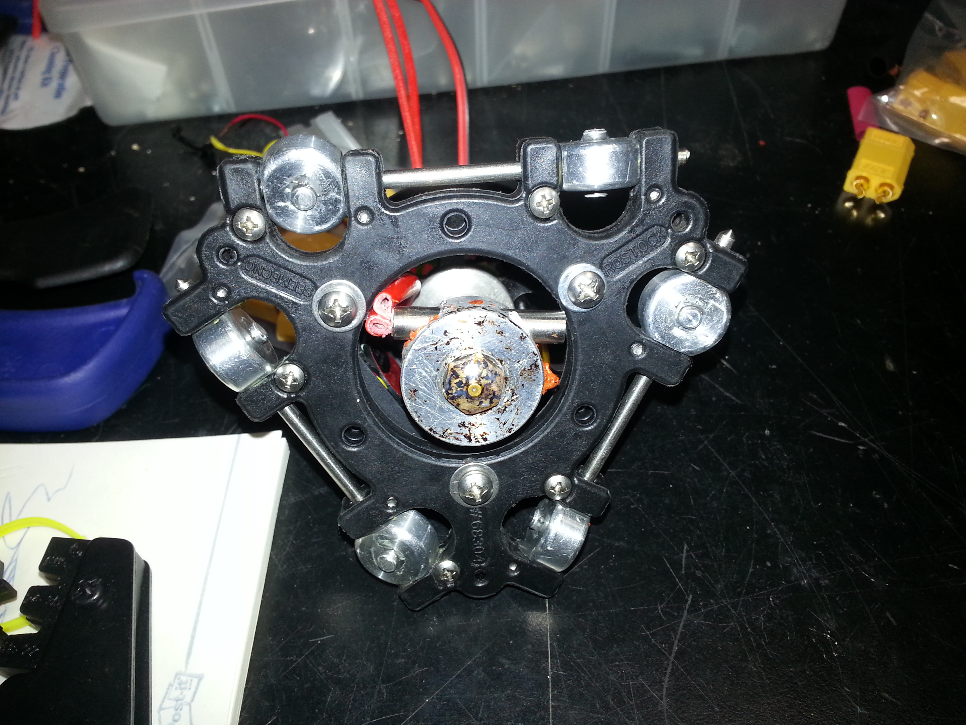

Just a refresher - I still don't have this printer fully calibrated (I swear I'm about to drive over to Blackpoint engineering with my printer and request their assistance calibrating it!)
Anyway, I upgraded from the original power resistors to a single ceramic heat core (30watt purchased from hotends.com). Although after another post on the troubleshooting extrusion issues, it was determined my 30 wat heater wasn't powerful enough for the hotend. The suggestion was to either purchase a 40watt heater element or two 20-watt.
Bigger is better, right? so I purchased the 40watt. And installed it earlier this week. Attached is a picture of the unit installed. Notice how big it is? is this normal? There is only about 1mm of space between the tip of the heater and the plastic platform. Will this be a problem? I'm really afraid to turn it on before getting some feedback....

For sure that is going to melt your effector platform. After scanning Ebay it looks like 6mm X 20mm is the standard for 40 watt and all the 20 watt I could find.
You may have a tough time finding one shorter than 20mm. Perhaps using shorter spacers you could lower the hotend so that the cartridge clears the platform.

Eaglezsoar wrote:For sure that is going to melt your effector platform. After scanning Ebay it looks like 6mm X 20mm is the standard for 40 watt and all the 20 watt I could find.
Darn, I was hoping to get it fired up and printing this weekend.
It appears mine is a 6mm x 30mm! Are you seeing a 40watt which is 6mm by 20mm? That should be sufficient

the 40W does come in different sizes included diameter and lengths, the one you have is definitely longer then i would have chosen. While if you turn it on, it will probably work, it does look close to the effector plate and might cause some warpage if you don't wrap it with some insulation.

Eaglezsoar wrote:http://www.ebay.com/itm/2x-Ceramic-Cartridge-Heater-3D-Printer-12V-40W-Prusa-Mendel-Reprap-J-Head-USA-/111115455379?pt=LH_DefaultDomain_0&hash=item19deff4b93
http://www.ebay.com/itm/12v-40w-Heater- ... 2ecd218a00
http://www.ebay.com/itm/1x-12V-40W-Cera ... 4d1925e8e8
All are United States and 6mm X 20mm
Lol, of course knowing my luck, I bought the wrong size heater! Thankfully I didn't finish installing it or turning it on before I posted this thread. I've purchased a 6x20mm (last link) since that is the closest to me. Thanks for the help guys!
