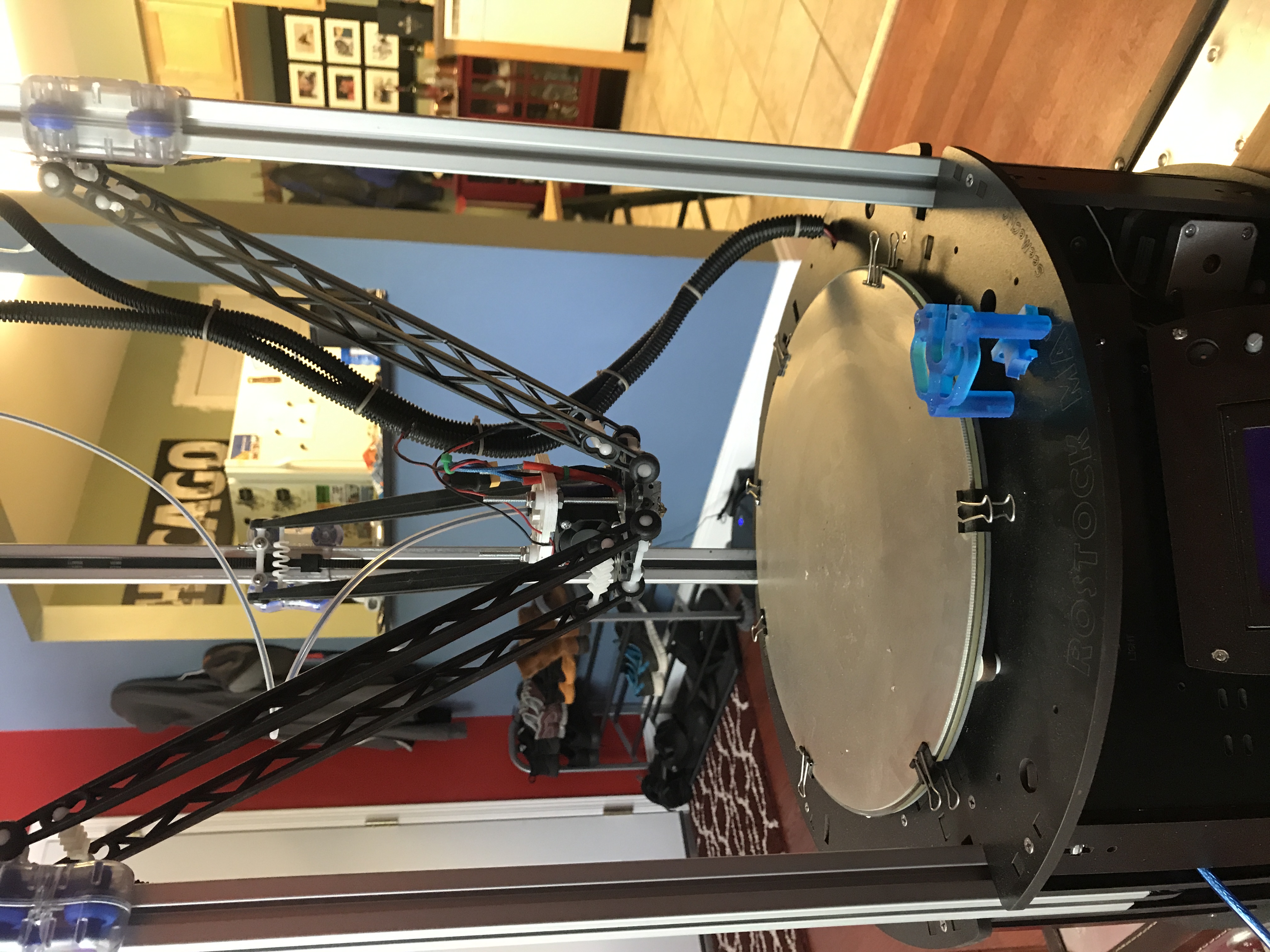

For some reason a carriages r traveling in the opposite direction when I do "home", Why does it happen and how to change it?
where do I change motor direction in the new firmware.
Also where is the place in the FW to change extruder direction?
I can always go back to 8.0 so I can get to print.
I am happy to report that I can control the head temp and bed (not all control is lost).
In configuration.h you should see the following lines, changing them to the opposite value will change the direction. (E0 is extruder)
#define INVERT_X_DIR true
#define INVERT_Y_DIR true
#define INVERT_Z_DIR true
#define INVERT_E0_DIR true
You would need to edit the necessary lines then upload to the Rambo using the Arduino and selecting repetier.ino then upload but that I'm sure you know.
Stepper motor direction of rotation can also be changed by switching a pair of wires on the connectors, the problem is getting the pins out of the connector and switching them
some can be stubborn, usually there is a small hole in the connector where you can gently push the metal while pulling gently on the wire and it should release. A pair is defined
as pins 1 and 2 OR pins 3 and 4.
