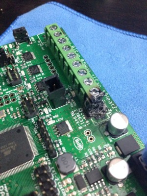

Re: 12v to 24v
The only reason the Rambo is not run on 24V is the puny little connectors that it uses for the Heatbed. We've seen the pictures of the Rambos with the melted connectors that isJimustanguitar wrote:So silly question... I know that the main goal of the 24V conversion is to make your heated bed reach temp faster. If the Rambo accepts several different voltages, is there any reason not to just use the 24v supply for everything? Get rid of the ATX and just use the industrial unit?
caused from having the heatbed current going through them. They are too small and they overheat from the 17-18 Amps going through them. It is much cheaper on the wallet to
use a DC-DC SSR to handle the current rather than a Rambo whose connectors were not designed for that much current. There is also the fact that the more voltage you put into the
Rambo, the warmer all the components get and the possibility of parts failing from getting too hot. My opinion on this whole affair is that it is your Rambo, if you want to run it at
24V and drive the Heatbed with it at that voltage, go ahead. Just be sure to have an additional $200 for when it self destructs.

I would like to do this mod to get higher heat out of my onyx bed. Is there a wiriing diagram for the SSR and The Meanwell Power supply hook ups? They are mentioned in many threads, but it is not obvious to me on how to put them in. (Chemical Engineer)
Re: 12v to 24v
It is very easy but if you are struggling to make such a basic connection PLEASE PROCEED WITH CAUTION.
I ran my Onyx at 24V from my RAMBo for over a year without incident. Most folks use an SSR and I recently changed to that when I moved to an Azteeg X5 Pro board. It's a simpler connection this way.
Unplug your printer and disconnect from you computer (USB cable).
Locate the input side of the SSR - it is usually clearly marked on the unit. The terminals will be marked + and -. Connect plus on the SSR to the + heated bed output on your controller (RAMBo) - make sure to use heavy gauge wire, I use three 12 Gauge wires! Then connect the - terminal to the controller. At this point you can test things before hooking up the 24V and Onxy. Connect to your printer from your host and instruct it to heat the bed to 50°C. You should see the indicator LED on the SSR (every unit I've seen has one) flicker as current is supplied to it. If so, you are ready to connect the 24V and Onyx.
Again, unplug your printer and disconnect from you computer (USB cable).
Connect the 24V supply's ground (-) to the Onyx ground terminal. Connect the 24V + to the SSR's output (-) terminal then connect the (+) output terminal to the Onyx (+) terminal. Power up and set the temp of the bed to 50°C again. Now you should see the SSR and the Onyx LEDs flash.
At this point you need to configure the heated bed in Repetier firmware. I use the PID tuner to tune the heated bed for 60°C and be done with it.

Re: 12v to 24v
The 24V - or ground from the power supply goes to the system ground.
The 24V + goes to a 24V to 12V converter and to the + side of the OUTPUT of the solid state relay (large screws on top).
The outputs of the 24V to 12V converter power everything on the Rambo board.
The output for the bed heater goes to the INPUT of the solid state relay (small screws on bottom).
The - screw of the OUTPUT of the relay goes to the PLUS/RED wire for the bed.
The black wire from the bed goes to power supply ground or -.
