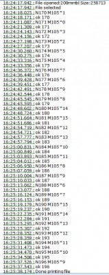

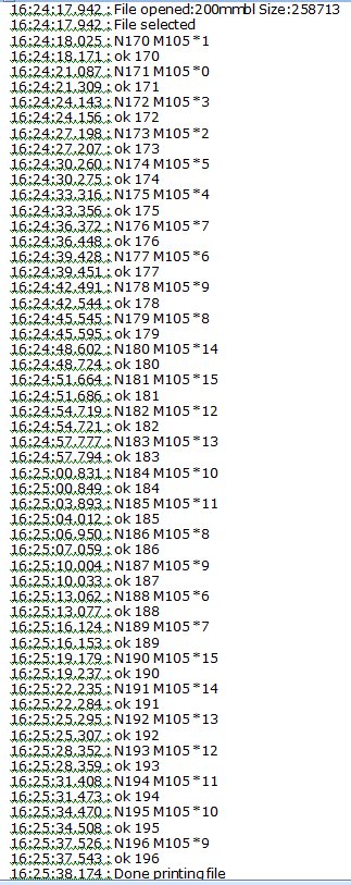

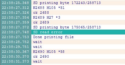

I've been printing from the SD Card to achieve best quality prints and I've been getting SD Card Read errors:
and prints are terminating early before they are completed:
Any ideas on how to remedy these printing issues that arise when I print from the SD Card?

I found my errors to be related to the length of the ribbon cables and or their routing through the machine. You really want to keep them away from AC lines of course and tucked as neatly away from the steppers as well. I know I know, we are a bit cramped for space and all.
Oh, lastly what also helped was to put some noise chockes on each of the ribbons. You know the ferrit (sp?) bead dealios.

I think we should also explore the possibilities that you have incorrectly configured your firmware. If you have made changes to it that is.
**Another thought I came up with here is perhaps your SD card is faulty, worn out, defective in certain memory locations. Before doing any of the above suggestions, let's eliminate this as a factor. Try printing from an entirely different SD card and see if the problems persist, ok?

The biggest source of noise is the stepper motors (relatively high current high frequency) and the ferrites will do just fine to attenuate those signals. They add inductance to the wire which resist high frequency changes of current, and is small enough to not negatively affect the signals to/from the LCD. Shielding protects from a wider range of signals (not that those problem signals even exist...) and just happened to be quicker with what I had on hand (with zero forethought).
I attached my the ground wire of my shielding to the ground of the power supply at the easily accessible power switch, that and whatever signal/digital ground the Rambo has is derived from that ground anyways. It wasn't my first choice though since I didn't have any equipment to see how much noise was on it, but that's where I stopped at least. I initially tried a pin of one of the LCD cables, I just assumed it was ground after doing checks with the multimeter and did no further checking (or thought). That failed, it caused serial restarts of the Rambo as long as the Rambo had power
(Hey look! A lesson!.....Wait where'd it go?). It's hard to tell if you clear up a sporadic problem completely by waiting for it to happen again. All I can say for now is that it hasn't made things worse.

Mission accomplished w/ the ferrite cores. Prints run from beginning to end now without interruption.
Thanks guys for hammering home the point about the ferrite cores eliminating print-stopping noise in the SD Card Ribbon Cables.
I bought 4 ea of these because you have to buy 2 ea to make a complete ferrite clamp set consisting of two halves and two clips:
http://www.digikey.com/product-detail/e ... -ND/242774
The ribbon cables fit just right so they are snug but can still slide in the slot.
1 set (2 ea halves) cost all of $2.06. The shipping cost more than the parts.
They are so darn cheap and eliminate such a major potential problem I think they s/ be a stock item in the RMAX kits.
