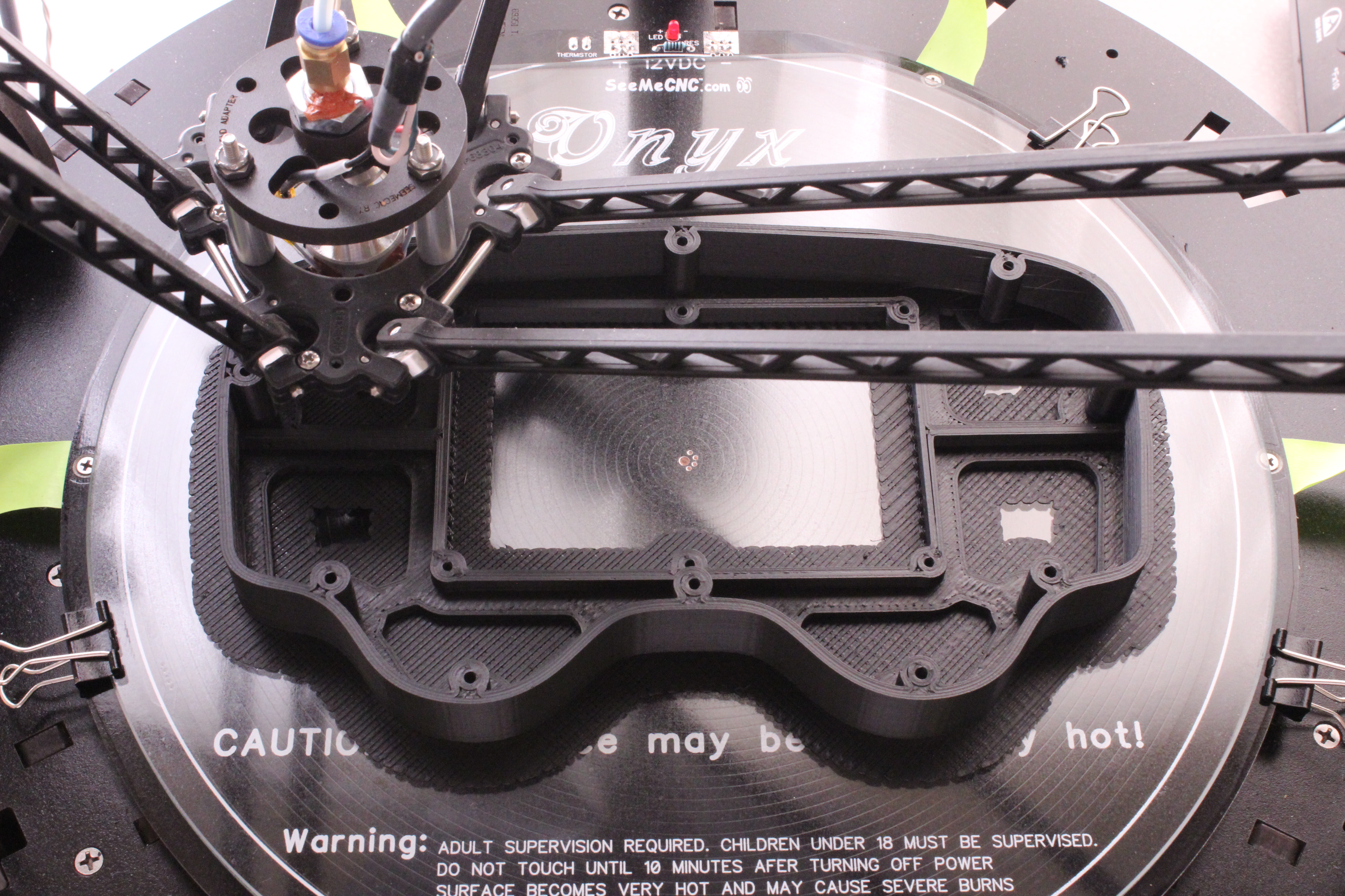

I have continued to do a number of very large and "flat" prints similar to the one included in this earlier thread (http://forum.seemecnc.com/viewtopic.php ... 9947#p9947). I thought I would share (repeat?) some of the things I am doing that help prevent warping when printing with ABS. (By "warping" I'm referring to corners of the print curling up and away from the print bed.)
First, when doing these big prints I am using a .70 mm nozzle. These prints take a long time, and they will just take too, too long if you use a smaller nozzle.
Second, if you have large thick horizontal "flats" to print the infill needs to be kept to 25% or less. The "skin" needs to be kept to .6mm or less. The horizontal top of the print in the earlier thread is 3mm thick. If the infill is set to more than 25%, or if the "skin" is set to thicker than .6mm, the "pull" that the cooling ABS will create will "pop" the outside corners up (and boy does it "pop" when it comes loose). "Skin" thickness and infill density seem to be two of the more important settings in avoiding "warp."

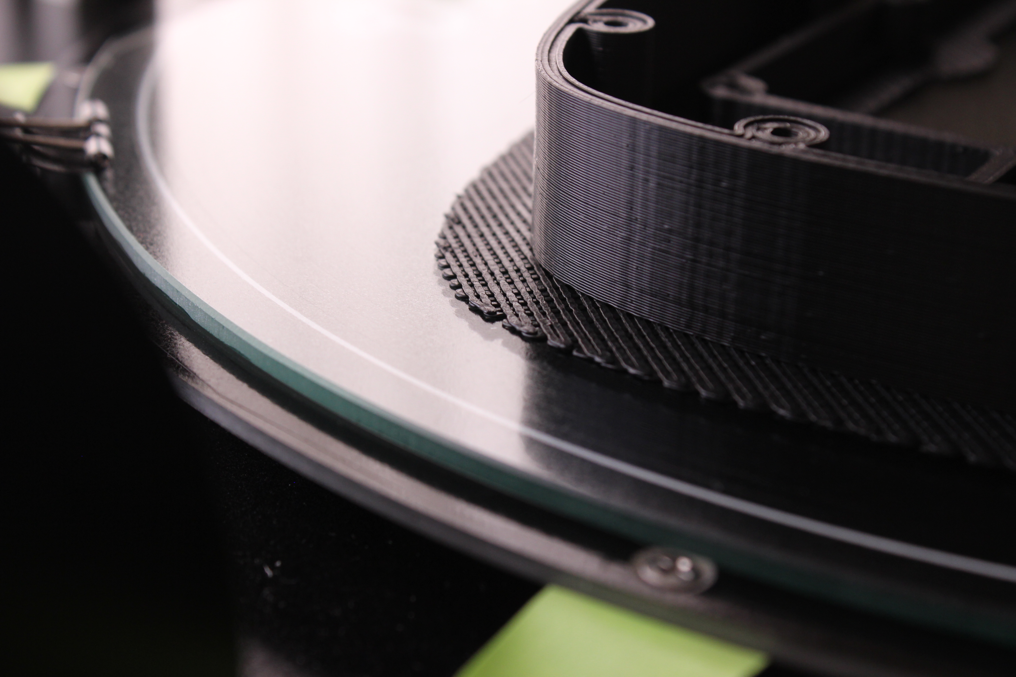

Third, adding "mouse ears" to outside corners seems to limit the tendency for a print to warp (see the photo in the earlier thread - you'll recognize what I mean by "mouse ears"). I have also found that a "raft," extending outside of the design by 7 or 8 mm also helps to prevent warping (when done in conjunction with these other recommendations). A raft alone will not prevent warping; you have to do all of these things together.
I continue to use KISSlicer (V1.1.1.10). When printing with black 1.75mm ABS (ordered from SeeMeCNC) I set the first layer temperature to 240 degrees; subsequent layers are printed at 235 degrees. I set my bed temperature to 80 degrees and leave it there. I am using a eighth-inch thick piece of non-tempered glass as a build surface. I spray it liberally with a cheap hair spray as the bed is heating. I thoroughly wash the glass in the kitchen sink after doing each large print. I set my bed "roughness" to .07 mm in KISSlicer.

Printing On The Whole Bed - Verse 2
