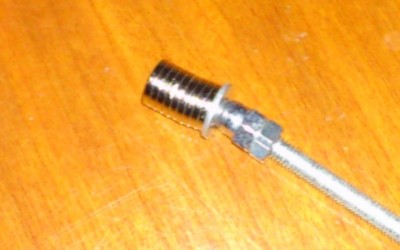

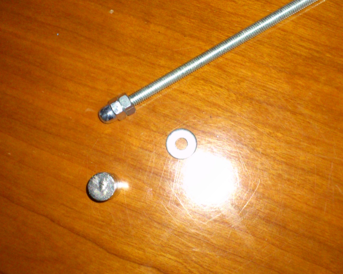

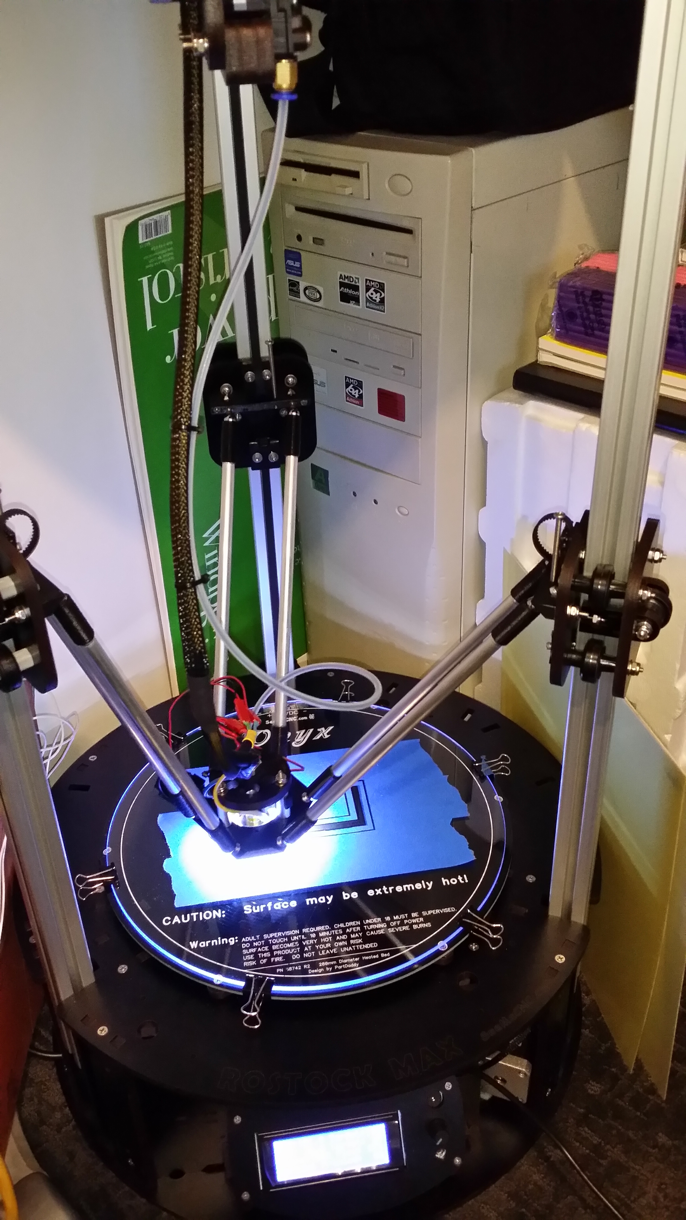

Postby Tinyhead » Wed Apr 09, 2014 1:36 am

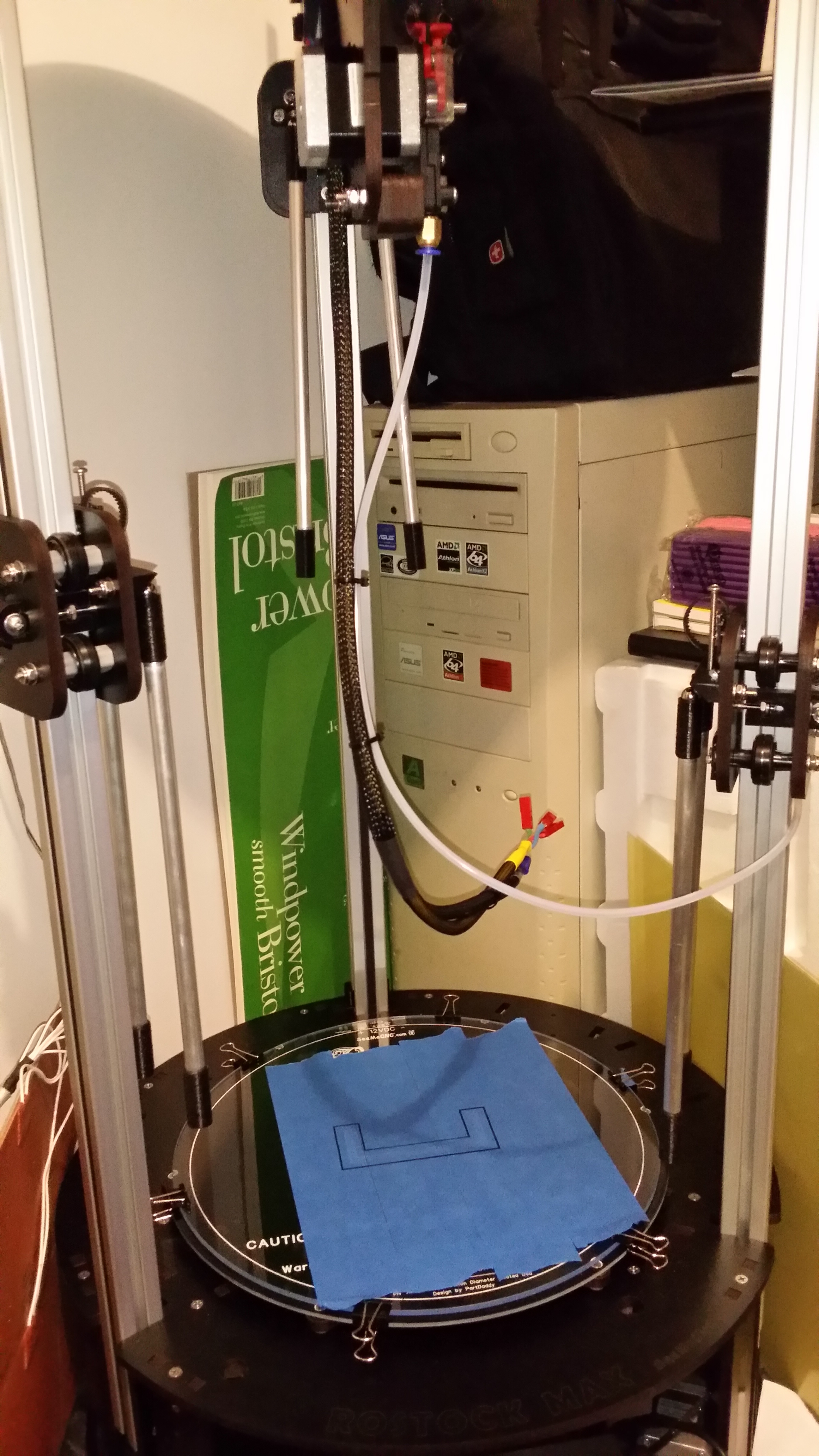

Well I took the plunge.
Removed my stock arms and assemblies... and I'm kinda glad I did. A few of the arms were very stiff. I'm surprised I wasn't seeing errors in my prints. One of the u-joints was almost seized in place, and yes, they were all lubed. Either way, it needed some TLC. I only have about 10 days of print time on the machine, so that's some pretty quick wear. With all the other people with joints seizing up though, it shouldn't be much of a surprise.
Arms and cheapskate holders in place
Installed the new effector... man that's nice and easy. Just snap into place and BAM! Done. I made a second effector for the E3D, but haven't assembled it yet. I'd like to make another effector with a dial indicator for easier future calibration too. Being so easy, it's hard not to!
There was quite a difference in my delta_radius with the new arms and with the upgrade, I also lost about 18mm of Z height. I have to go back and read, but I'm not sure if that's typical, but I'm guessing it must be. Changed my effector spec in the configuration.h as specified before the calibration and now I'm printing.
Up and printing!
I'm running off a 6hr print that I had completed earlier today with everything stock so I'll be able to see how it adds up. Exact same file with settings so it should be a direct comparison. I'll throw up pictures tomorrow after work. I'm hoping to see a quality difference, but I'm a bit scared there is going to be a scaling issue. I tried taking some callipers to it with the hot end whipping around and at first glance it seems like it's printing too big. 7.3mm instead of just 7mm kind of thing. I guess I'll be able to check for sure in the a.m. though.

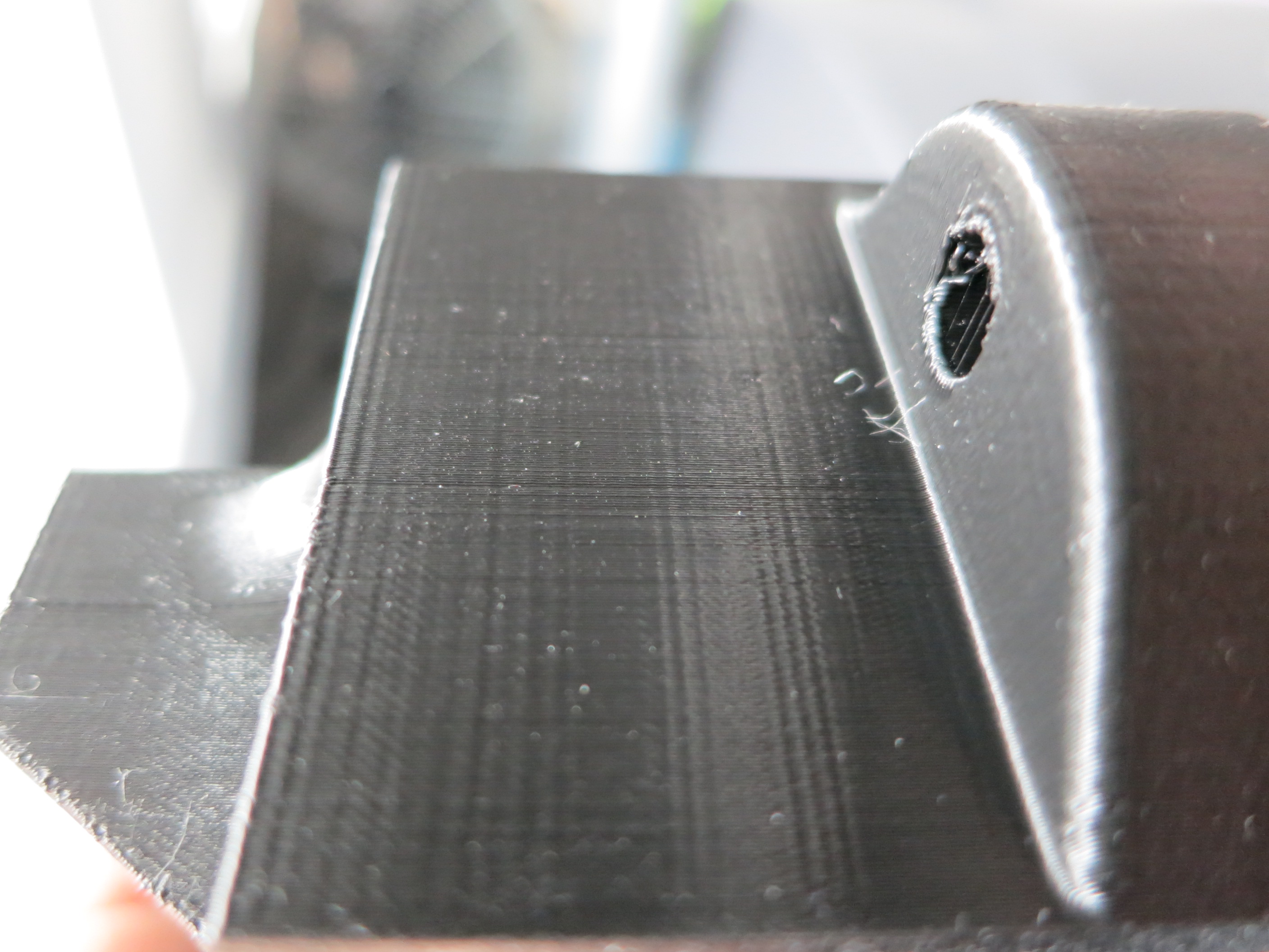

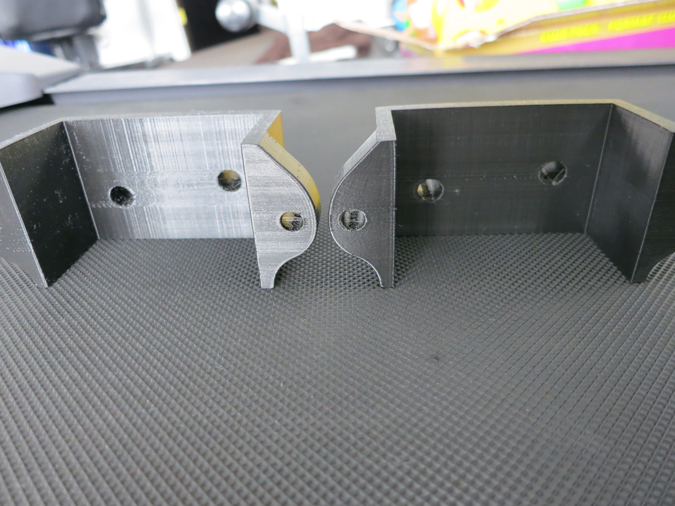

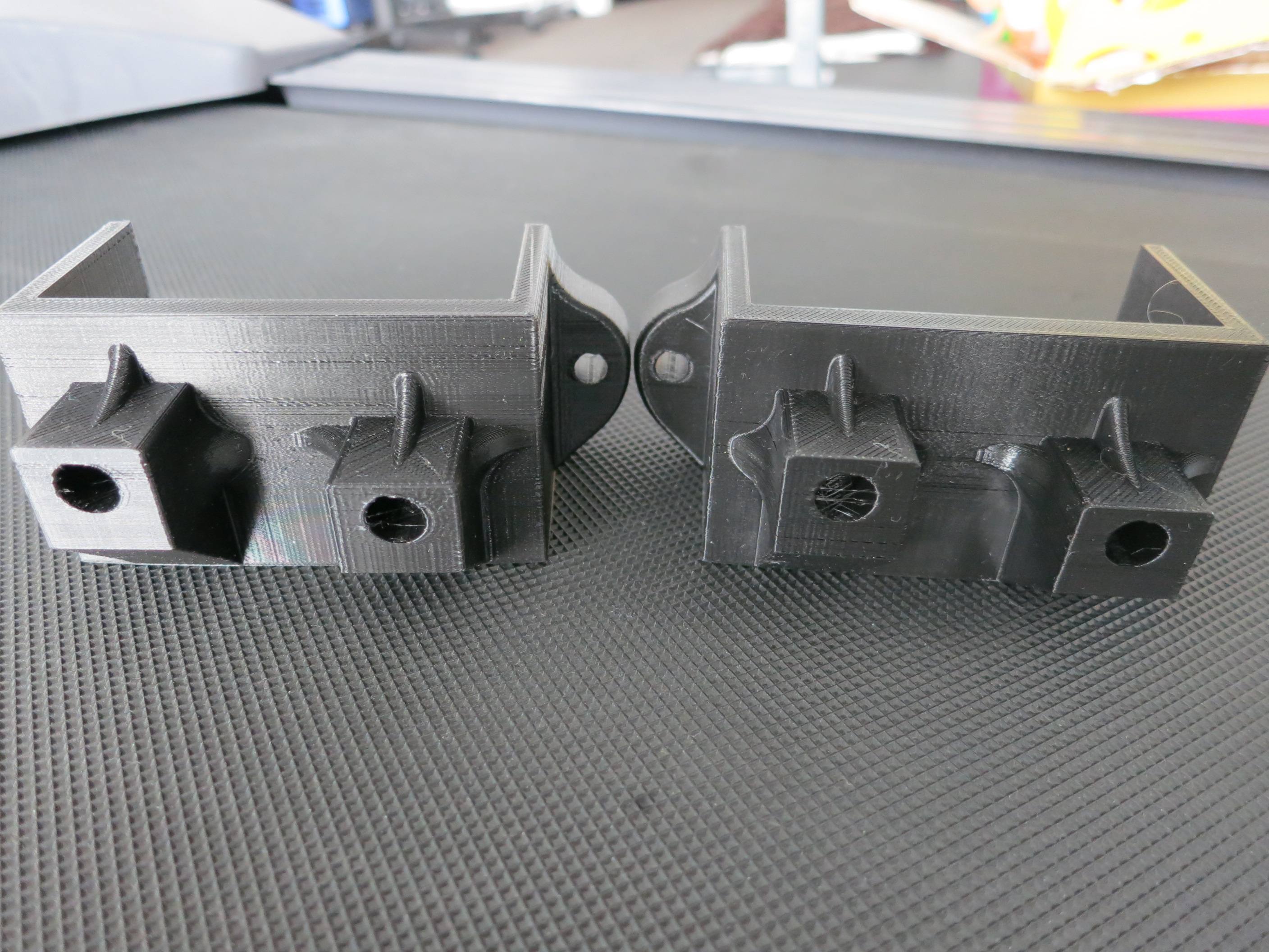

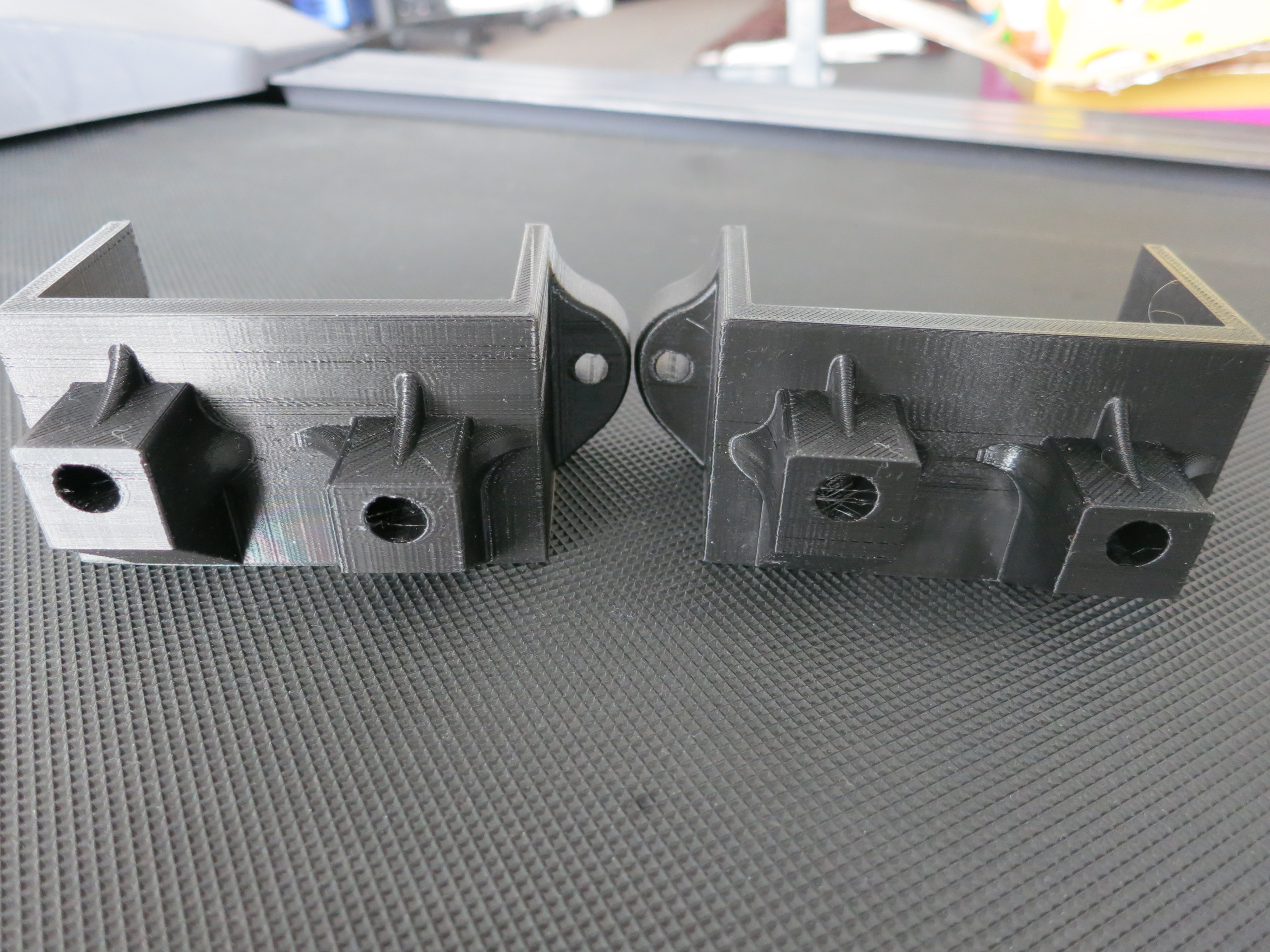

Well here are the pictures of my part result:
Left stock arms, right magnetic arms
Left stock, right magnetic - back side
Stock arms closeup
Magnetic arms closeup
There are a few horizontal 'artifacts' on both of the prints, which would make me think slicer/gcode error, but they're not always in the same place. Very close though. Must have been something to do with printing speed.
I was incorrect in the assumption that parts were going to be too big. They're within .02mm of my original part (and about 0.1mm or less out from actual part design).
Flat walls are very slightly smoother with the mag arms than the stock arms. It's hardly noticeable. I guess it goes to show how well the redesigned stock arms really are. If there is one appreciable benefit to the upgrade, it's ease of assembly/disassembly and changing out hot ends, little to no maintenance and you don't have to worry about any u-joints jamming up.
In the end, I'm still quite glad I did the upgrade (especially after finding those failing u-joints). It's been on my list since the beginning and now I can tick it off.
EDIT: After about 10hrs of printing... I lost my first ball. Effector fell down into the print. Luckily I was there and it was only about 20 minutes into the print. I can grab the galls with pliers to tighten the nuts and I thought that would be a good test. They held nice and strong. Toss a little bit of heat on them though, and they pop right off. I'm definitely going to tack weld a few sets of balls.

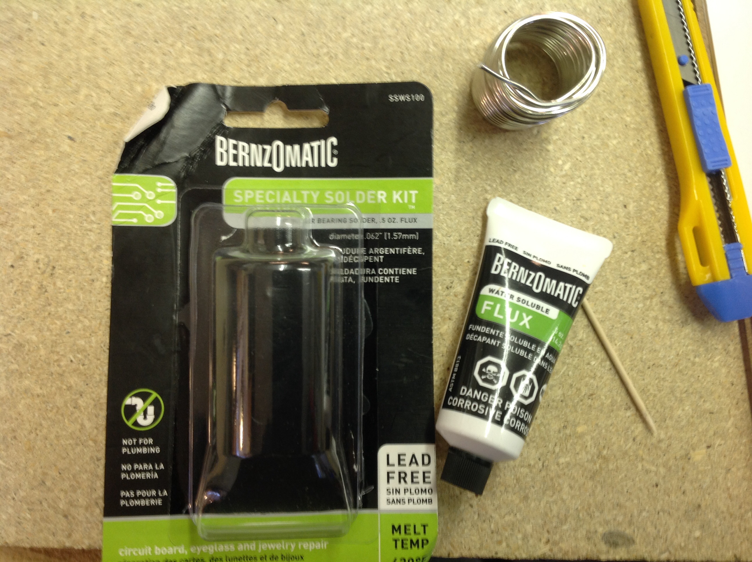

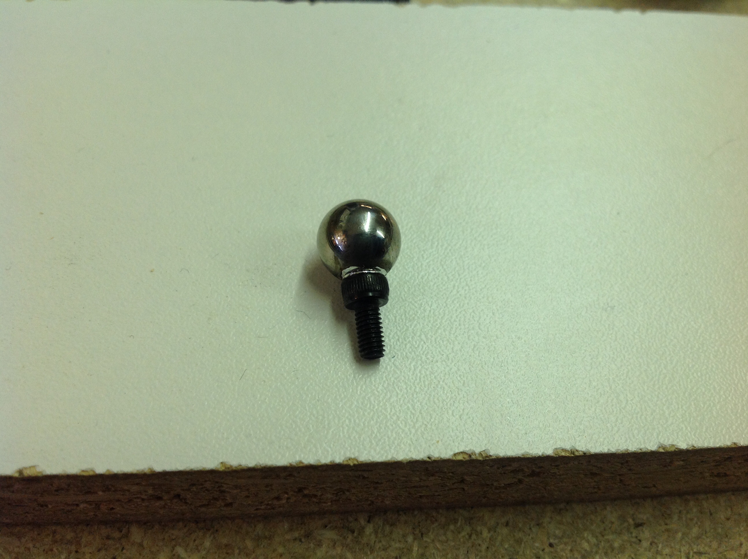

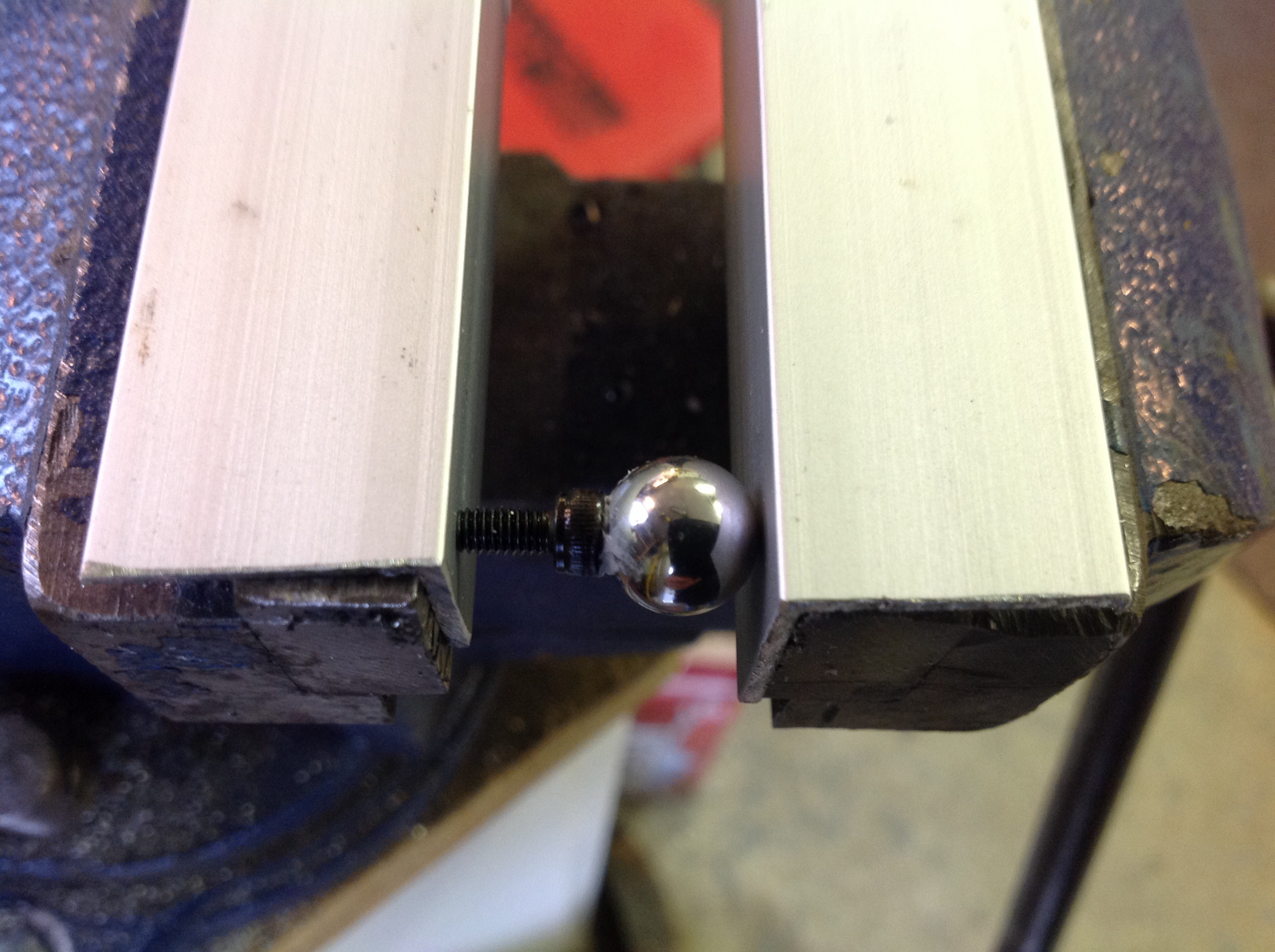

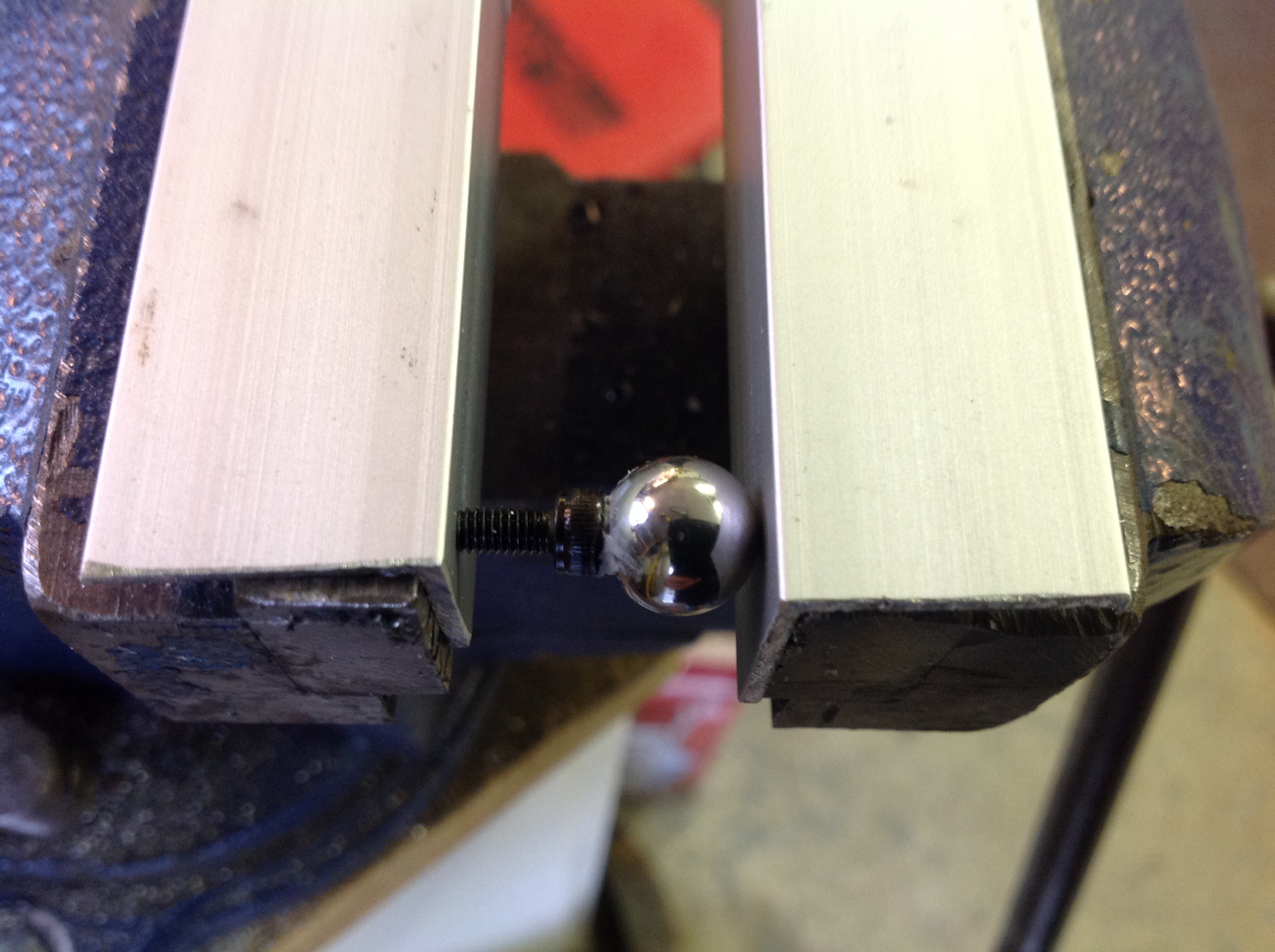

Hello all,
This is my first post to the forum, just finished assembling my first 3d printer (Max v2). I have already started on making my own set of magnetic arms, thank you xnaron for the stl files for the parts.
I have been thinking of another way of attaching the balls to the cap screws other than the JB weld. Thought of everything from tack welding with the MIG, brazing, friction welding. I ended up soldering them using a specialty kit from bernzomatic that I had kicking around in the shop. I sanded the top of the cap screw to remove the coating and expose the bare metal. I then cut a small bit of the solder off and placed it in the Allan wrench recess. Then I coated the top of the cap screw with the supplied flux, adding a little blob in the center to hold the little clipping of solder in. The ball was sanded where it would contact the cap screw and flux was applied to that area. I then pushed the cap screw against the ball in a aluminum faced vice to prevent damage. I took my MAAP gas torch to the assembly and heated until the solder flowed out around the mating point of the ball and screw. Heat was removed and allowed to cool ( leaving in the aluminum faced vice cooled faster than if removed, even after 5 min the first assembly I made that I removed right away was to hot to handle. But if left in the vice, cool to the touch in a min, the joys of heat sinks.
I tested one of the assembly's by clamping the screw in the vice and hitting with hammer, took 3 wacks to break the bond.
So with these done off to make the rest of the parts

That was a great idea and has to be a lot stronger than just the epoxy. I would have thought the solder would have to be hand fed around the ball while heating but you have proved that the solder would flow out from the center
to the outside of the ball. Brilliant! Thinking outside the box proved that there are many ways to do things. Thanks for this post!

RichardMac wrote:Hello all,
Thanks for posting this! I have another set to make up soon and will try this method. One thing you need to be careful of is that you don't scratch the ball on the surface the PLA cups will traverse. This will cause increased friction and wear. I see you used the aluminum to protect it in the vice...that was good. I will see if I can find some of that benzomatic flux. What kind of solder did you use or did it come with the flux?

Postby RichardMac » Sun Apr 27, 2014 7:56 pm
The solder will naturally flow to the mating edges due to capaliray action, same as sweating copper pipe.
The solder comes with the flux, the solder is the magic. Flux is flux for the most part, but what makes up the solder is the important part. I think this one has a higher content of silver than other solders.
Double check each one after they cools. I was threading on in to the effector and the ball popped off the cap screw. Must have not gotten it up to full temp. You want to heat it up just until the solder flows into the mating surfaces. But don't heat up to the point that the chrome starts to debond from the steel
Richard

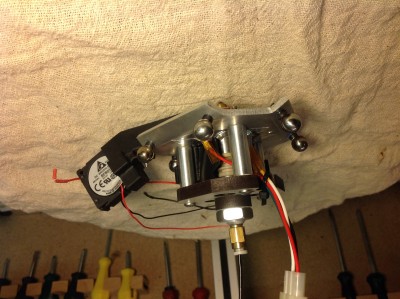

Postby RichardMac » Thu May 08, 2014 10:37 pm
Here is my effector plate with the soldered balls to the cap screws. Have done a few prints and all looks good so far.

RichardMac wrote:Here is my effector plate with the soldered balls to the cap screws. Have done a few prints and all looks good so far.
Very nice effector. Are you interested in making and selling these?

Postby RichardMac » Wed May 14, 2014 4:49 pm
The effector is a one off ( well actually 3 off but I broke my M3 tap threading the holes on the second one, waiting on a new tap).
I laid out the design on a sleet of 1/8" aluminum and cut by hand with a hack saw, then drill press for the holes, and made the bends using a bench vise and clamp.
The piece is a little rough on the finish, but gets the job done. if I had a quicker way of making the plates, I would consider it and figure the total cost of supply's . But at this time I would not be looking to sell the plates.
The fan set up is the same fans that came in the Kit for the max V2. same printed shrouds that were the first two items to be printed ( PEEK and layer ).
the aluminum plate basically replaces the stock effector, I used Xnaron's effector SLT design to make a flat design that would be bent. I added a small tab where the layer fan shroud would attach, same as the stock item.
