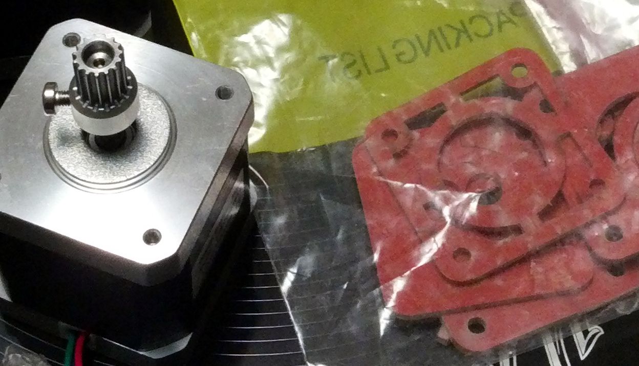

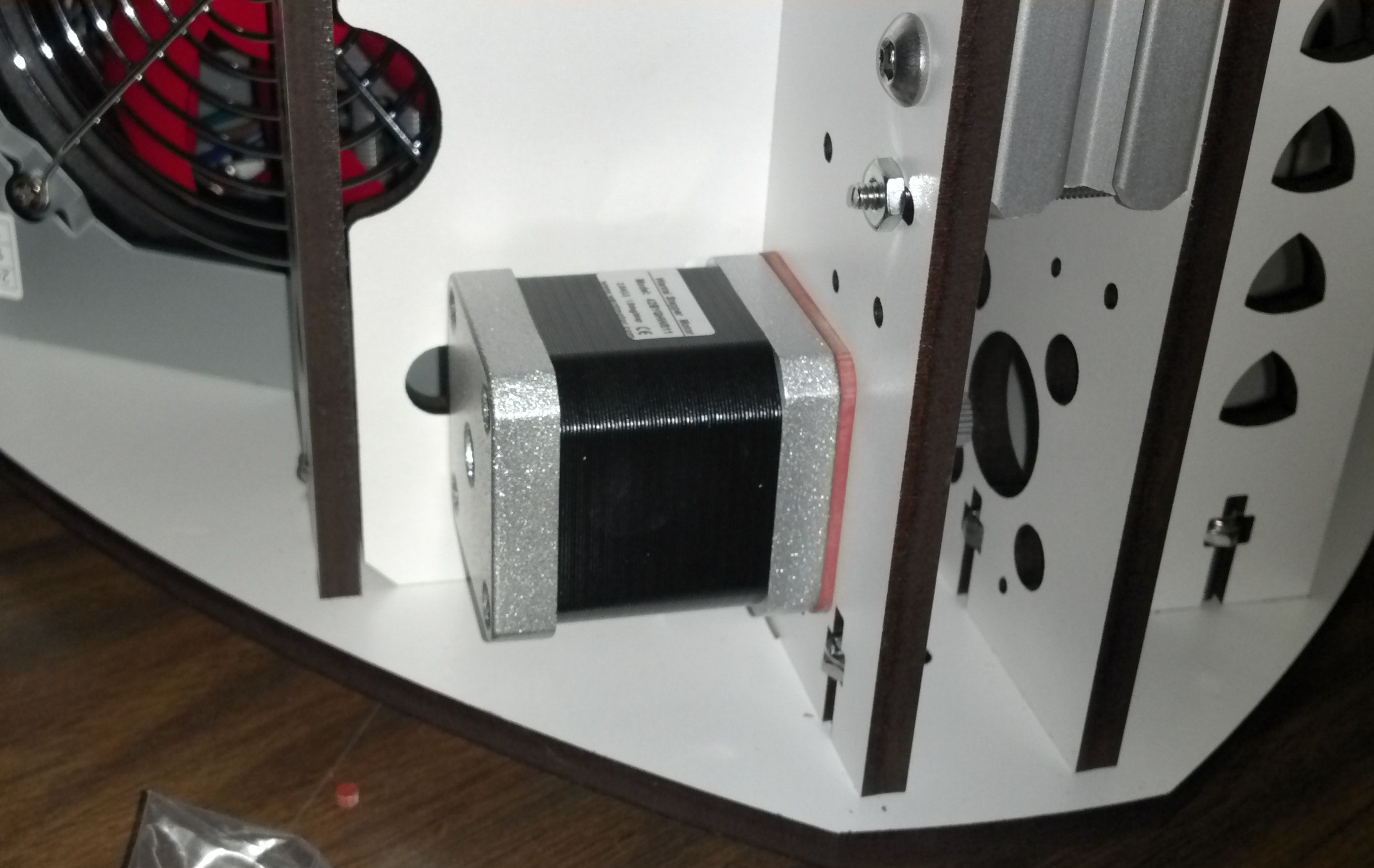

Awhile back I laser cut some 2mm thick rubber motor washers but have not tried them yet.

Hi Brian! What do you have under the heads of the screws, which mount the stepper?

either rubber washers I cut from same rubber with a steel washer under screw head, or nothing ... not sure.aehM_Key wrote:Hi Brian! What do you have under the heads of the screws, which mount the stepper?
rubber washer may let motor move to much.
without may still transmit some of the stepper noise to frame.
have not had time to try it.

hey Eaglezsoar, if you have time fairly soon to test them out and post your results I would mail them to you at no cost.
I just don't have the time anytime soon.
If they work I would sell them on my Rostock Accesories web site www.tricklaser.com
You will need longer screws, if I remember correctly the OEM ones are 3mm X 10mm. So you will need 12mm or 15mm if putting rubber washer under head of screw. Although the rubber washer under screw head will likely allow motor to move to much.
Email your address to me at [email protected] if you are interested.
I would like to know before MRRF March 15-17 so I can cut some and bring along.
